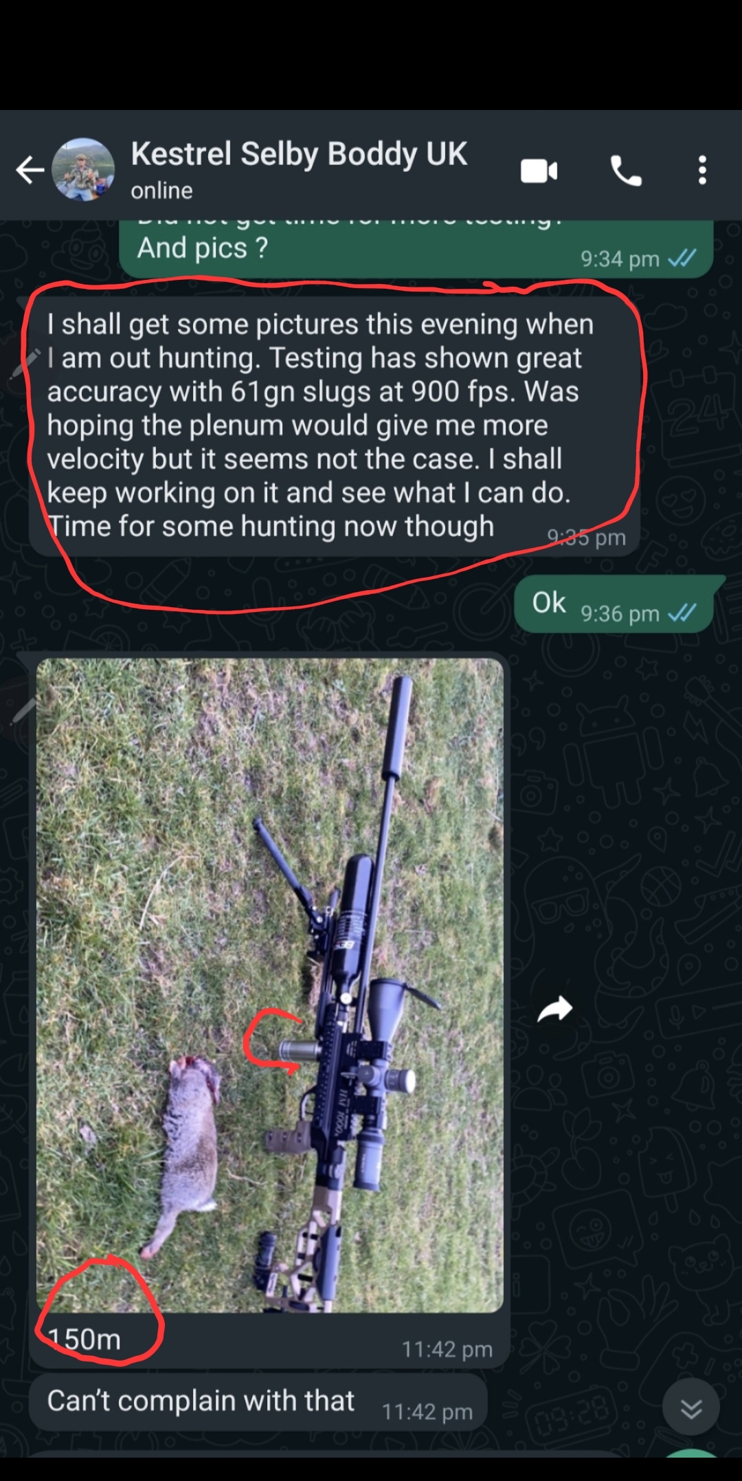

You definitely are dedicated to getting the perfect slug tune, kudos to you! These RAW's are certainly one of the finest tune it and shoot it guns once tuned, but, getting there is work. I have one in .22 that, like you, wanted to be able to shoot pellets and slugs but, I wanted it on just one tune. Good luck and keep us updated on your progress! Also, FYI Bhaur here, fabricates inline and drop down plenums for RAW guns.

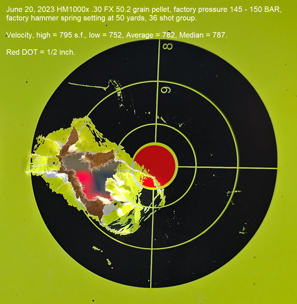

Day 2 shooting 36 shot group, no adjustment to factory tune. This was a fairly fast shot group.

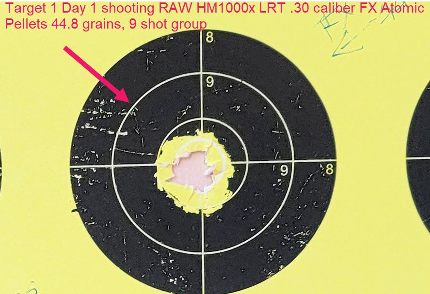

Here is my Day 1 target after unboxing my .30 caliber RAW HM1000x shooting a 9 shot group off a rest at 50 yards. No tune or adjustment whatsoever. My goal is to find additional precision with pellets and to see if I can find a slug to shoot well in .30 caliber.
1/2” at 50y outside is what most RAW users can expect with low wind. Agree with several, and my RAW HM1000x .22 is not well suited for slugs either. I tried slugs at 50 and 100 yards, and it was not as accurate as the JSB 25g redesigns. Not even close. When I had the .30 barrel, the 44g was solid at 50y and pretty good at 100y.
BK, I don’t think you are going to beat your accuracy at 50y with slugs. Don’t let that stop you from trying, and post any results with slugs.
In .22 cal and with little to no wind, I can achieve accuracy about on par with JSB Monster Redesign 25.4gr pellets at 50Y and 100Y using Altaros ATP Smooth 32.5gr slugs at 910fps. Not better, but roughly equivalent. That is the sweet spot velocity for those slugs. The slugs really shine when the wind blows 3-7mph; they don't drift much at all because they have a better BC than the pellets. The pellets are all over the place unless I guess my wind holdoff correctly.
