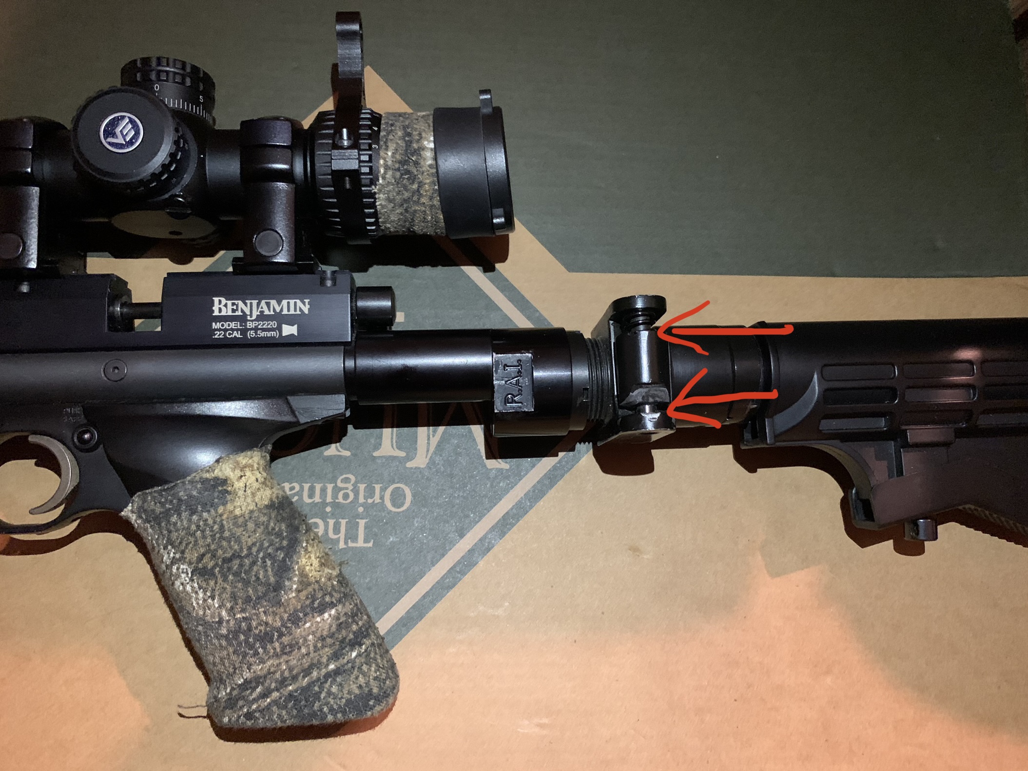

My issue is that it affects my hold. Here’s a photo of the gun I’m having an issue with.
Any suggestions on how to shim this stock to resolve or improve upon the issue?
Also note where the cocking handle is located. If I grip it firmly and establish decent cheek weld then I’m ok most times. It can take a moment to get comfortable taking a shot off of shooting sticks considering I’m focused on situating the sticks and my grip. It is annoying in the sense that it takes longer to setup for a shot. The flex has been there since I bought the gun. I guess taking a break from shooting this gun for a while caused me to pay more attention to this when I picked it up again.

@Privateer Up and down. An intentionally firm grip can keep it from flexing frequently. After putting it down and shooting other guns more, when I picked it back up I noticed it and it’s annoying.
Kind of sounds like the pivot pin is the problem. That should be the main anchor point for the stock.
I suspect to much play in that area. I'd bore the area where the pin goes and put a brass bushing in there and have a new pin made.
Open the stock to about 45 degrees from closed and see if there is play.
Reason I say do that is of there's no up down play like that? Then you have an oblonged hole.
Reactions: iAMzehTOASTY1
That I can't answer. You have the RAI stock adapter from your picture. Is the actual hinge part RAI or other brand?
Now I have had other brands that the hole the pivot pin fits into wears and ends up out of round.
I bore the holes and fit a bronze bushing to stop that wear on all new folders I buy.
For $30? I'd just replace it and expect it to also wear over time.
Most are aluminium with a steel pin. Guess what part goes bad first?
@Privateer Yes, there is some wear on the pivot area. The joint pictured in post #5 has to be compressed in order to unlock and fold the stock. That’s why there’s that spring around the pivot pin above the folding part that receives the pin creating a hinge (I’m not sure what to call the piece that the pin threads through). I don’t know how the wear occurred. I bought this gun used. I’m not even sure if the stock is more rigid when it’s new. It’s the same brand as the linked adapter.
