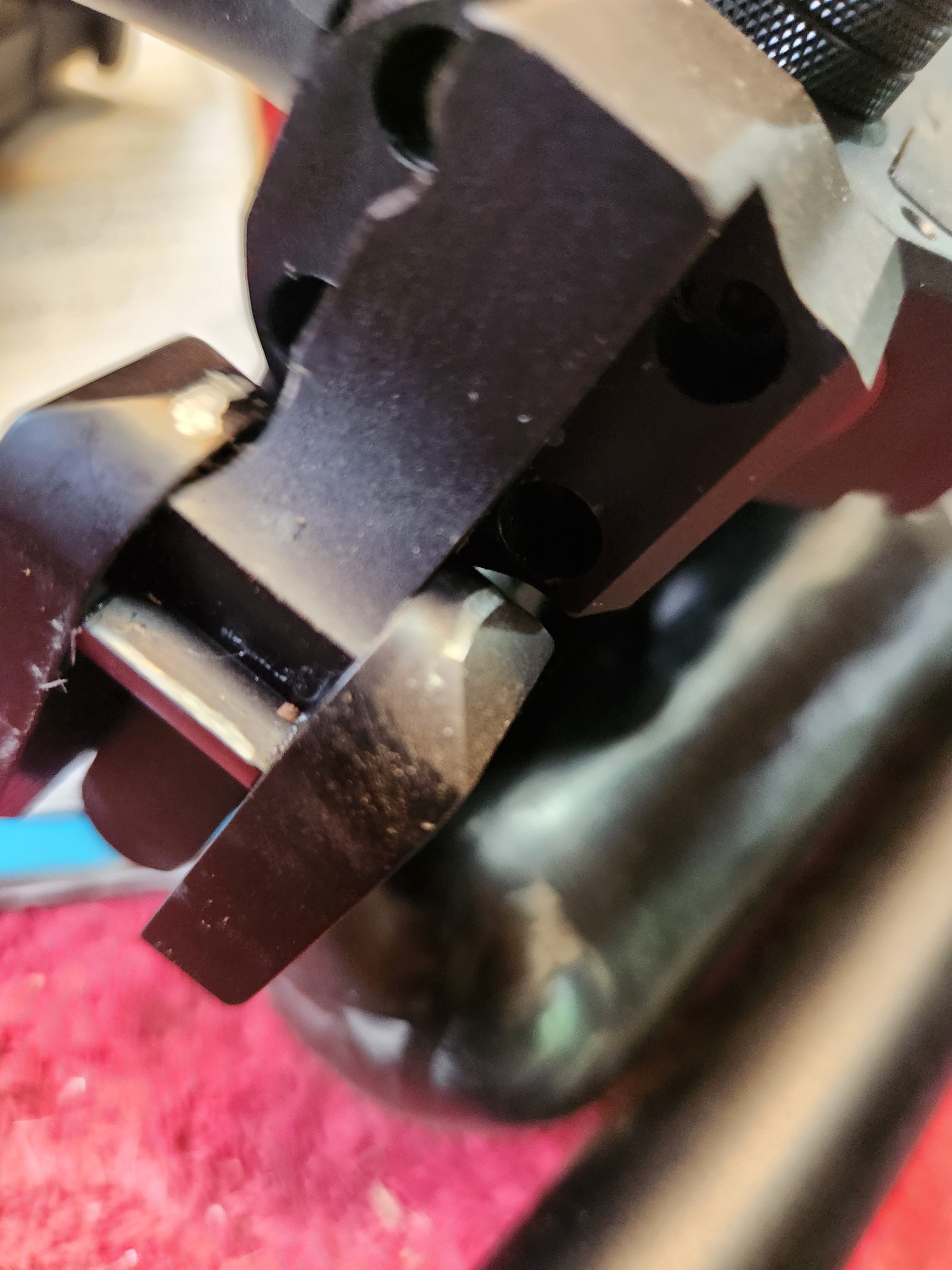

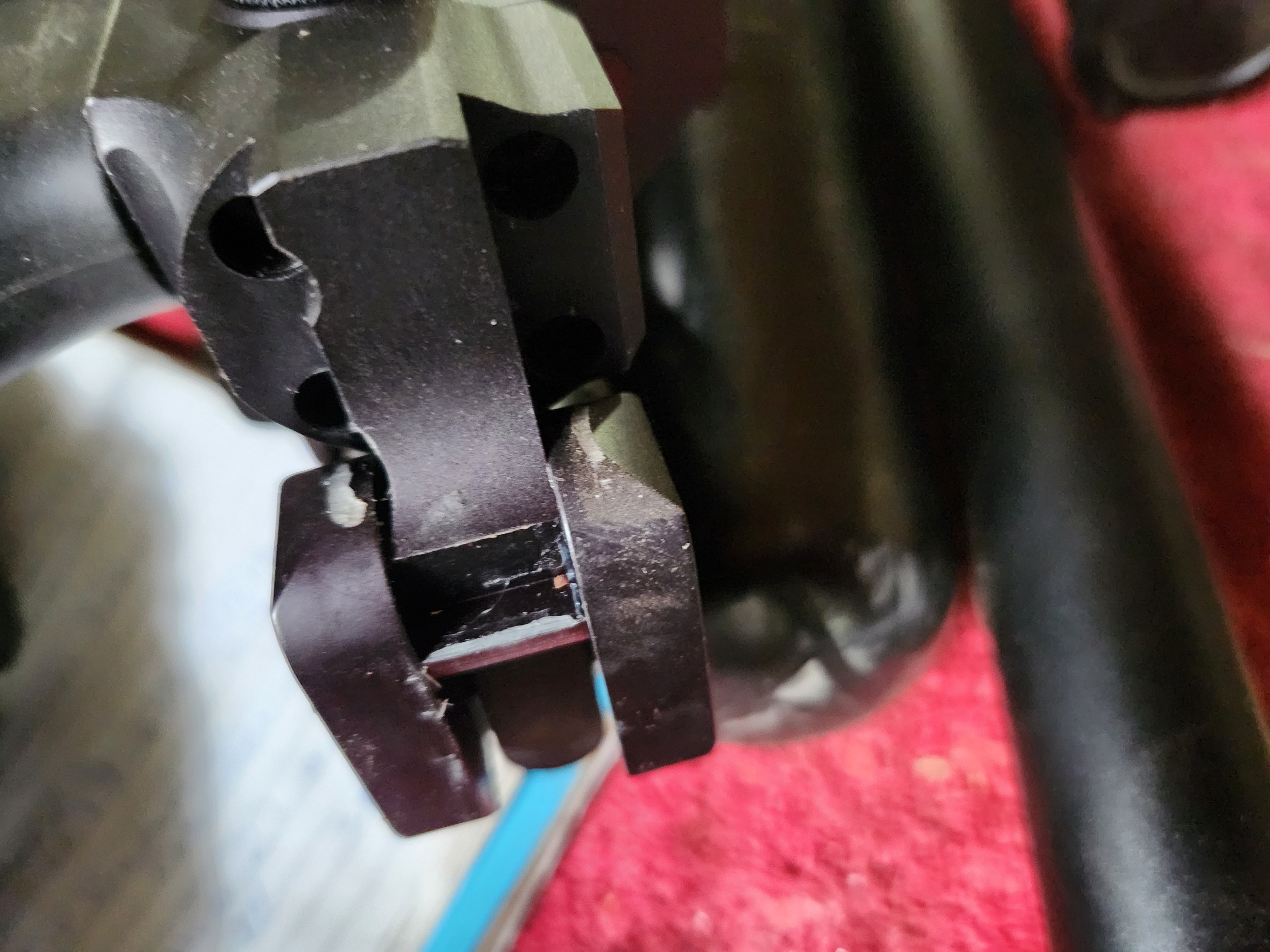

WARNING ⚠️ ⚠️. The screws that came with my folding stock adapter have a head diameter that is too big to clear the hinging portion. Result is gouging of the adapter. SOLUTION: Take the adapter apart BEFORE installing. Nothing goes flying, so easy to do. The video did not mention this, so maybe screws are now supplied with proper size. Bill and Addi
