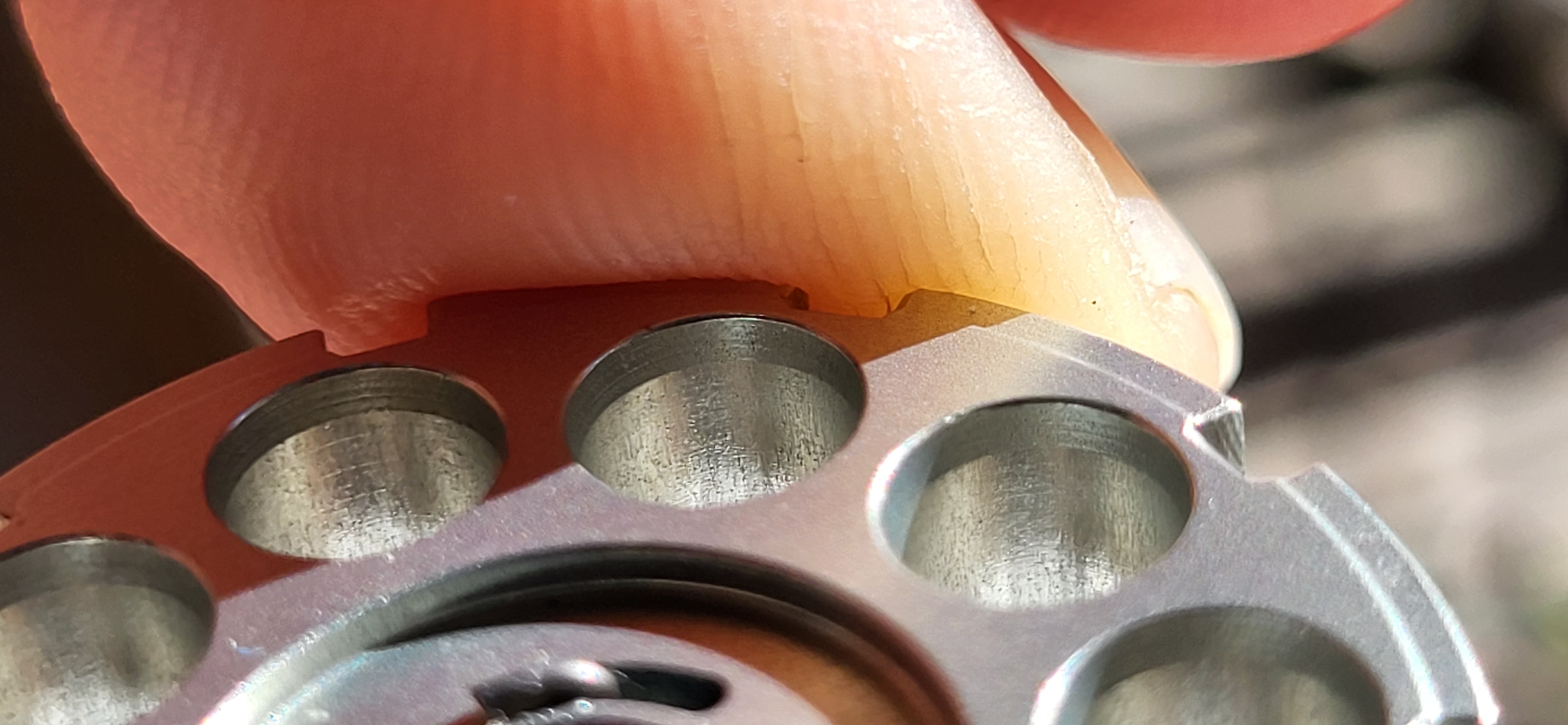

Check out the surface finish of the charging hole bores in this Styer Pro X mag...if a revolver cylinder bore was that rough cases would be locked in after firing...I have a feeling lead pellets don't like it either...they fit tight can't be good for consistency...but hey what can you expect from a 3k gun...lol.
