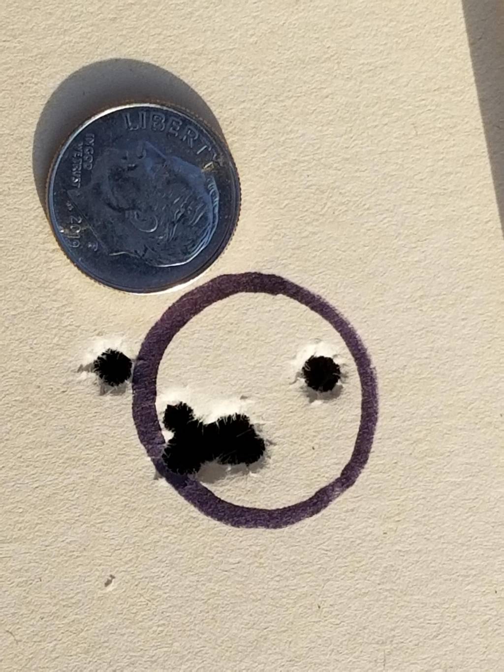

If I insert the liner without O-rings, and without the liner nut in place, hold the assembly vertically and look down from the muzzle end, it wants to come to rest off-center toward about 3:00 or so. Firearm barrels will shoot AWAY from a pressure point, so this makes sense to me. The bend point is about 1/3 the distance from the breech. One O-ring a few inches forward of the breech increases the displacement and still gives fliers. Add another one, or two, past the bend toward the muzzle, and the fliers persist. Increasing liner nut tension makes things worse. So I tried just one O-ring, about 6" back from the muzzle, with light liner nut tension. This AM at 0630 with no wind it is printing tight little 1/2" or smaller 5-shot groups, often with two or three touching, and usually with a "flier" toward 10:00 turning a 1/3" group into a 1/2" group.
I kept one O-ring because it's hard to maintain my liner index without it. I may try no rings at some point. Right now, the wind has returned so I'm done testing. 23 gr H&N .218 slugs, average velocity for 10 shots 925, ES 7, Sd 2.4

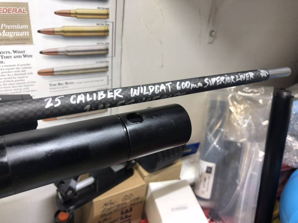

After you get your new outer barrel sleeve, may I suggest a carbon fiber sleeve epoxied onto your liner, and just get rid of those liner o rings. The CF sleeve will reinforce your liner, and assist in the accuracy dept. Just make sure you wipe down the liner with acetone first to remove all oils, and follow the Ernest Rowe procedure in epoxying the liner to the sleeve.
https://youtu.be/Lkwt0gVpzdI
the CF liners can be found here-
https://910airguntuningandrepairsllc.com/products/carbon-fiber-liner-sleeves-stx-liner-sleeves
A silver sharpie makes a great marker on these liner sleeves to note down caliber, liner type, barrel length, the gun it goes into, along with the twist rate. Just remember to check your twist rate before installing the CF sleeve, lol.
Heh. CF sleeve is how I got into this mess in the first place, because I think I bent the barrel sleeve trying to remove the shroud. Before I do that to my Superior liner, after the new barrel sleeve arrives I will try out the pellet liner that I sleeved with CF sleeve from 910 following the video from Ernest. If it shoots well, maybe I will consider sleeving the Superior.

Replacement barrel sleeve arrived yesterday. Installed it and indexed my liner to its usual position. Just now with no wind I found that POI at 70 yds had moved quite a bit, about 5" up and left. Interesting, because that is the diametrically opposite direction of the bend in the old sleeve, which makes sense. Groups are small and no fliers except the ones I make myself. I'm sure the harmonics are changed as well, so there may be room for further improvement.
O'Doyle, I did up a batch of 50 slugs washed and lightly lubed with Lemon Pledge, with no improvement. But that was with the old sleeve. I still have a bunch and will re-try them.
This is eight or nine shots at 70 yards. The 9:00 shot was first, with a little 5:00 wind, maybe 2 mph. I stopped and I fired 3 rounds which went into the left half of the central cluster. Then I dialed one click right. Then a 2-3 mph wind came up from 7:00 as I fired the fifth, hitting at 3:00, which is consistent with the known effects of wind on a slug. Then the wind dropped and the rest went into the right half of the central cluster.
This is the behavior I used to get before I attempted to "improve" my rifle. 23 grain H&N .218 slugs sorted by weight. These were all 23.4 gr. at about 920 fps.
