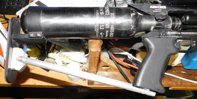

I have had very mixed results in regards of accuracy while shooting my Texan.
When i have a good day and are calm it shoots like a laser, when im skittish and cant repeat a correct hold it will scatter.
I know All Ya'll can get the Texan: https://www.airforceairguns.com/AirForce-Airguns-Thumbhole-Accessory-Bar-p/u1015.htm
But get it here and it will be made of gold :-(

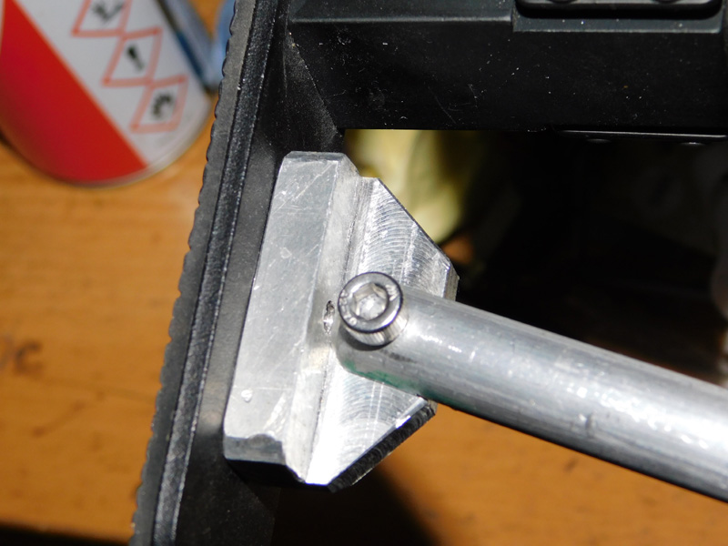

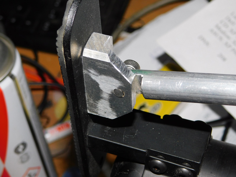

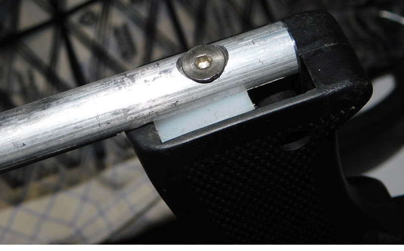

So i messed in the shop and a little time with an axe and i made this mockup/proof of concept.
Tuesday it will go to the range and hopefully proof my point that the Texan frame flexes badly under recoil.

Yeah sorry for dragging my heels.
That little bit of scaffolding halved my groups easy :)
Now i'm closer to 2MOA as you are. Before it was more like 4-5MOA.
Removed most all flex in the frame and really cut down on unexpected flyers.

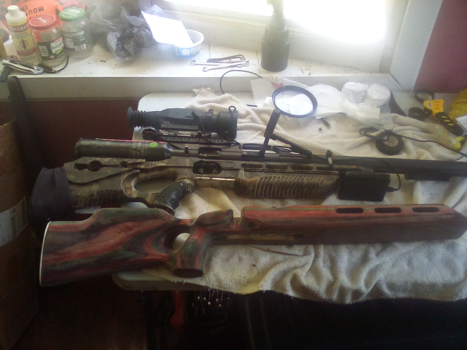

I have purchased a maddog stock to help with my flex
Reactions: RM.510bigbore
