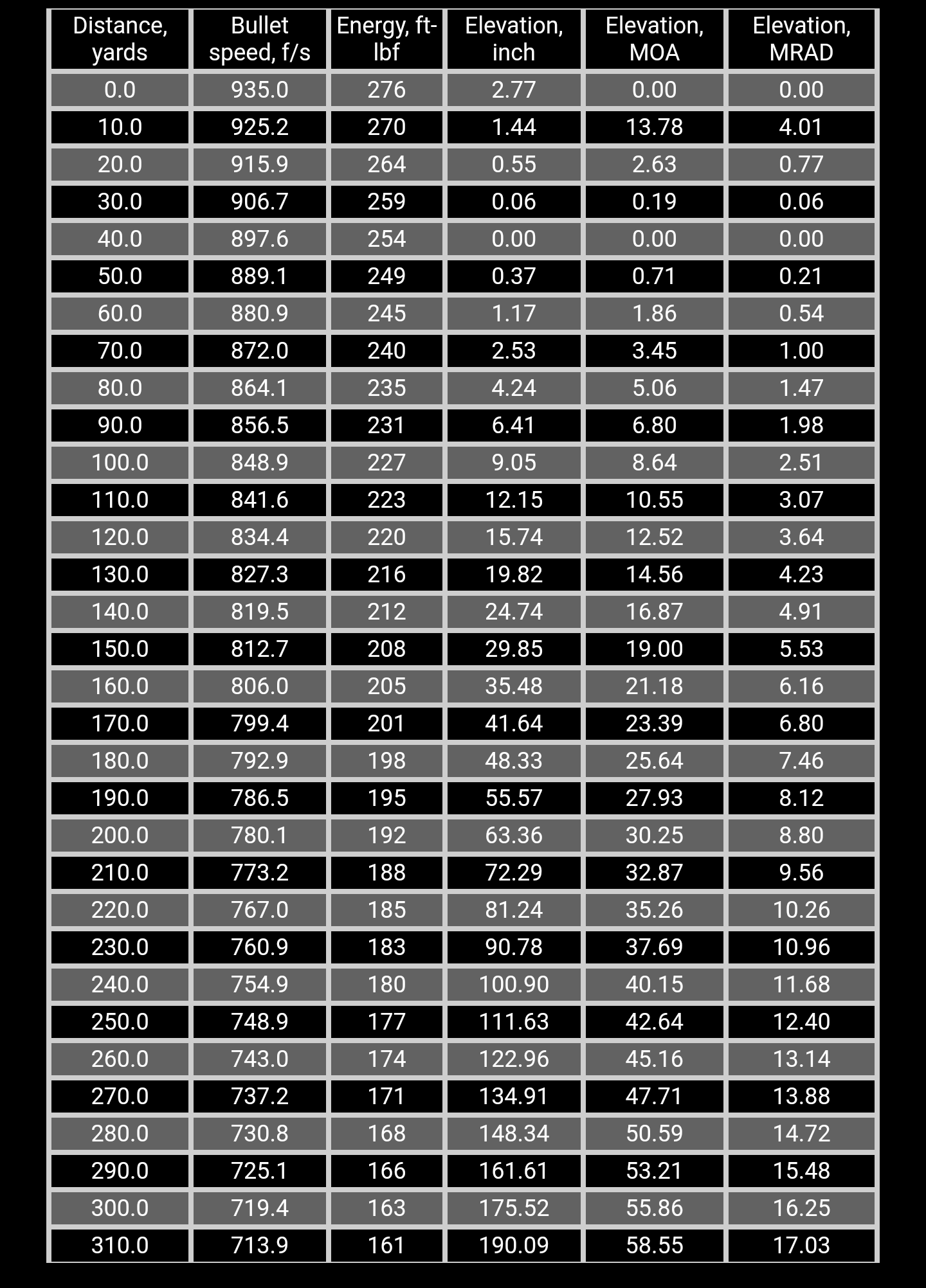

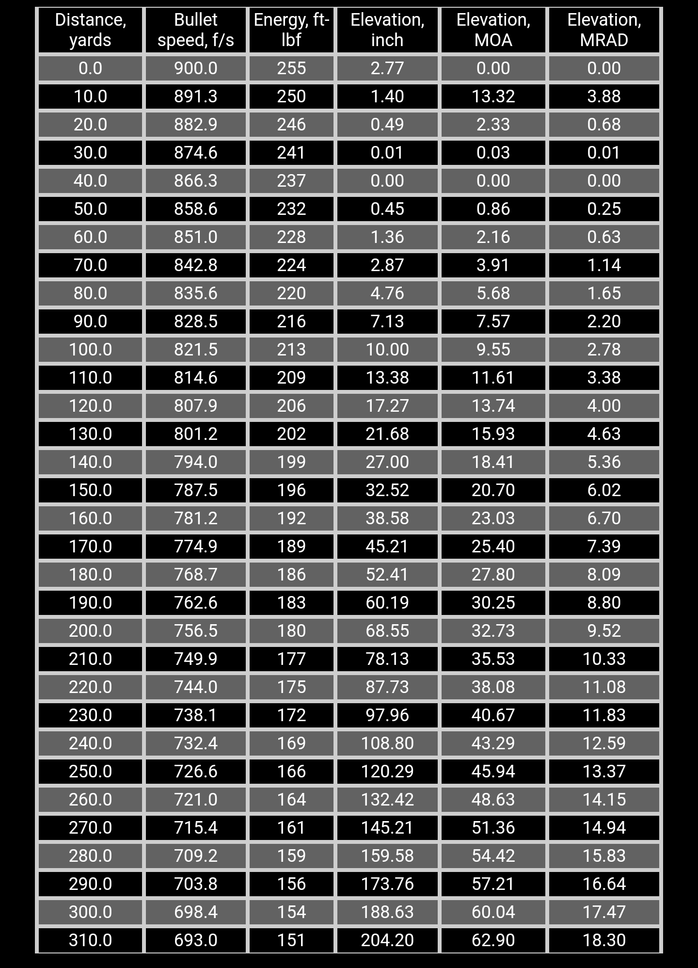

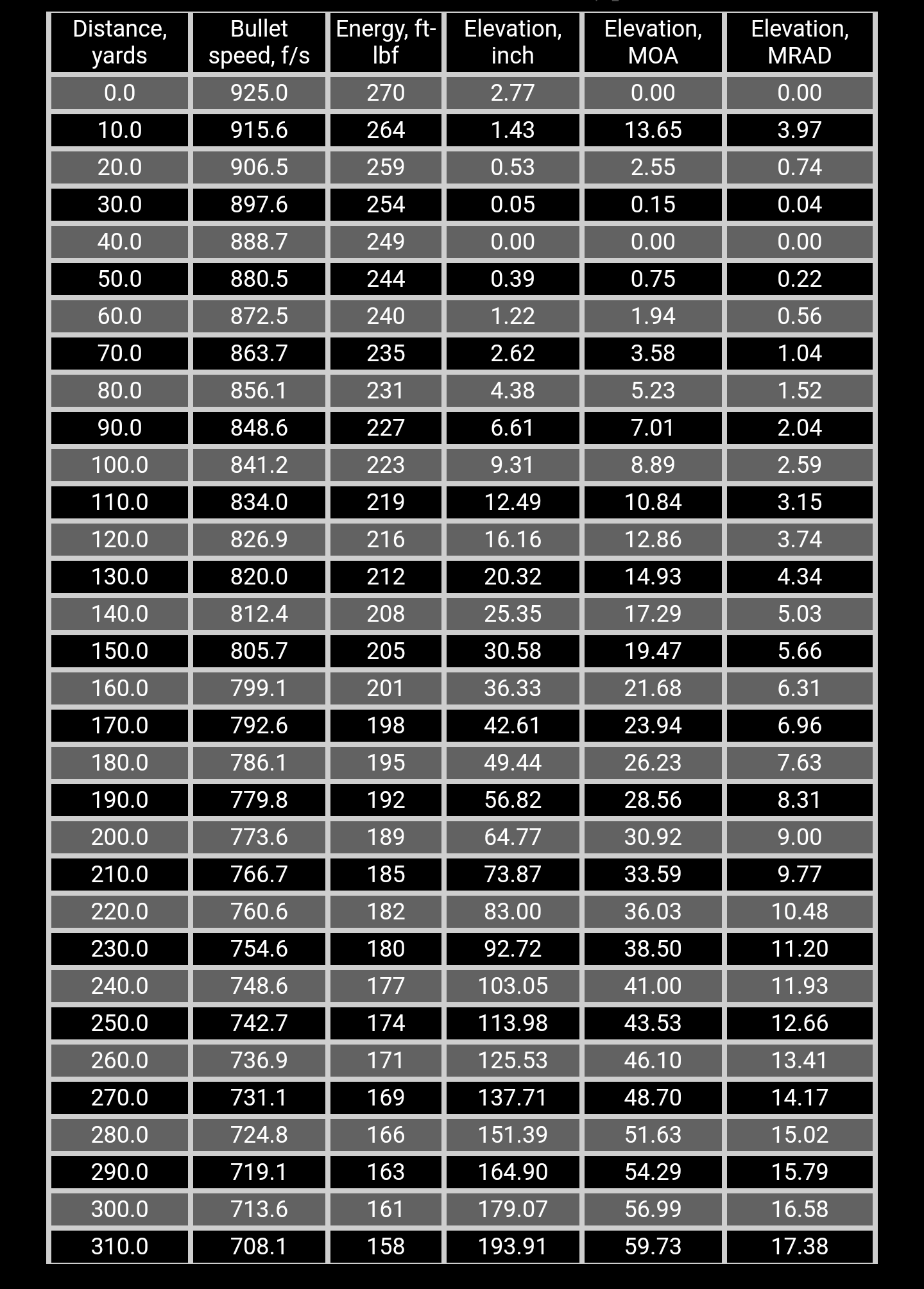

Here's a couple of ballistic charts from my Strelok Pro of a .357 Slayer with a 10 fps speed difference going between 935 fps to 925 fps over four shots, showing a 40 yard zero. The last chart is of the speed at 900 fps. I have the bc calculated between .162 and .165 in the app. The impact at longer ranges is significantly larger with a 25-35 fps speed difference, so knowing the gun and it's shot cycle can be critical to your group size.
