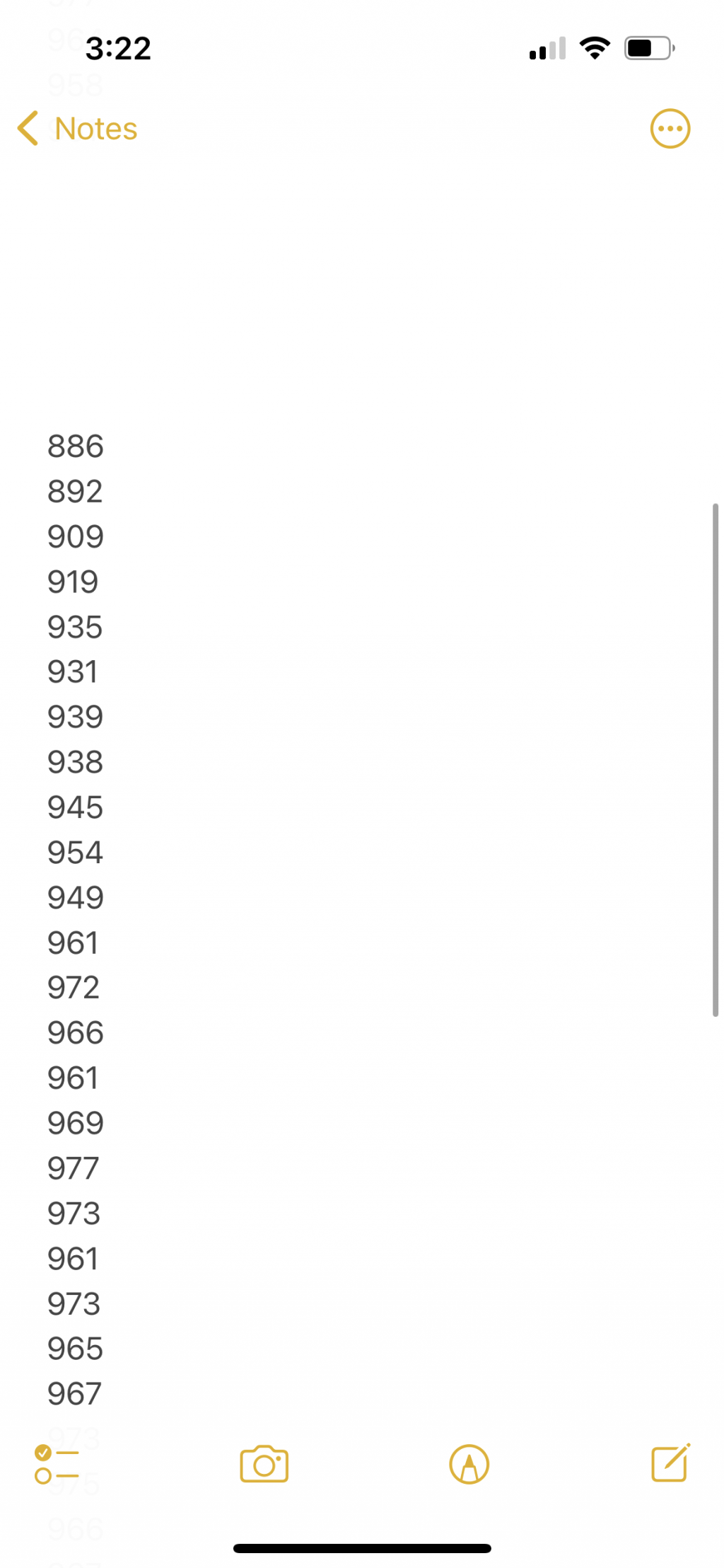

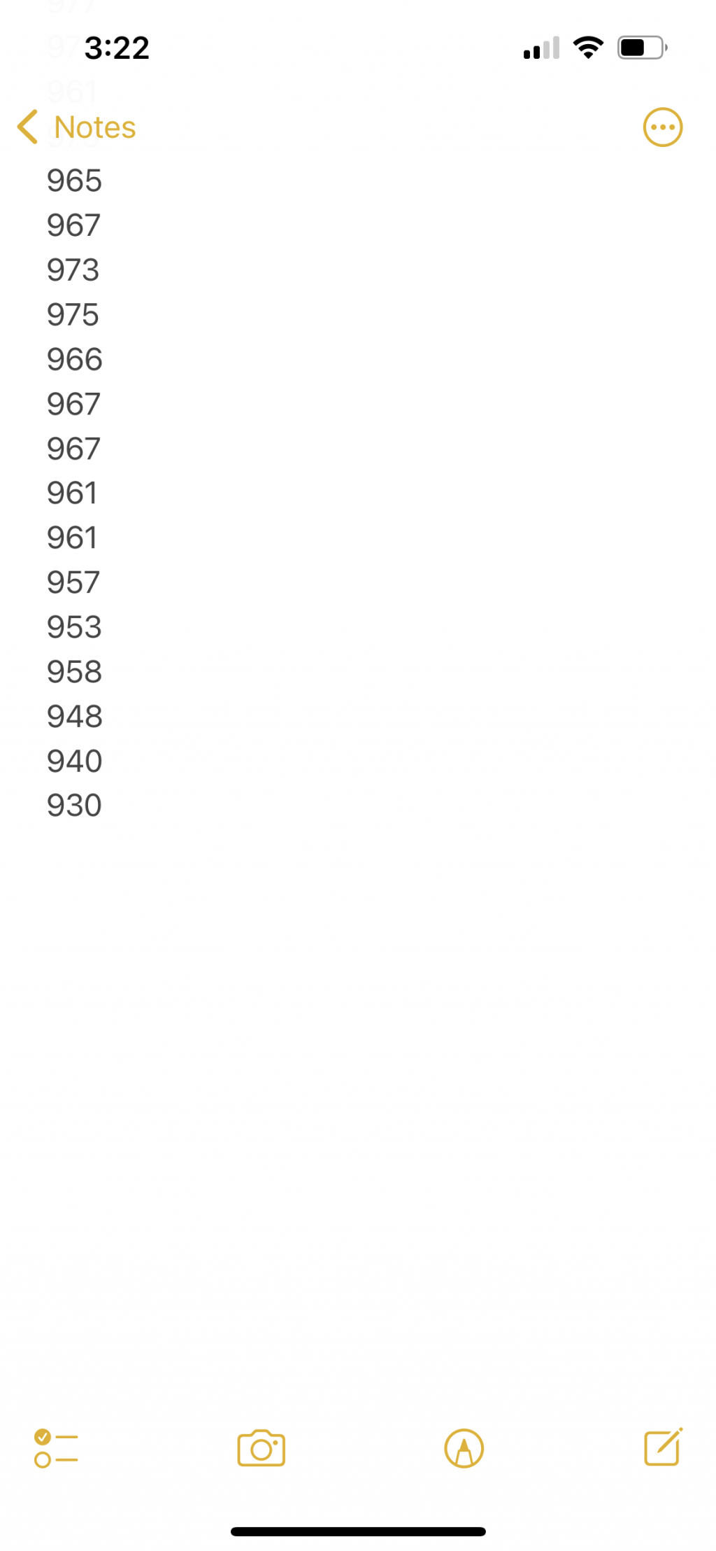

Does this string look about right have not put anything on paper yet. But minus the first couple shots what I got std wise was 2.9std out of the twenty some shots I used. Here is phots of the fps I record. Not sure if I want to back it off more.
I started at the 935fps shot
