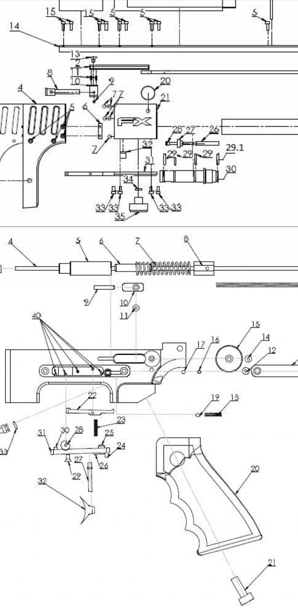

You most likely sheared #11 Allen screw

Adjusting the HST preload with tension on it (cocked) is strongly advised against. (Most likely not warranty if it's done against manufacturers instructions.

OP did you see sniperlabyo's response to your other thread? That slider is supposed to jiggle back and forth when not cocked as it's a free floating hammer/spring/HST slider. If its only doing it when not cocked there might be nothing wrong with it.

So you confirmed the slider jiggles side to side when cocked too? Or only when uncocked?
And yeah that's strange never heard of the pellets stacking like that.
Yeah, the slider not really jiggles but has some movement due to me rotating the power wheel while it was engaged.
I removed the wheel you suggested and saw scratches below the wheel from what I did this giving the slider some play when engaged.
I adjusted the screw on the sliders about a 1/4 turn and when cocked there isn’t any movement.
I’ll replace the mentioned screw very soon so that it can be at the 11mm factory specs measurements by a calipers as stated on the fix impact booklet.
