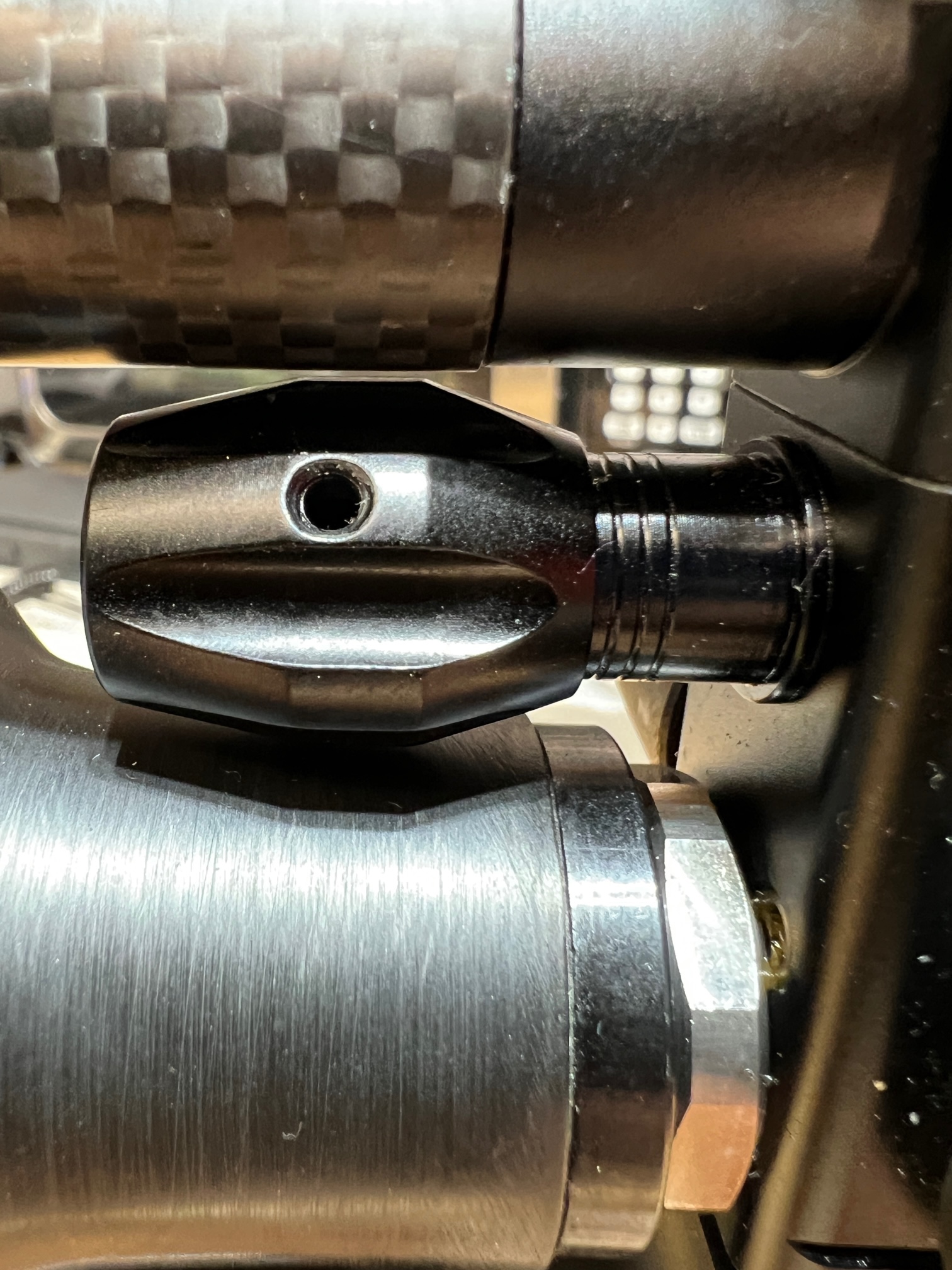

Yes, these are pellets....I set this gun up just for pellets, I don't shoot any slugs with it. The small diameter carbon fiber sleeve that is sold for the barrel liner that goes into the steel barrel housing, I bonded the barrel liner to the carbon fiber sleeve with JB Weld epoxy, some people just slide it over the liner and use it like that...but, in my opinion I think it makes the liner stiffer if it's epoxied on the liner.

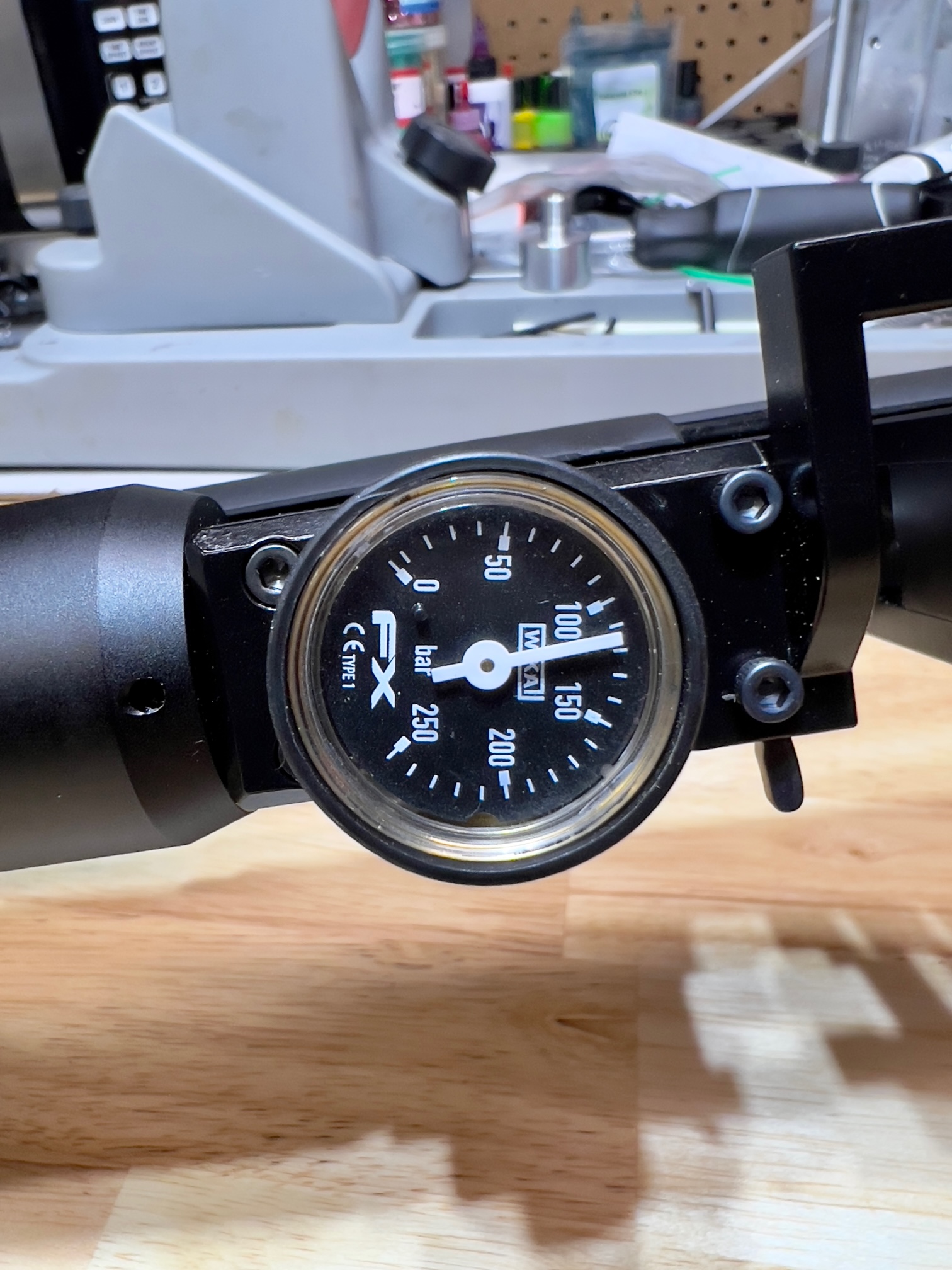

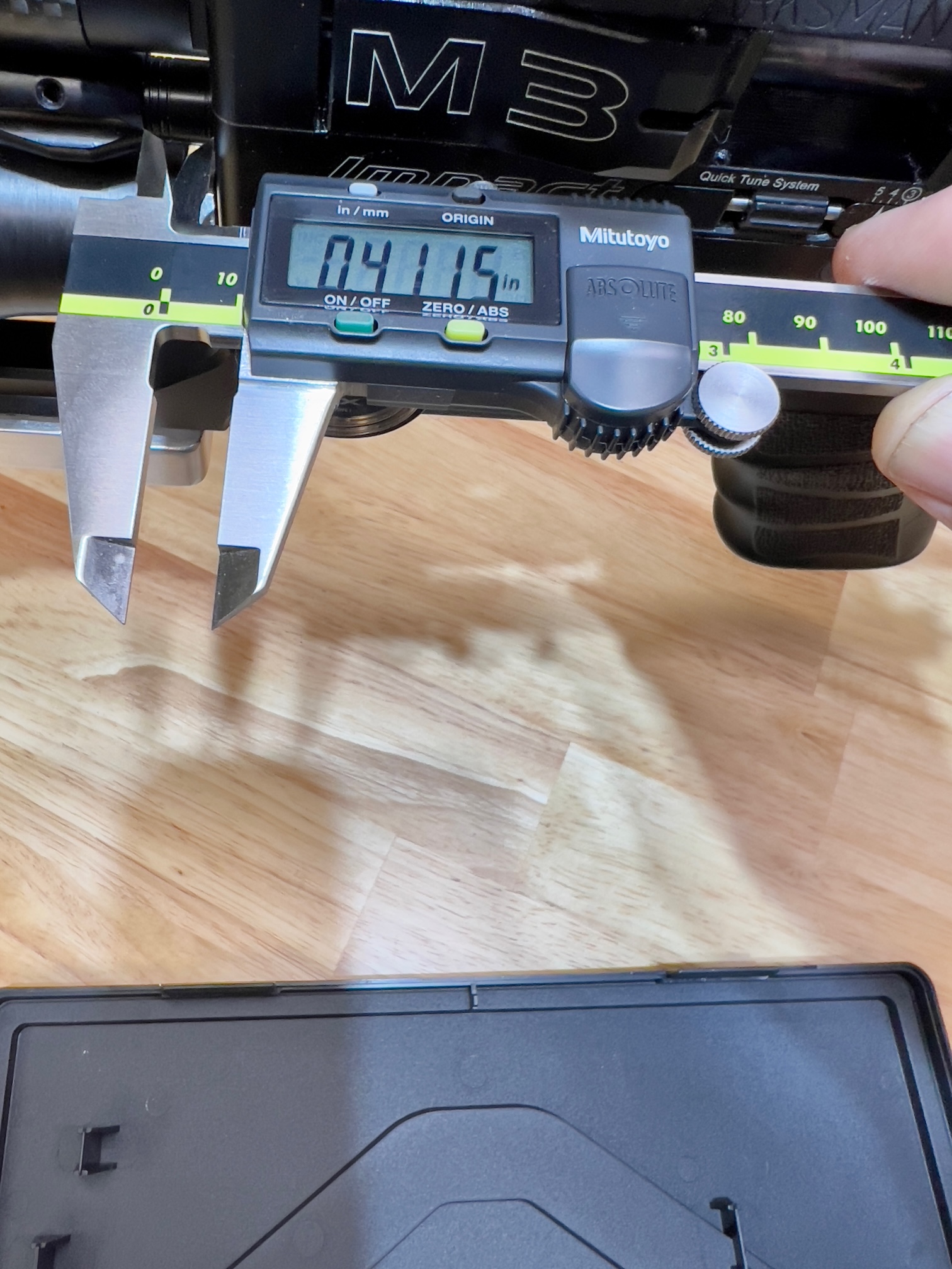

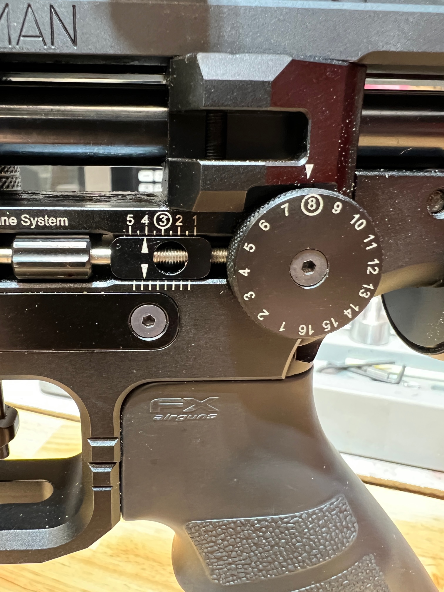

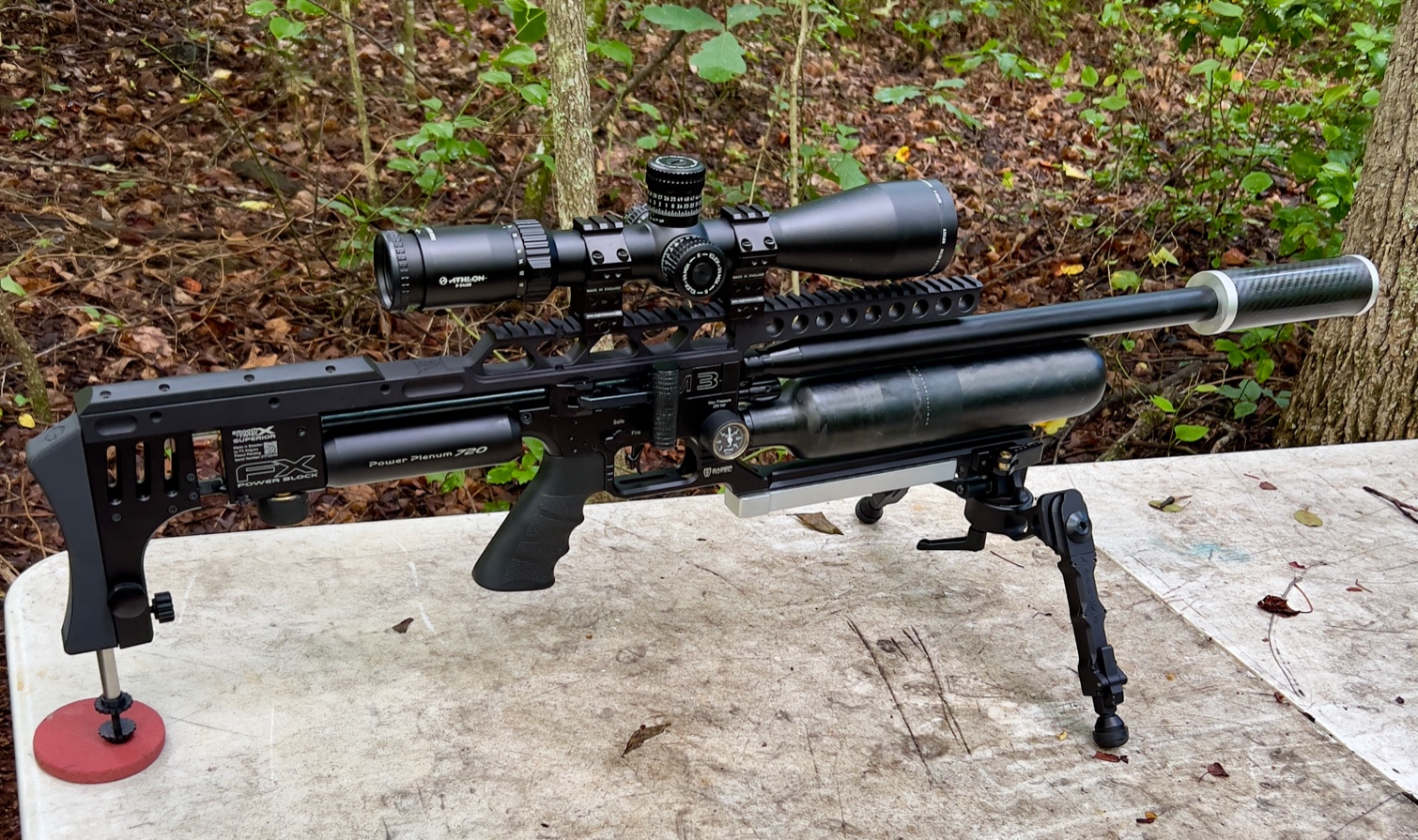

Thanks.....I deleted the first reg. and installed the Saber Tactical reg delete fitting....the 2cd reg is at 115 bar, I'm shooting the JSB 33.95 MK 2's....900fps. 700mm barrel standard liner with the tension barrel sleeve JB Welded on, carbon fiber tension outer sleeve....here's some pics.......:)
