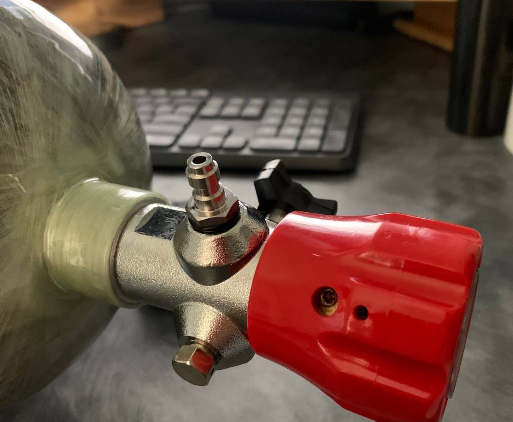

Hi BlackbirdPS,
I'd need at least a photo of what is on your tank for a valve. The 24" whip off of the tank valve fitting may be easily removable to allow fire station or DIN 300 connection.
If you don't want to remove the whip, a foster male fitting to DIN300 female fitting would likely be your best bet for the dive shop IMHO.

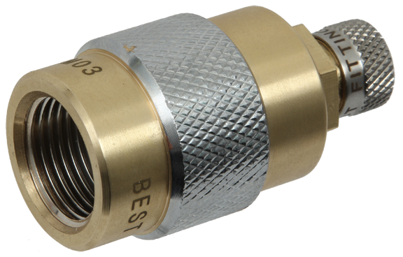

You damn sure that there is'nt a fitting screved into the tank from DIN300 to Foster???
Never heard of a tank with nothing but a Foster fitting.
If this is indeed the facts then you need one of those:
https://www.airgunsofarizona.com/pcp-accessories/300-din-female-to-female-qc-fitting/
It will screw onto their male DIN300 fill hose and connect to your double Foster fitted hose.

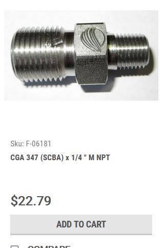

For the Fire Department, a CGA 347 to foster would likely fit the bill. Down here in the states it is common for SCBA tanks to be fitted with the male CGA 347 interface (the left hand side of the fitting shown below). If you take one of these:
and attach a male foster fitting to the NPT threads on the right hand side of the above fitting you could then fill at the FD through your wip.

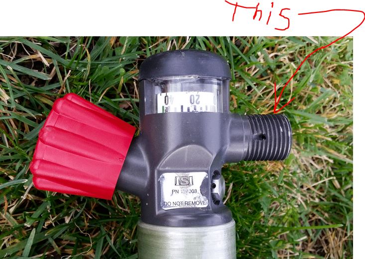

I'll give it a shot. FD fill systems have used the following CG 347 connector on their tanks. There can be others but this is most common:
If you have that fitting on your tank you are good to go. (The word "This"). If you have some other connection you just have to get to there.
