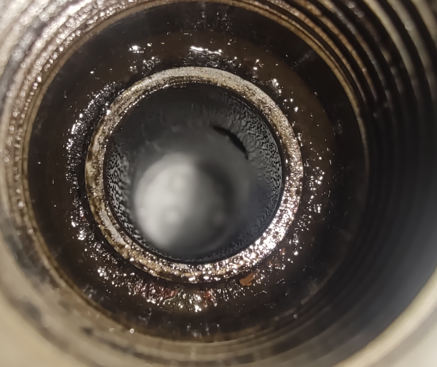

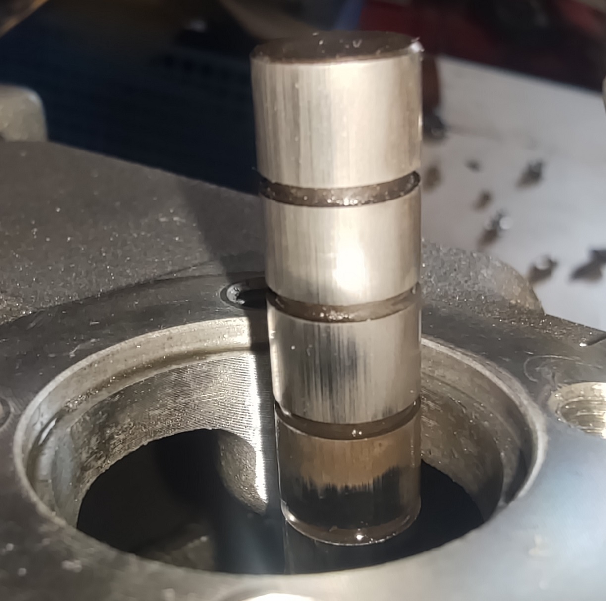

Okay so yesterday i ripped off the high pressure #4 stage, and it feel OK, piston in cylinder is like a suction fit.
Piston wear do however seem a bit irregular looking at the piston itself. looking into the cylinder i cant see much, maybe some wear on Cylinder wall too.
The big surprise was all the gunk on the one way valve after the #4 stage, it was gunked up good, and actually also some soot like black deposit on it.
Further more the seal, which is pretty much just a steel disk, well it sealing on the end of the cylinder liner, there are a indentation of that into the metal of the valve disk
On the + side the crank case lok really good not anything nasty as far as i can see, the oil was of course black but it have also run a few hours ( 20 hours or so on it by now )
Some accompanying photos for my next contact to Tuxing.
The stage #4 piston.
The return valve.
Return valve spring.
Return valve seat 8 top of Cylinder #4
The return valve disk ( top of it )
The bottom sealing side of the return valve disk.
Cleaned you can feel a indentation in the metal disk where it seal on the top of the cylinder liner.
I did run the compressor before take down to make sure i did not overhear a leak, and it got to 170 BAR and then stopped going further up.
I let the compressor sit pressurized while i took of fan belt protection and fan protecting grill, loosened the motor and pulled off fan belt, and it had lost about 10 bar during that time, not unreasonable i would think i did not expect a entire compressor to be the end / seal all plug.
