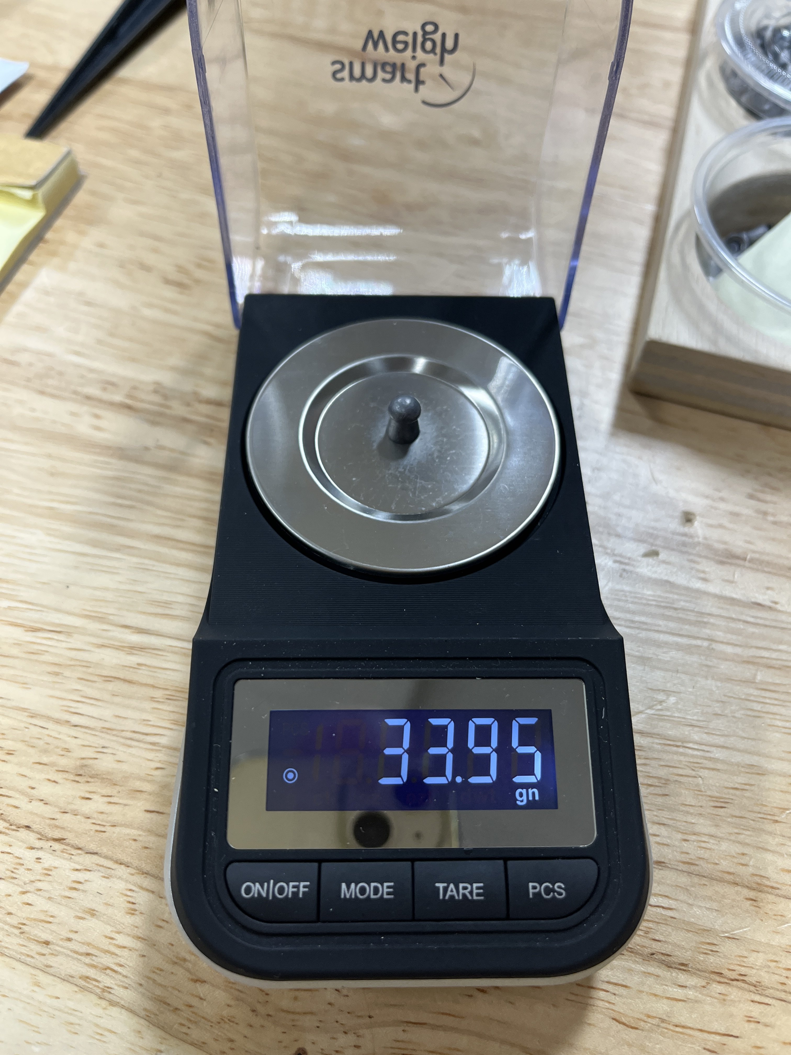

Mike, Regarding weighing your pellets. Does your scale measure in Grains and Grams? If so, and you want to get better weights go to the grams and you get one additional decimal position. Or 10 additional weights per pellet weight.
Gets even better if you have a scale that measures in x.xx grains--x.xxx grams.
Centerfire
Yep, mine does x.xx grains.
I haven't done my weight sorting, read this mostly to learn. But I did investigate the variability in some 25 caliber JSBs I had on hand when I was trying to cast my own with a NOE mold. I was surprised by the weight variability I saw in pellets that shot well. It was greater than the variability in my cast pellets. So I am not surprised the OP saw a grain difference in a tin.
