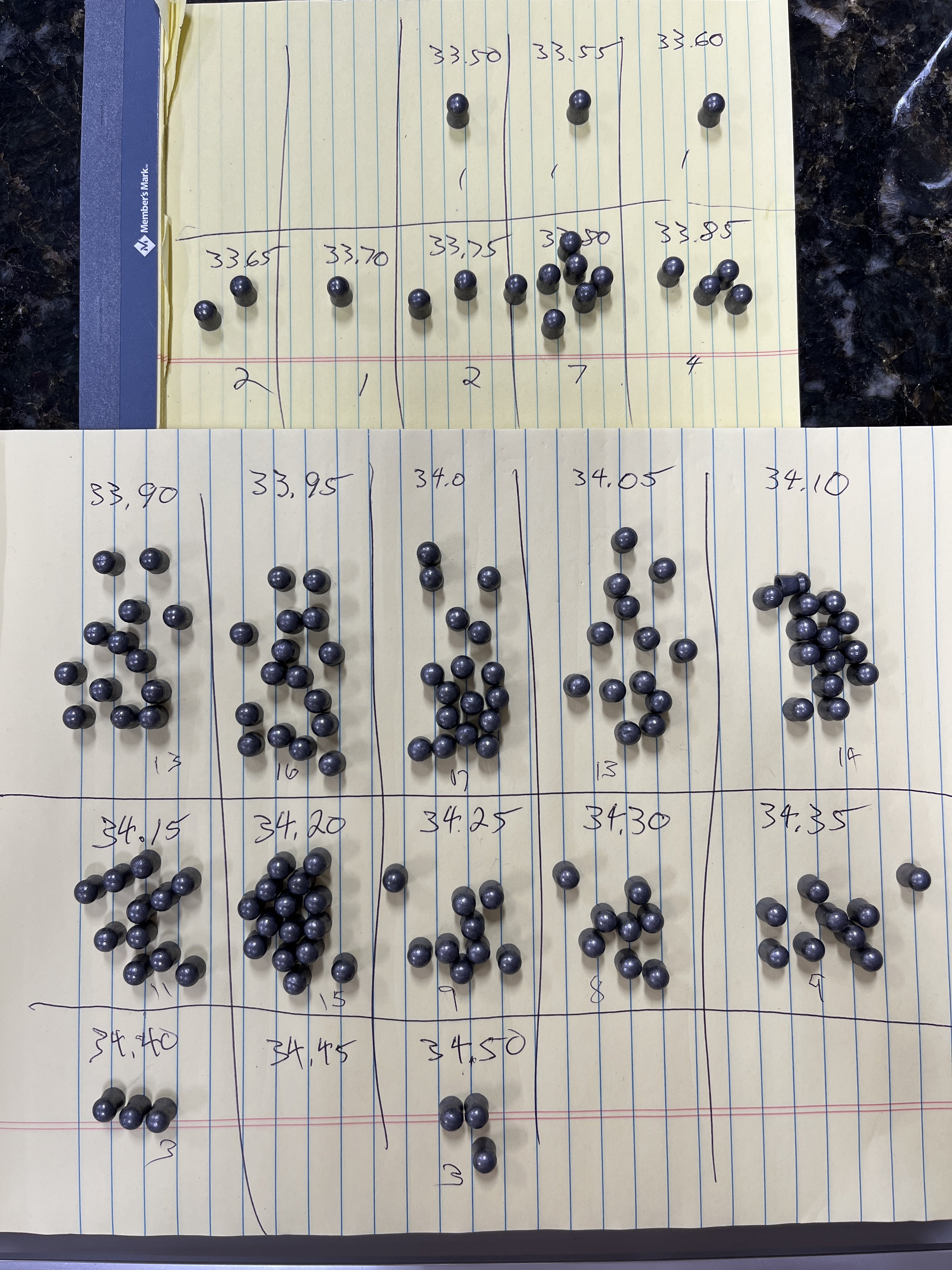

I decided to take a shot at pellet sorting by weight. Watched the boot camp video that Chris from Airguns of Arizona did then I took about a half tin of .25 FX 34 grain pellets, washed them then began sorting. I used Chris's method of separating the pellets by .05 grain difference, plus or minus .02 grains. The photo below shows the spread. I was surprised to see the results. I expected to see one large number of pellets in the middle weight range and just a few trailing off lighter and heavier. My question is this - is keeping the .05 grain difference within each group really critical, or would the same results be gotten if the spread within a group is, maybe .10 grains or more? What weight difference within a group of pellets begins to affect accuracy? Thanks for any input!

I haven't done my weight sorting, read this mostly to learn. But I did investigate the variability in some 25 caliber JSBs I had on hand when I was trying to cast my own with a NOE mold. I was surprised by the weight variability I saw in pellets that shot well. It was greater than the variability in my cast pellets. So I am not surprised the OP saw a grain difference in a tin.
I messed around with head size variability for my P35-177. I got curious because I had a tin of Crosman 10.5s that shot as well as H&N Baracuda 10.65s. So I bought a couple more tins of the Crosmans and they shot much worse. I guessed head size, bought a Pellet gage and took enough data to convince myself that was the culprit. I only had less than 20 of the "good tin" of pellets so I measured their head size and 20 of the new tins plus some of my H&Ns. I have not shot JSBs in this gun (my other P35s like H&N better so I'm assuming the 177 does too). A 20 pellet sample, selected at random, is not really enough to prove beyond a reasonable doubt much of anything but It did give me an idea what was going on. I found the two newer tins of Crosmans had a lot more variation in head size than the 18 pellets I had from the "good" tin. I later sorted one entire tin of 500 and found pellets at each size on the pellet gauge. 10 different head sizes. The sample of the "good tin" was much less variable as were the several tins of H&Ns I sampled. I also found that H&N Baracuda Match were less variable than Baracuda and Baracuda Power. I will shoot up the Baracuda (almost gone) and Baracuda Power (2 or 3 tins of those to go) and then standardize on the Match. Probably worth the price difference to me. Last, point. I shot several 5 shot groups with each head size of the sorted tin of the "bad" Crosmans. My P35-177 really does not like the small head sizes. They were pretty prevalent in "bad" tin. I still have a bunch of that sorted tin, I should probably try weight sorting them too. But I've pretty much decided Crosmans are just not consistent enough for me to buy more of. I like the price but I don't like how them shoot. I may be able to get some good groups sorting for head size and weight but I'd rather spend a little more and buy Baracuda Match and avoid the sorting (at least until I try hunter field target).
