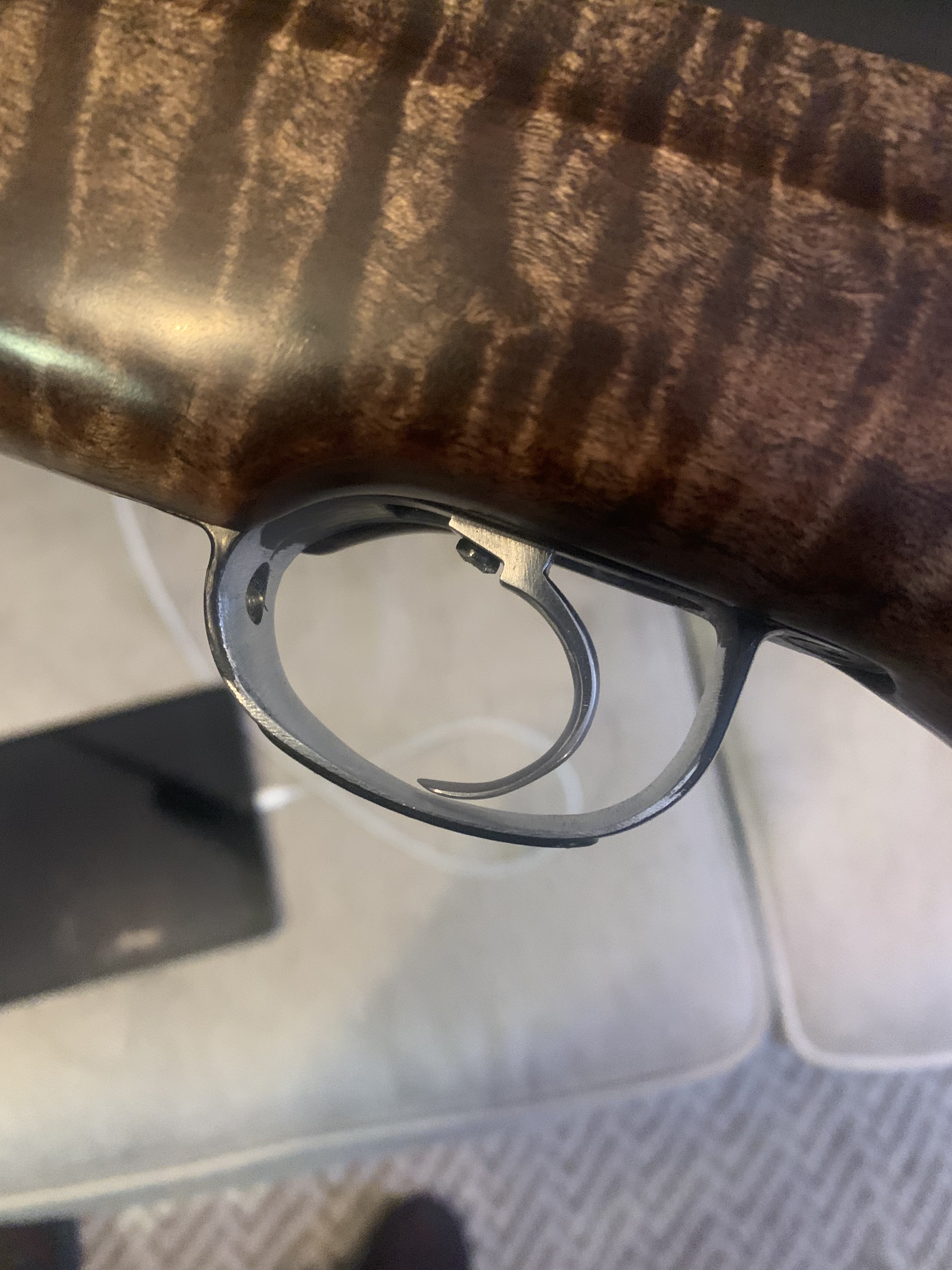

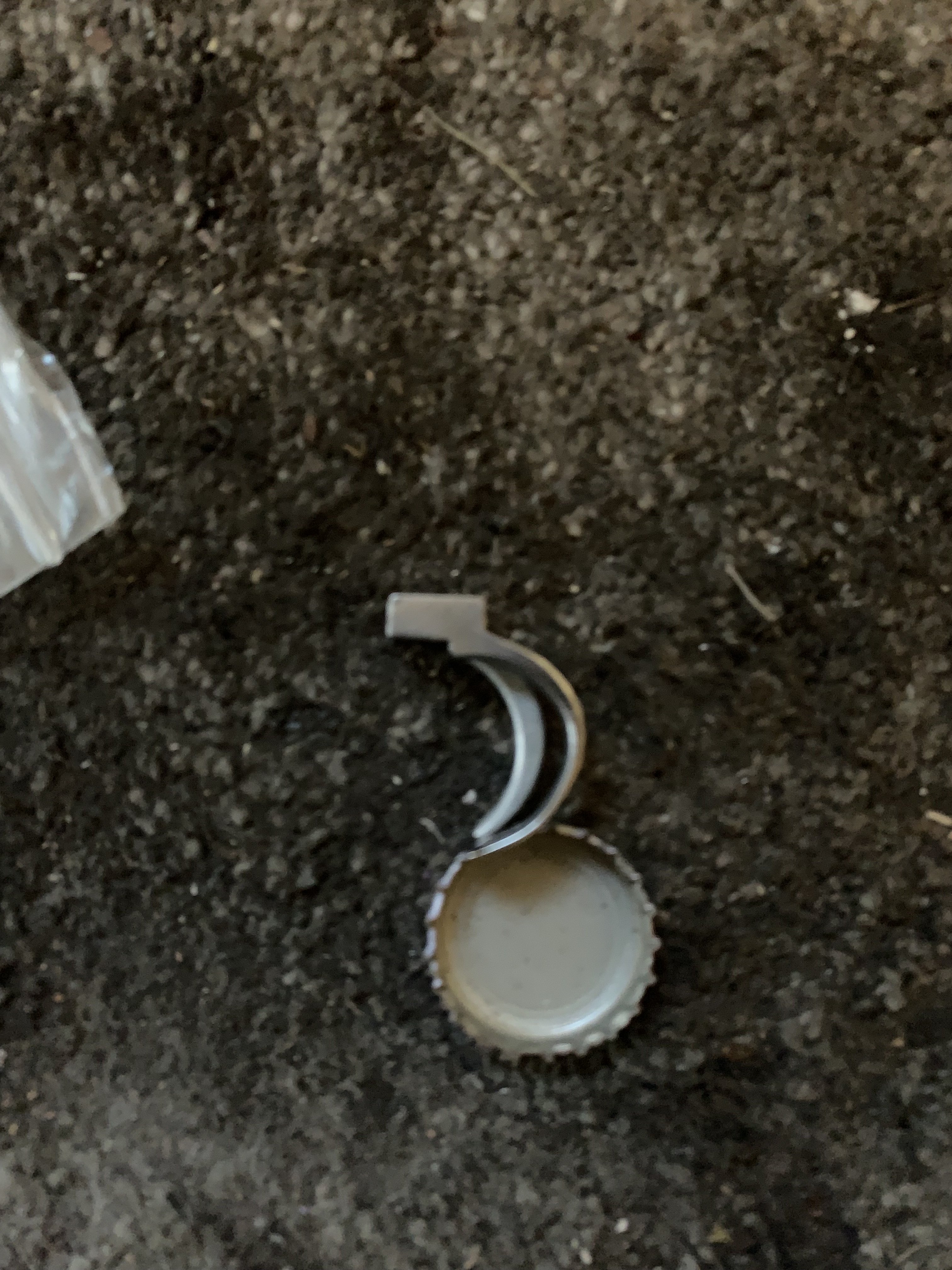

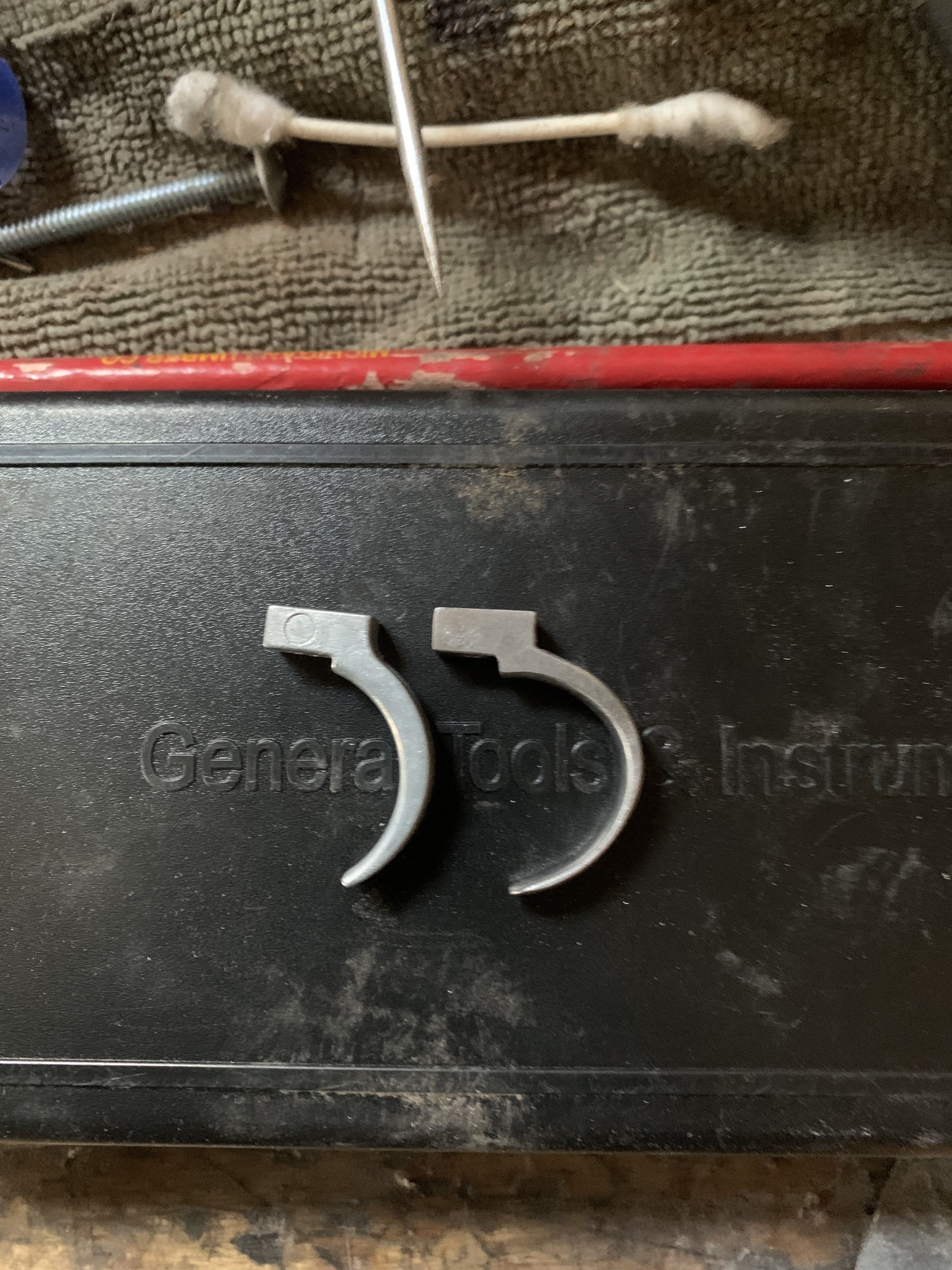

Weather broke from single digits to balmy 26 *. So I decided to do some manual work to keep warmer.

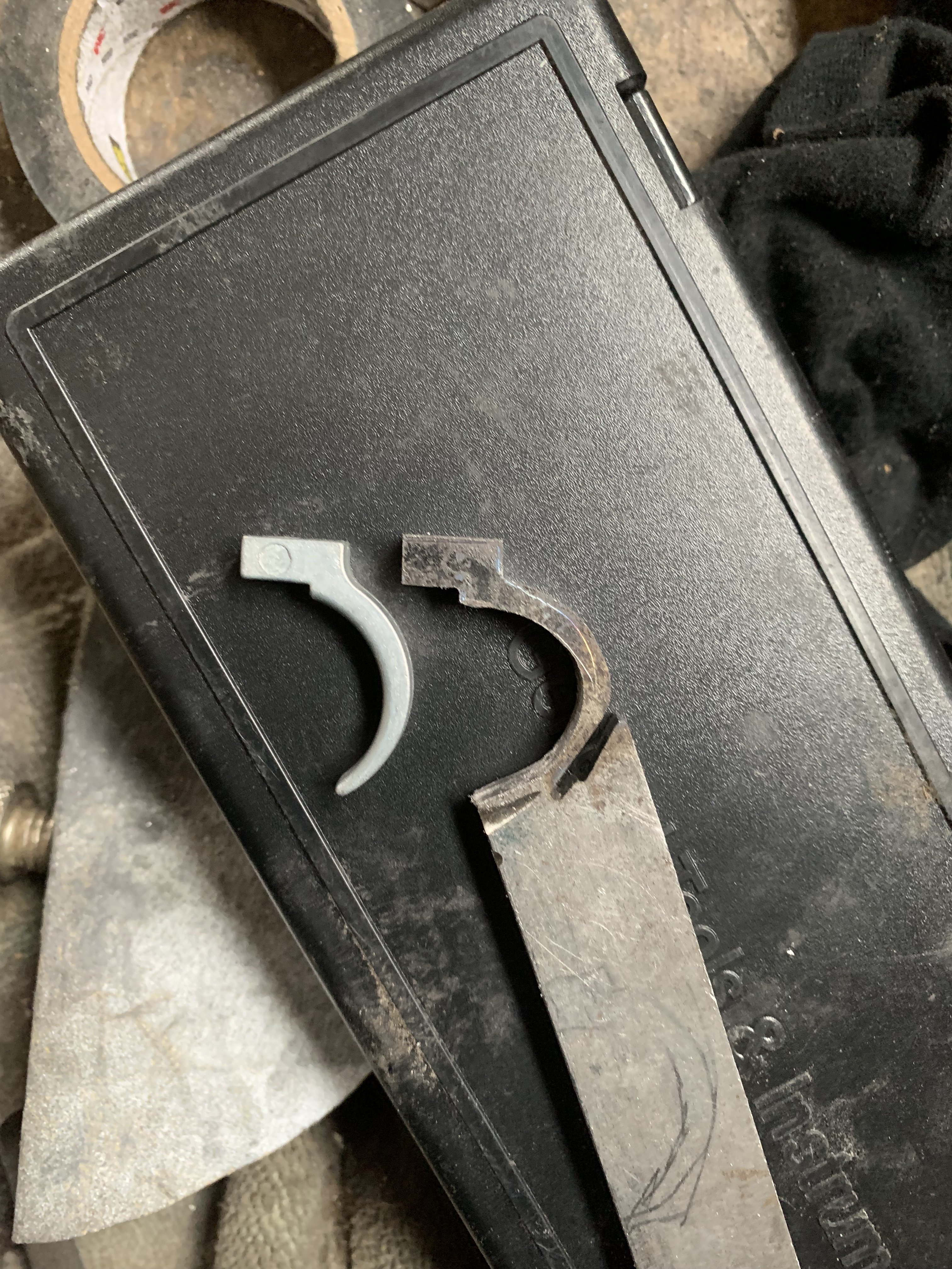

I decided to finely make MYSELF a set back trigger for my own Uk Tommy triggered prototype gun. ( Firefox) I’ve made them in brass, aluminum many times for various guns. ( brass for others ,as I despise brass, brass has no place on a gun). 🤮
I decided to get creative and try one out of 4140 plate. (I had some left over from some sears I made) ..
WONT BE DOING ONE AGAIN SOON… 4140 isn’t aluminum … 🤨
This trigger is a Uk Tommy /Longbow unit in my own prototype power gun. The blade is set back quite a bit and those units have a downward angle attachment block the blade screws to. It’s not so easy to just shave the top as the pull changes and the sear angle pressure gets affected. So to keep things in the same geometry as factory I had to shave a bit out of the inner trigger guard. ( in hindsight, if I was making a new stock I’d just drop the mount of the guard 2 mm but this was an existing stock.)
It’s in and shooting… The pull is much better as your not reaching for the trigger and the feel is smoother. I’ll re powder coat the guard and be done. Some final buffing to shine up the trigger blade.
The 4140 machines and hand works well but it’s three times as hard as brass or aluminum. Sharp files and patience is needed..

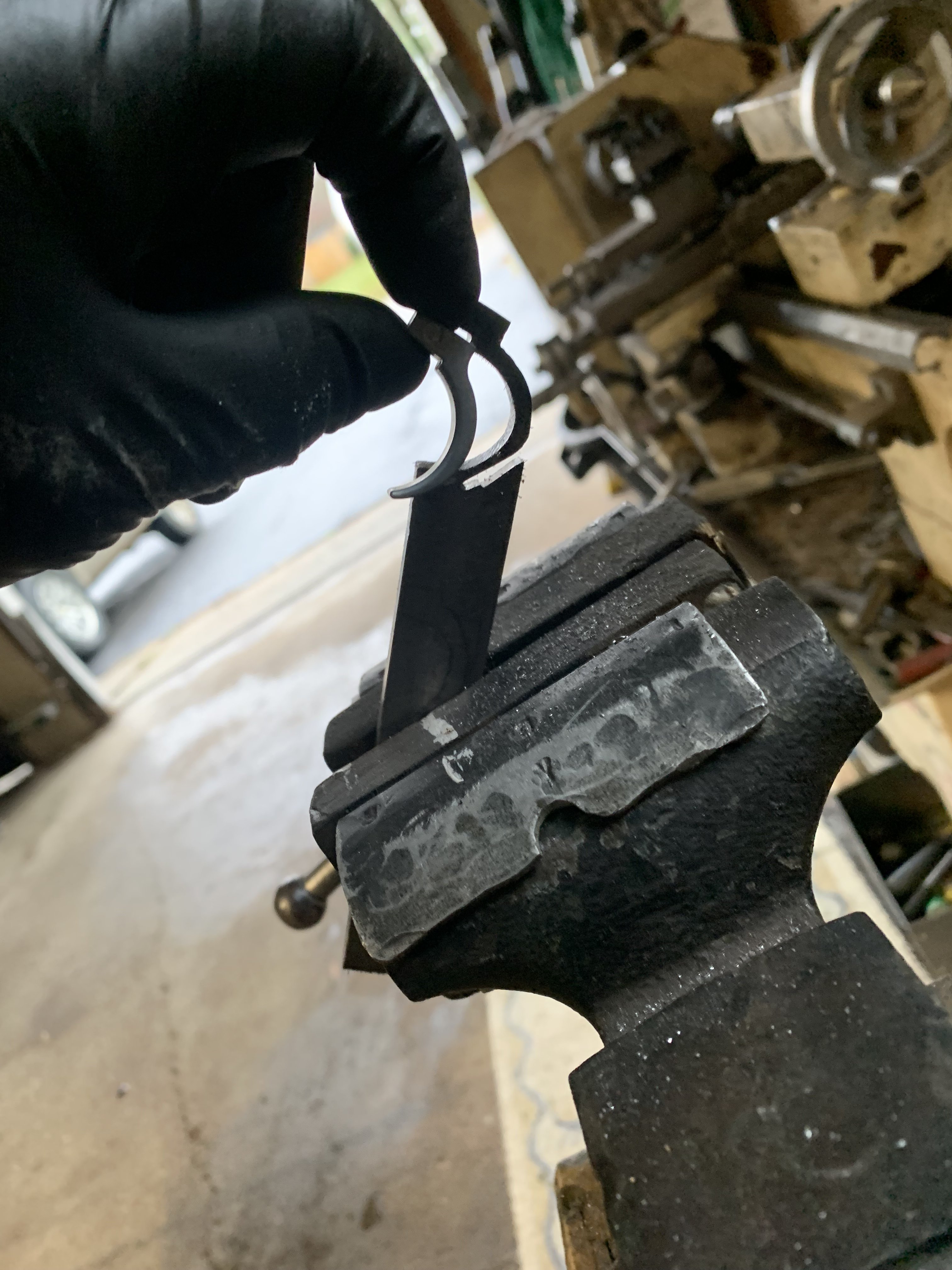

Back to basics with a hacksaw and file. (y)
Nothing like making our own parts. Our way.

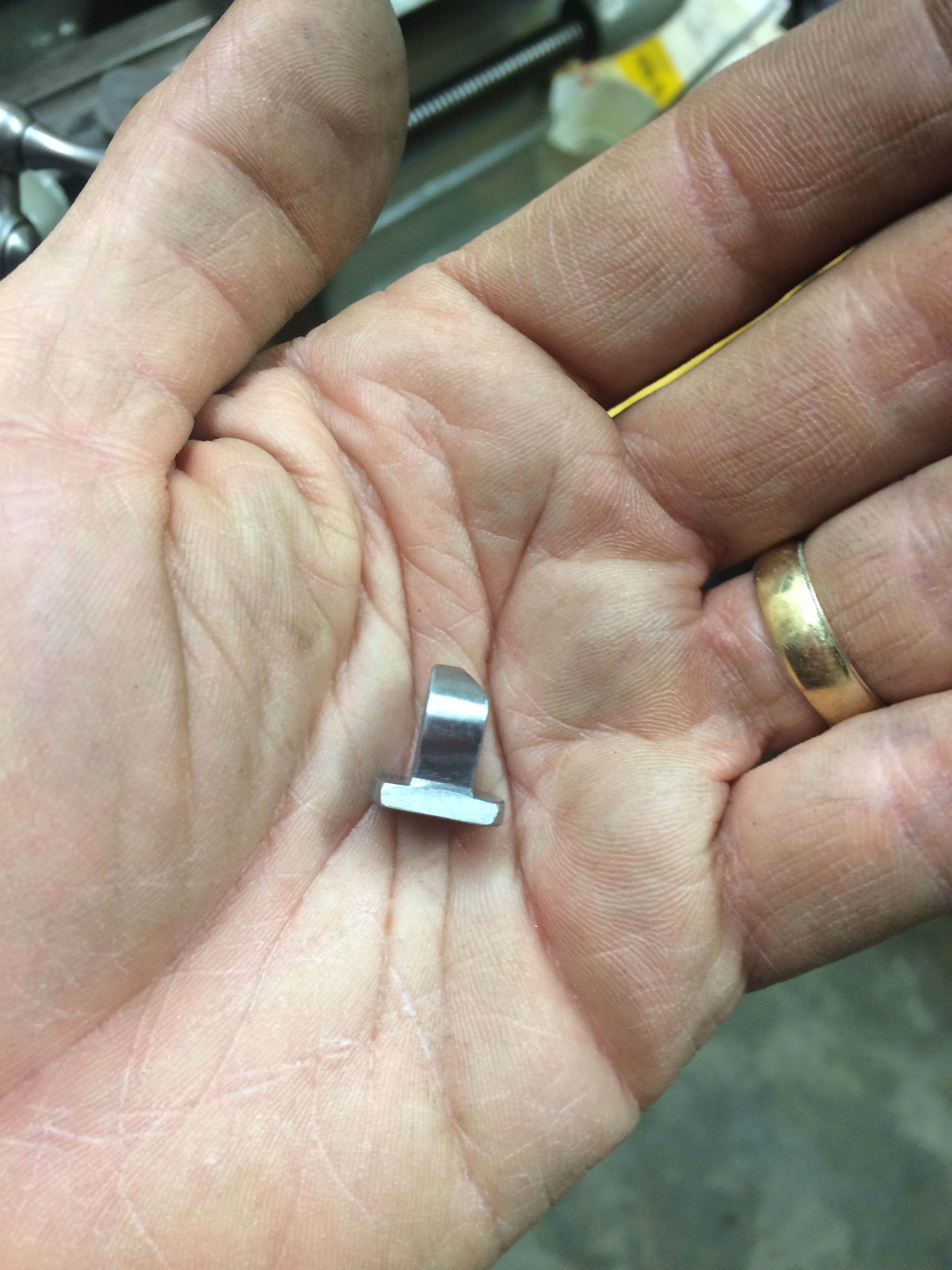

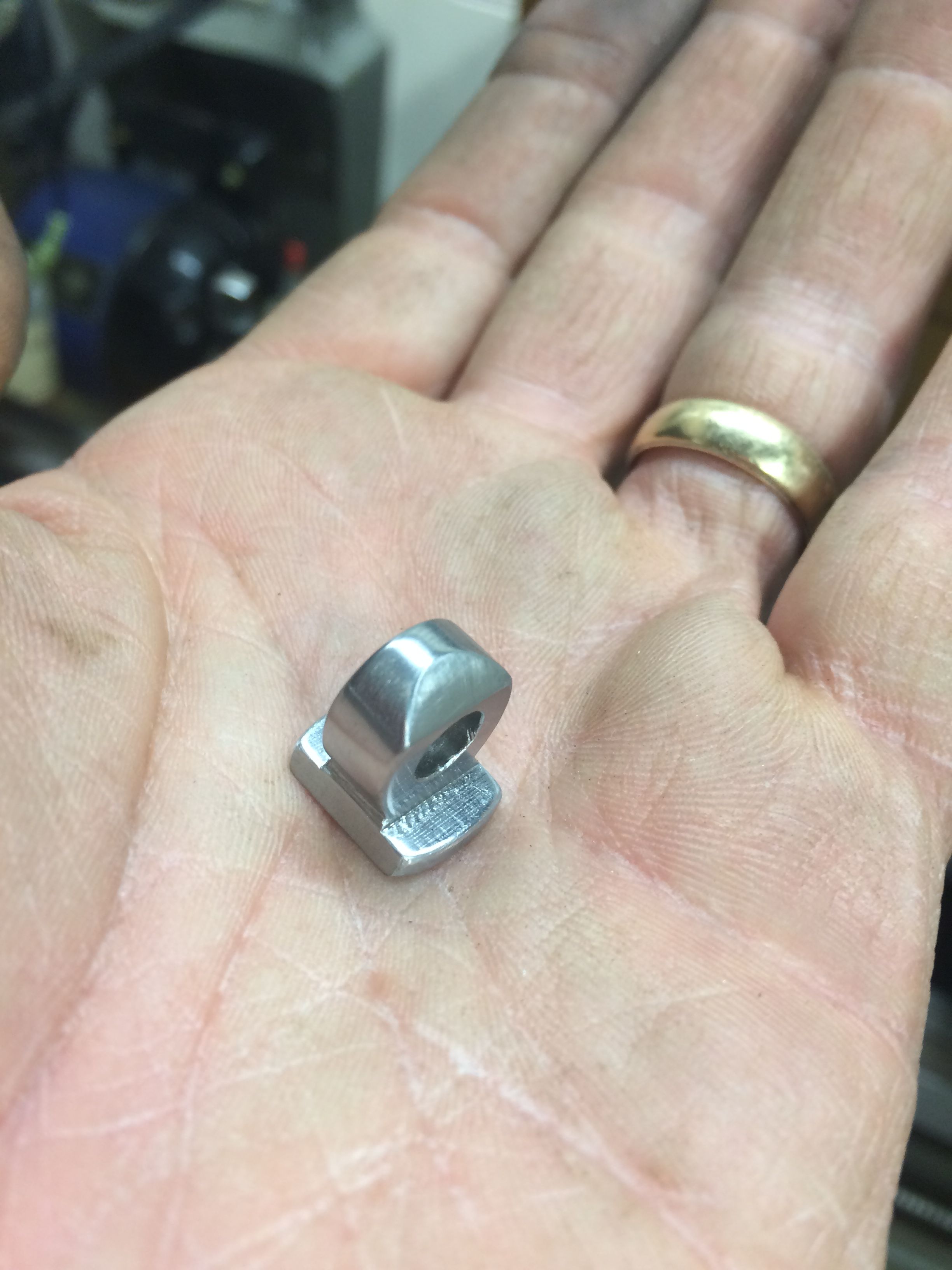

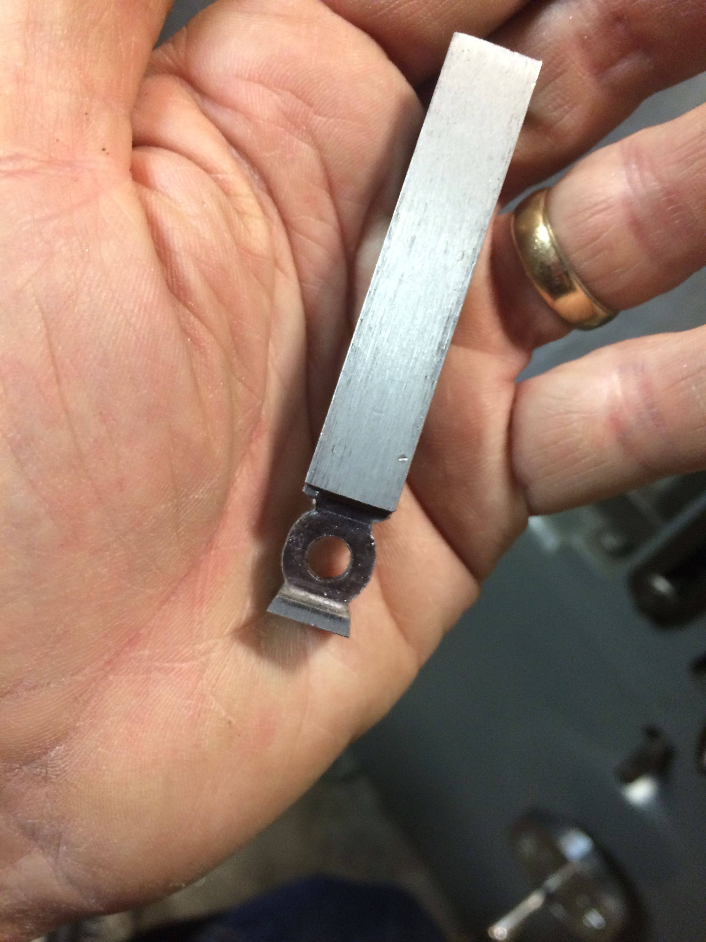

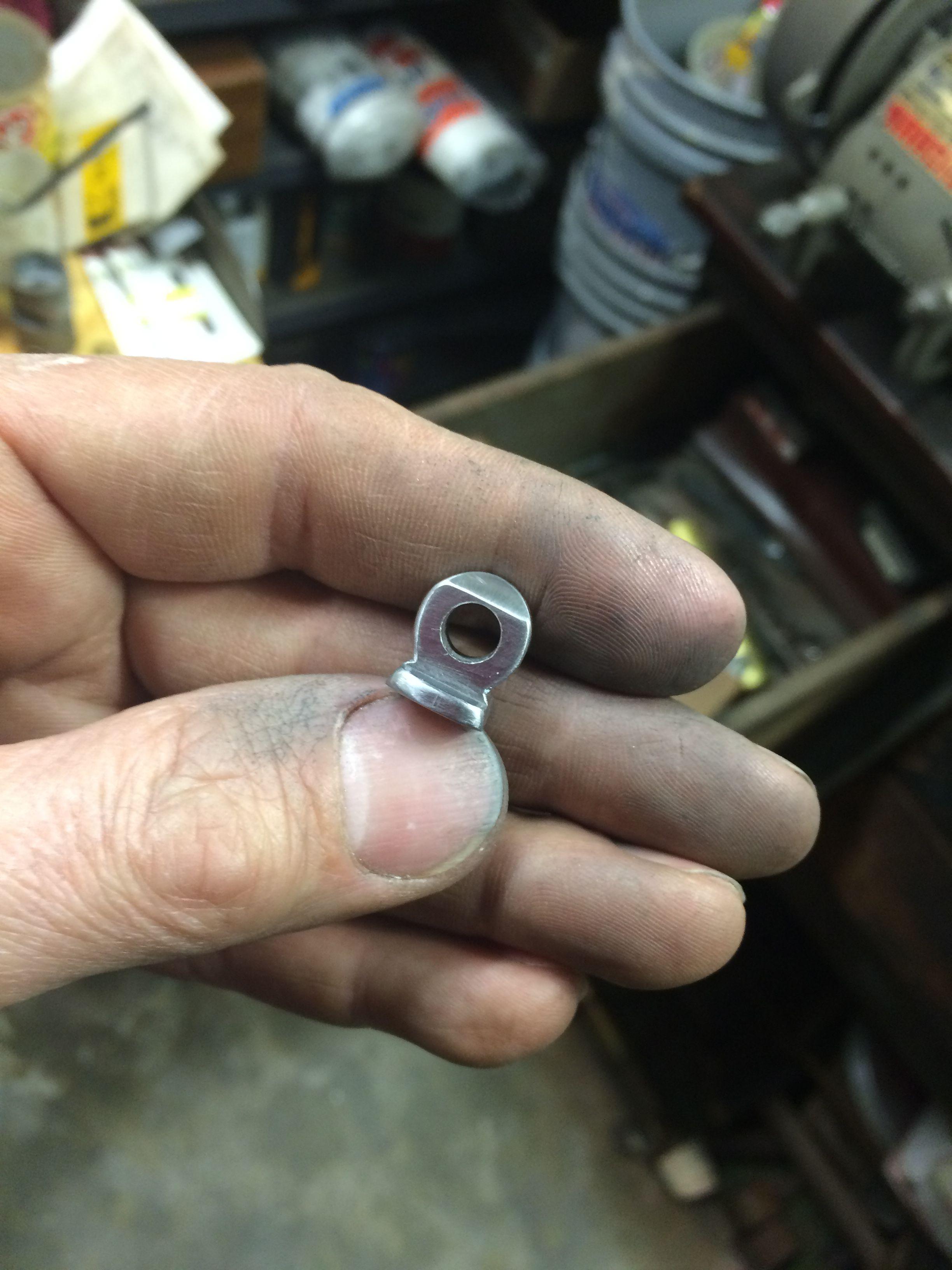

Cut the dovetail then roughed out on my metal shaper. Time to hand finish with a file and oiled sandpaper. Those are my favorite parts. Hand finished to look like jewelry. Cocking lever catch for a 1912 BSA Improved Model D
Take a piece of steel and carve away anything that doesn't look like a cocking lever catch. Then polish it. :)

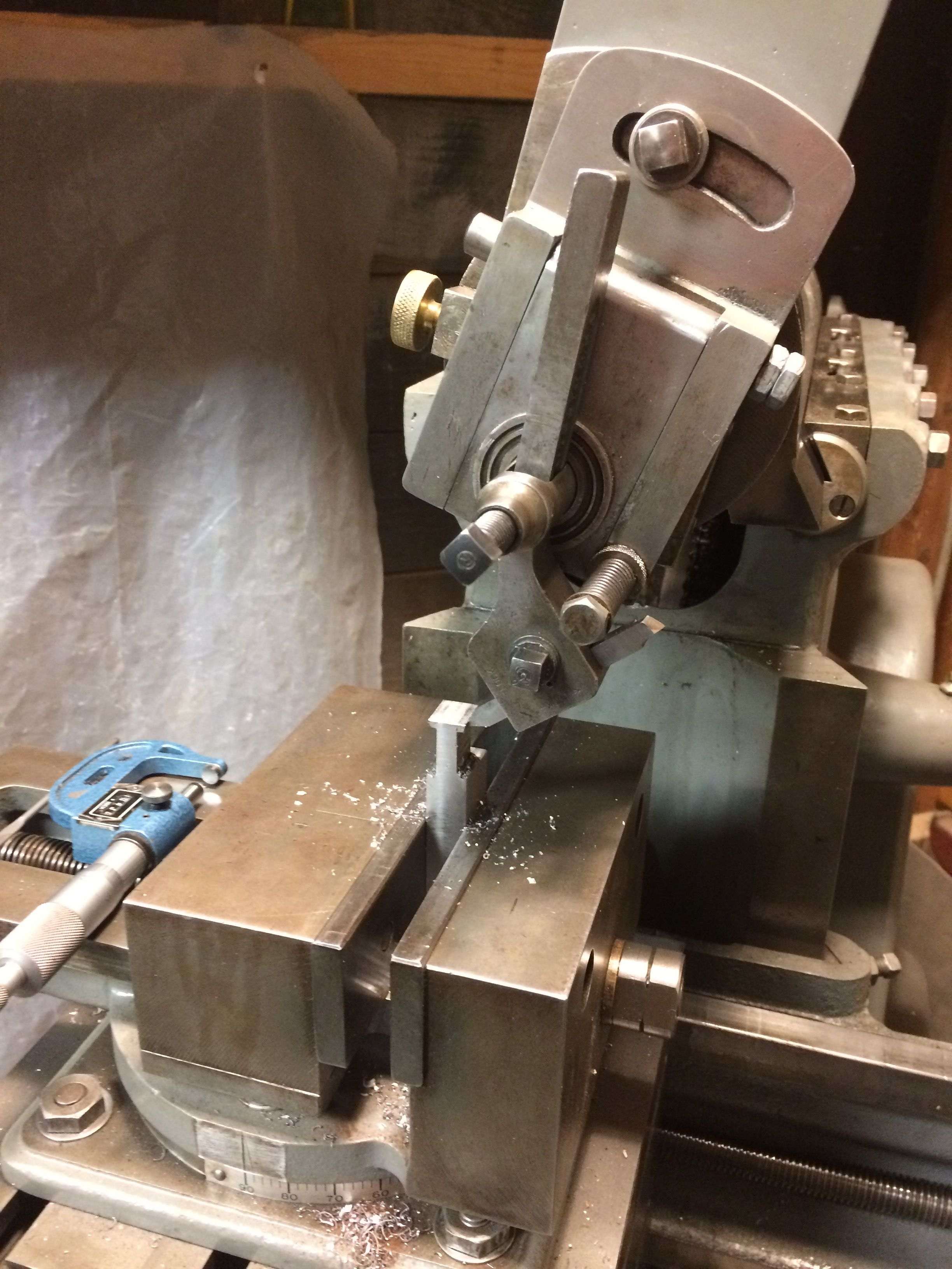

I even made custom parts for my shaper. See the knurled brass knob and a square head bolt in the radiused slot? First pic.

Who has a mini shaper but Karl. 👍
The saying goes:
"You can make anything on a metal shaper except money"

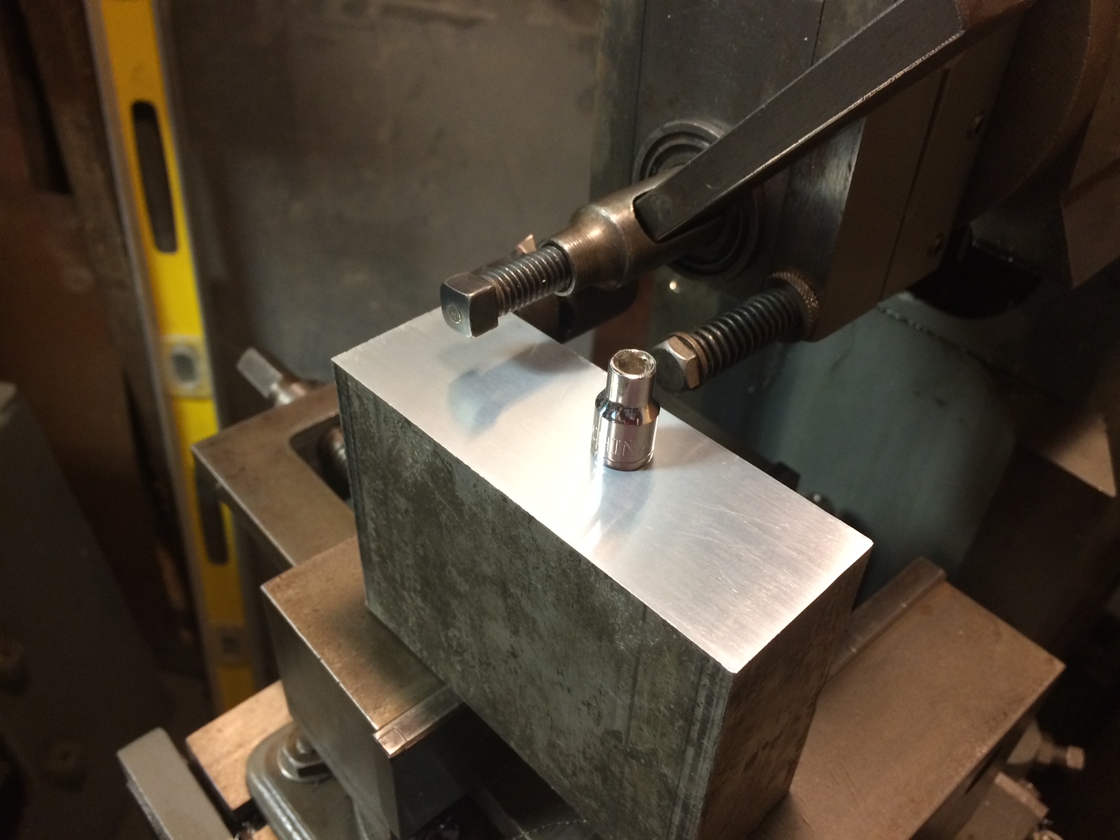

I can set the tool slide over and cut any angle. So I don't need dovetail cutters in every angle imaginable for my milling machine. Hand grind my own cutters.
Beautiful finish on aluminum
Carriage stop for my lathe. Has a hue like fly cut, but linear lines
