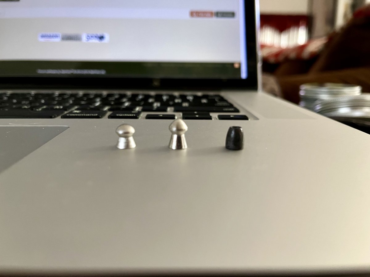

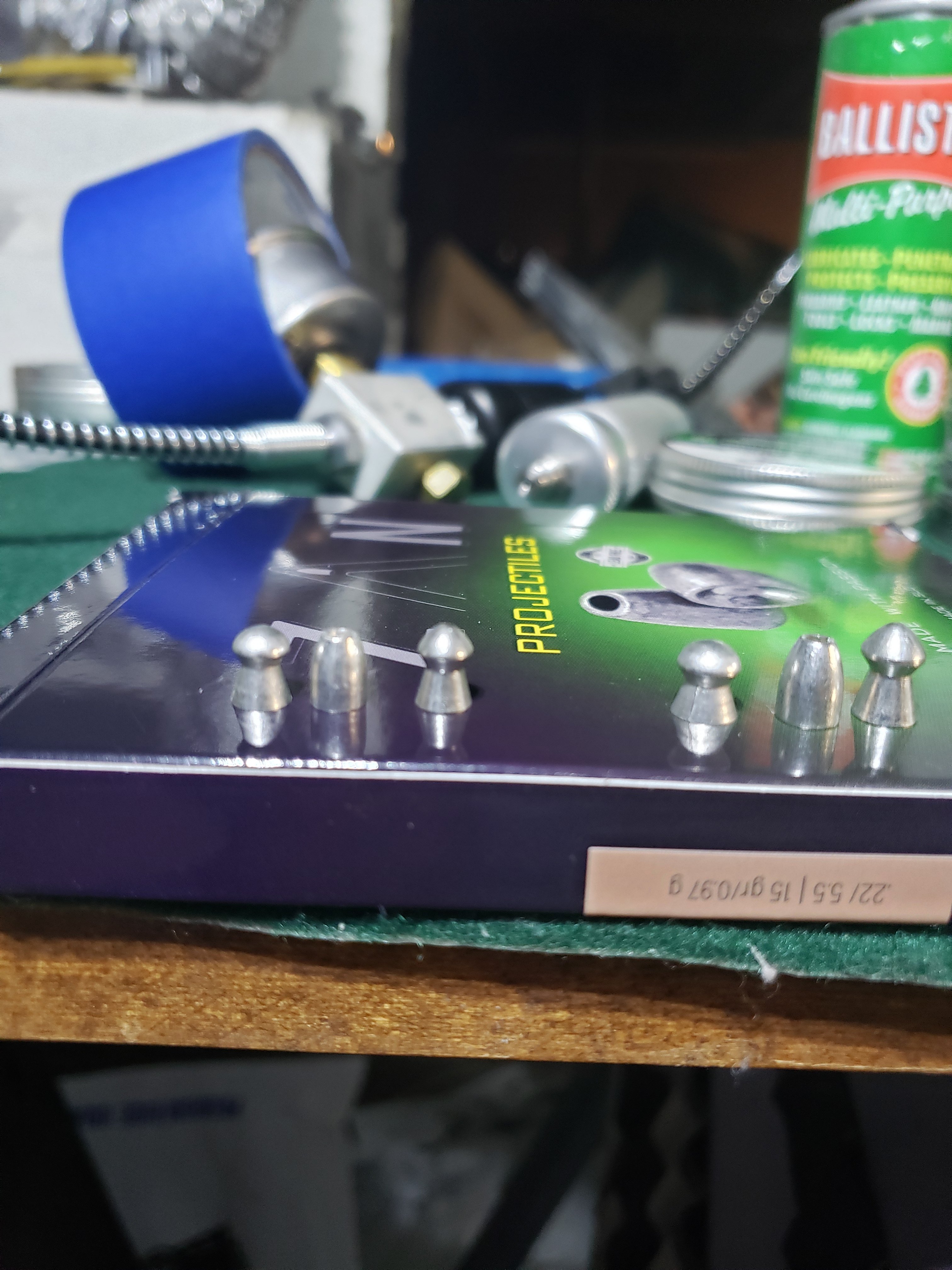

Could you please post a few close-up photos of the " ZAN Lead-Free SLUGS " next to the "Lead-Free PELLETS " for length comparison ?.. :unsure:
EXAMPLE:
.25 cal 16.54-grain GTO Pellet / .25 cal 19.91-grain H&N Baracuda Green Pellet / .25 cal 30-grain H&N LEAD SLUG.
