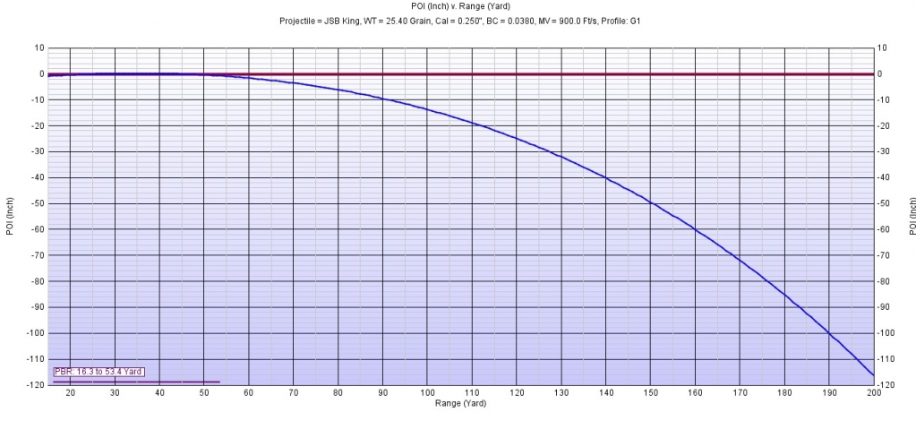

Just keep in mind that even a .25 cal PCP shooting at 900 fps, you'll be dealing with about a 10-foot drop at 200 yards (from a 48-yard zero). IMHO, anything over 100 yards with a springer is a loooong way. I have owned a 34 in .177 and a 350 in .22 and a 48 in .22 and loved them all. Definitely NOT a springer hater here. Just trying to make sure expectations are realistic!
Here is the drop trajectory I mentioned. Any springer's trajectory would be much more dramatic than thig.
