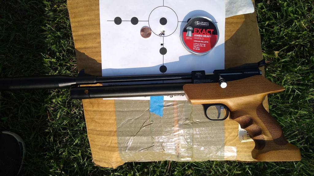

I used the single shot tray and loaded up some JSB Exact Jumbo Heavy 18.13gr .22cal Pellets.
I shot a respectable group at 25yds with the factory sights, no adjustments were made at all, no cleaning, nothing at all, just pulled it out and shot it..
Shot #3 was a flyer no idea why I was shooting from my bench using a bag as a rest. Maybe it was me or maybe it was the gun or pellet. But the way the other 4 grouped tells me this gun should be a good shooter. I shot a couple more groups mainly while adjusting the sights a bit higher so it would be spot on at 25yds and it continued to group very well.
