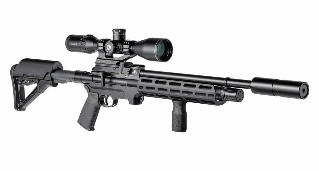

If you want that type of form factor and aren't in a hurry, these are supposed to be coming out soon. The AA platform is well proven, but I don't like the safety. Not a deal breaker though.
