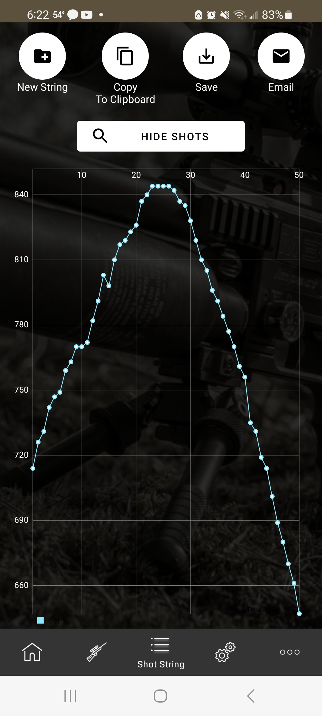

This one, I named the rifle I always wanted to like.
It was my first PCP.
I was disappointed in the accuracy being Coke can accuracy, while was expecting squirrel head accuracy. I complained to Beeman, and tried all of there recommended pellets to no avail.
I also learned that It needed a regulator. The shot strings started high and fell as the air pressure dropped.
I did some studying and found that adjusting the hammer spring tension could help with shot sting consistancy.
So I bought a chrony and started playing with it.
By reducing the spring tension the hammer can't overcome the tank pressure, so it releases less air. As the pressure drops the hammer is able to release more air, so you start slow and get strong then slow back down as the pressure falls.

Those are cool rifles. I've been in the market for a used one for a while. The plan is to give the barrel a really good cleaning and then fill it with a bulk co2 tank. That will keep the velocities a lot more consistent. With a little tinkering, over a hundred shots between fills should be possible.
