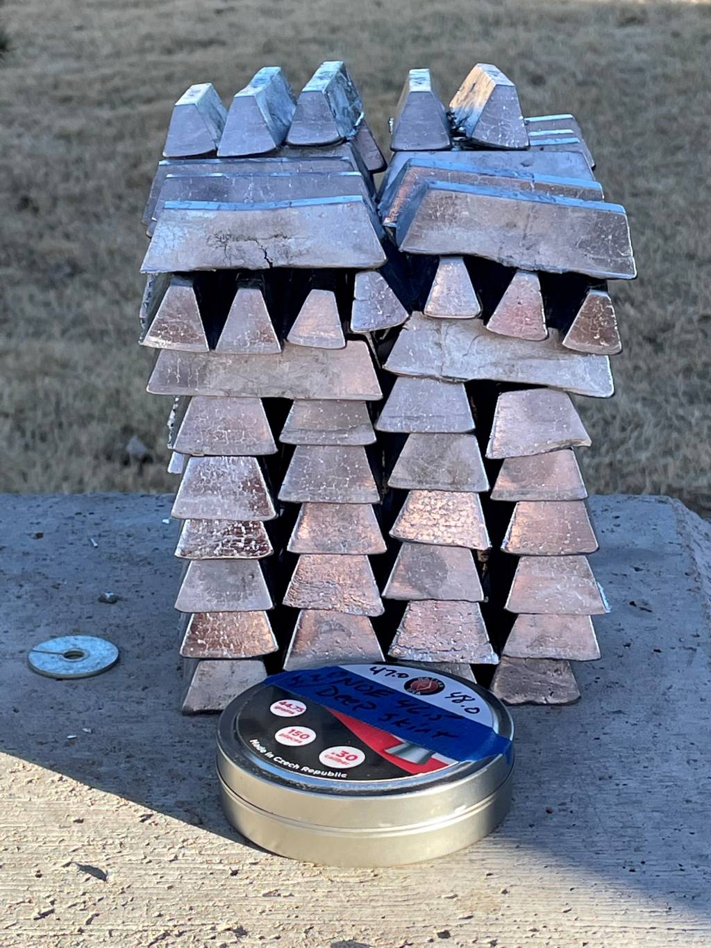

Well I started out baking the mold for an hour, mounted the mold on the handle, cast up 154 premium pellets sorted with not a single reject, made a lable for the tin and wallah I'm done. I sure was happy with the way these pellets came out however the bigger the pellet the easier it is for a good successful run. I cast these up using the lead from the lead pipes. I've got a nice UTG 3-12X Bug Buster ordered, when it gets here I'll mount it on my Challenger SL 30 cal and off to the woods I'll be going. I still haven't even taken the gun out of the box yet because I've just been having so much fun hunting with my other AEA guns. I swear the AEA's are the best darned hunting guns you can buy for the price. I'm also very happy with a plan that's been turning out so good so far. I just checked the gun out and the air in it is still right where they shipped it at so the gun is most definitely holding air excellent.
I'm using an old Lee 4lb casting furnace I've had for years using the pressure pour method, it's the only way I've ever had good luck casting for years, I show a short video of how I do it basically, it takes a while to get use to doing it this way but works well for the smaller calibers to fill the skirts out good on a pellet, I use only pure lead and the lead pipe after cleaned good in a 20lb pot tests 4BHN and that's about as soft as you're going to get.

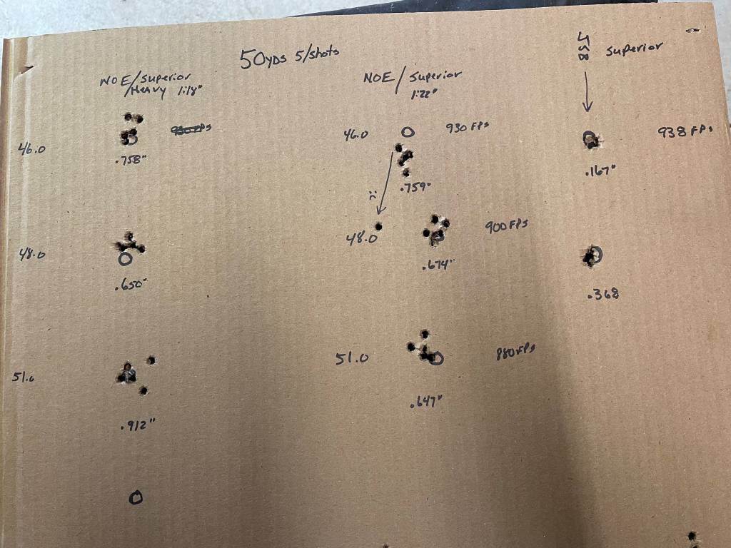

Here's some testing groups of the NOE 30cal. The deep skirt being the lightest at 46.0gr, the medium skirt at approx 48gr and the shallow skirt at closer to 51gr. Shot out of my MKII Impact 700mm at 50yds through both the Superior Heavy and then again with regular Superior. Since then I have run most of my castings through a sizer and sorted by weight but haven't had the time or good enough weather to rerun the testing. Overall, so far it was pretty much a wash between the two liners. The Superior liner does have a CF liner on it and today I received a CF liner for the Heavy tube. I also shot two groups of 5 shots of JSB 44.75's during this test just for comparison. It's hard to beat the JSB's but for plinking and pesting the NOE's should work fine.
