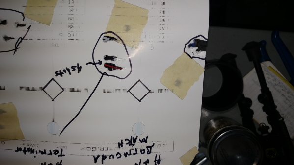

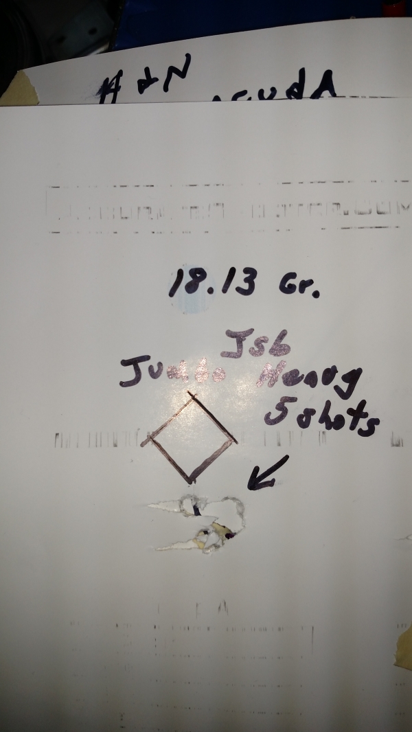

My best groups at 32 yards in wind .
I've tried many, many different pellets in 8 different PCP rifles over a period of 9 years. The most consistently accurate pellets I found to be made by JSB, either 16 or 18 grain, 5.52 mm head diameter. The PCPs have been Discovery, Marauder, Rainstorm, AA 200, AA 510, FX Royale, FX Streamline, and currently the FX Wildcat. They start at the introductory level and also get into some of the pricey stuff, all in .22 cal except the AA 200. It was a .177. I've gone through an assortment of pellets in that time, and if memory serves me, they range from Crosman, Gamo, AA, JSB, H&N, plus others that I dont recall offhand. The answer usually boils down to .22 cal JSB 16 or 18 gr .552 head size. Try them, they may be the answer to your search.
