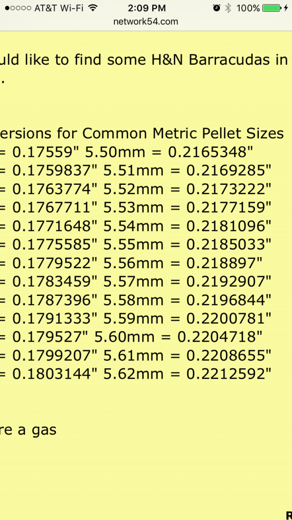

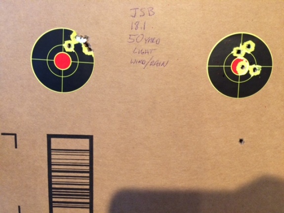

The pic above should help you with the die size you need. Looking at the pic above you can see the .224 die will be a tad to big. I also have a freedom in .22 and love the rifle. Still in the testing stage but it is very accurate with JSB 18gr. My hammer spring is set 2.5 turns cww from bottomed out and I get 4 high powered shots at 60 yards that group under an 1”. That is pumping to 3200psi. After the 4 shots it takes 19 pumps to be back at 3200psi. I have put around 600 - 700 pellets through this gun of different types pellets and have found the JSB 18s to be the most accurate. Hope this helps you, Butch.

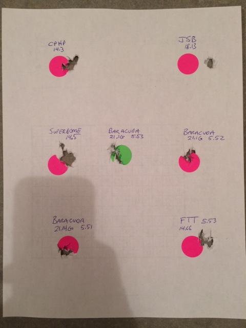

I'll post my results this weekend, so far these are the pellets I received , the crosman premier 14.3 gr. Hp. , Crossman premier 14.3 gr. Domed , jsb exact jumbo monster 25.39 gr. , Benjamin pcp discovery 14.3 gr. , crossman PowerShot 16.7 gr. , Rws super point extra 14.5 gr. With more hopefully arriving today. I also watch to play with increasing the hammer spring tension if I get time.
