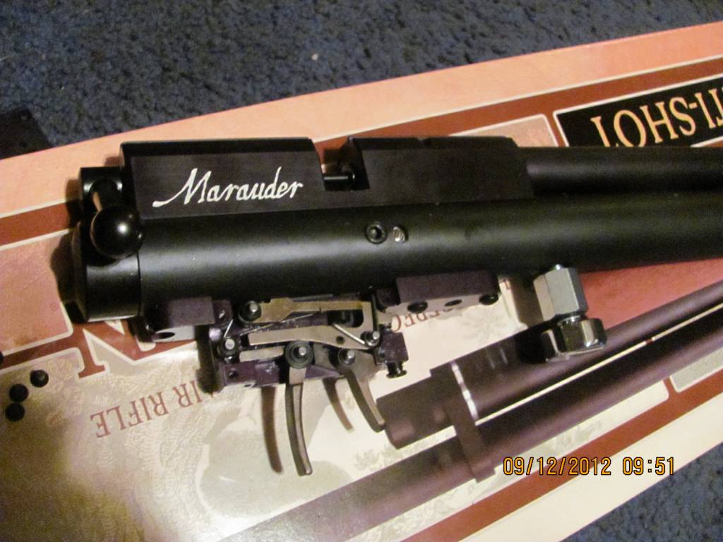

On the trigger you need to pop the cover off and remove (unhook) the torsion spring. A proper size bushing would be nice but you can just un-hook it & leave it. Then adjust and you will have 99% of a match trigger. The 1st 100 Marauder had a "match trigger" and the addition of this "lawyer" spring is the difference. Enjoy.
I am sure there would be youtube videos on it.
edit: here you go same thing just someone mounting it on a 2260, show spring well.
