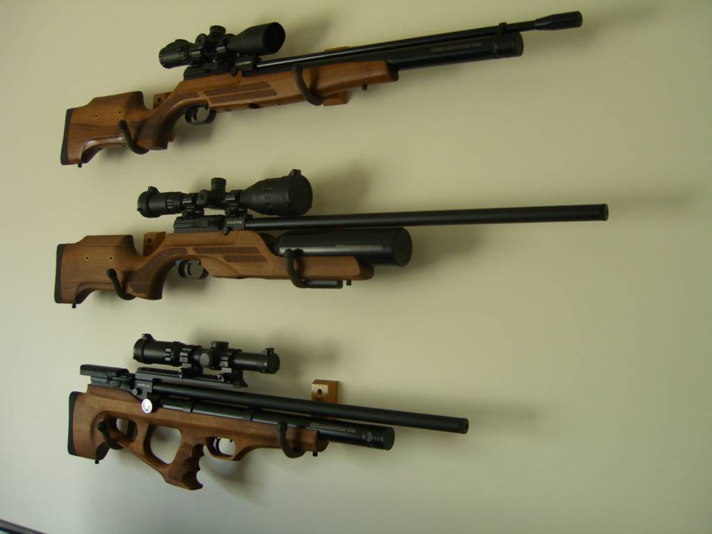

no issues here other than it shipping empty and being kindof a pita to get air started .. sounds like you got a lemon .. i liked it so much i got the whole set lol ...
Very nice collection, the trouble with the craftsman series is that it led me to the Kral website, they have design details I like better, the Puncher Knight would have been my first choice, love the stock on that beast.
