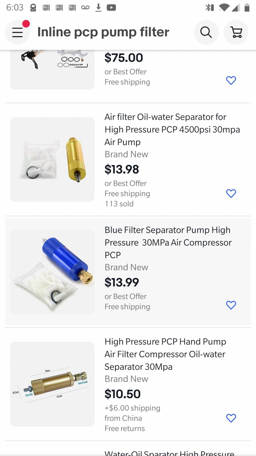

    Do yourself a favor and buy one of these for your hand pump. Buy some desiccant beads off Amazon and fill the inside with them with a small filter on each end. Sometimes you need to trim the filters to make room. It doesn't take much beads to work. After you pump it up a few times take the beads out and replace them with new ones. I pour my old beads in a pickle jar and save them up until I have a good amount and then put them in the oven on the lowest temp with the door cracked. This dries them out and they can be used again. It sounds like a pain but it's actually no big deal and will keep your gun bone dry and functioning properly. Welcome to the sport my friend. That gun is a great place to start. When you are ready for an improvement hopefully when your warranty expires I believe Troy hammer can tune that thing and make some serious improvements. I have heard that once he's done working on those kral guns that they are butter smooth and even more accurate than before. I believe that Benjamin uses kral guns to make the Cayden and just add thier proprietary stocks to them. That's why I think Troy can improve it. I could be wrong about that tho. At any rate welcome to the dark side my friend!

      I bought one the same day I bought the pump. Good tip on the desiccant beads... I'll pick some up.

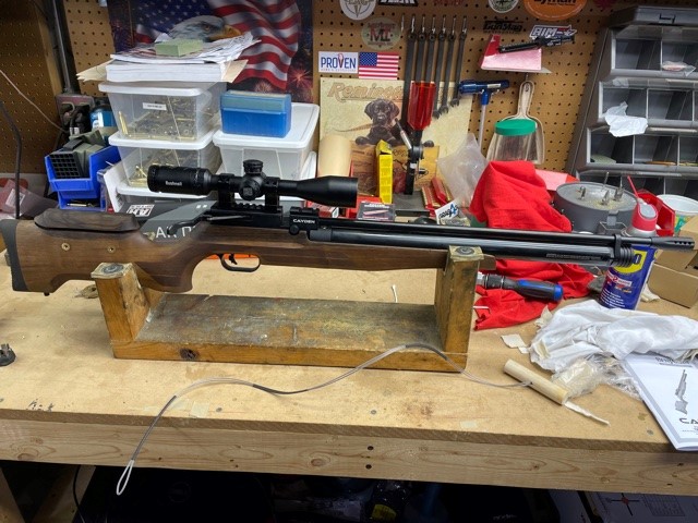

          Well, it showed up today. Pulled it out and gave it the once over, cleaned the barrel and mounted my scope...
          Loaded up a magazine with some 19 gr. Benjamin's Domed Heavy's I ordered for the purpose or initial shake down , scope zeroing and get some chrony numbers on high and low power. I'm saving the JSB's and the JSB variety pack for when I hit the outdoor range later this weekend.
          Initial thoughts....
          Trigger is excellent, cocking lever is very smooth and well designed, very ergonomic Turkish Walnut is very nicely figured and the pistol grip has a very good feel to it.
          . Accuracy at 10 meters(10.94 yards) is like a laser. Basically 1 pellet holes per 12 rd groups. Everything I've seen on line ihasbeen spot on.
          She is loud at full power and has some bark, A DonnyFL moderator is certainly in the near future. One of the reasons I chose this was the adjustable power. I dialed it down and it was much quieter and not as hard on my wood back stop. This was definitely a good choice.
          My Chronograph battery was dead, So I'll have to pick up so 9v's tomorrow and continue testing..

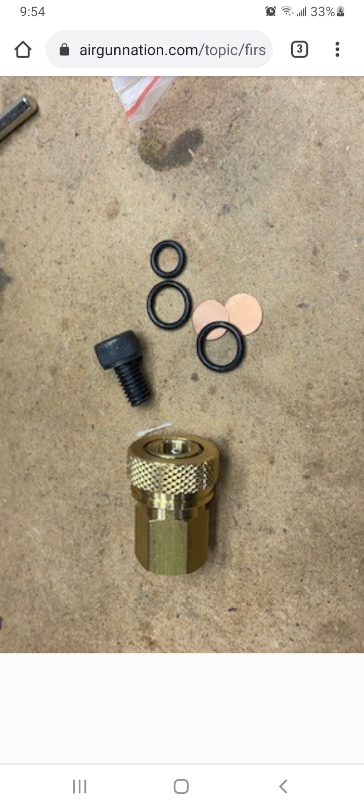

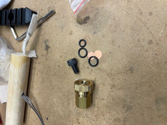

          I did receive a bag of parts, and the owners manual does not describe them or there use at all, if anyone has any ideas...
          Definitely
