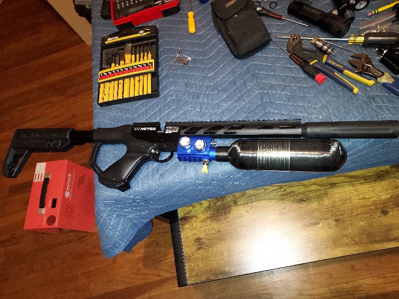

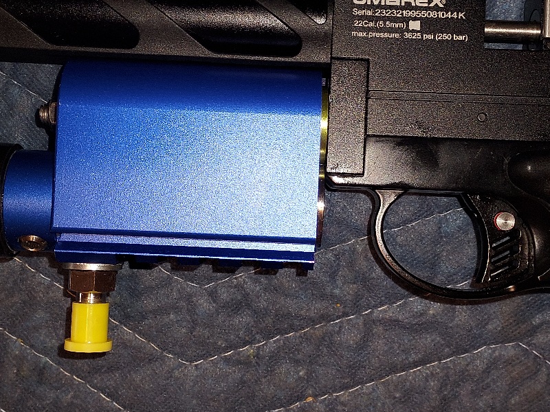

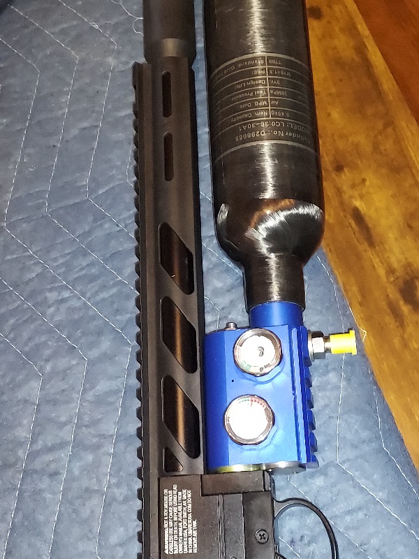

KatoKevin454 do you think this will work to add plenum- would use a smaller length bottle- adds 2 3/4 inch to length.
yes, but I'd try to keep the weight down, don't want to over stress the fittings, too much and they could break, that's why I used the carbon bottle,
the longer you make it the more stress put on the fittings, leverage, so try to keep it short, I used a 500cc bottle because that's what I had already, I think the 200cc or 300cc Carbon fiber bottles are perfect for the application
