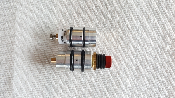

Installing the reg was easy. I have had the original regulator out a number of times to adjust. Installing this Huma was no different. Here's the HUMA next to the FX regulator. I was surprised at the size difference.

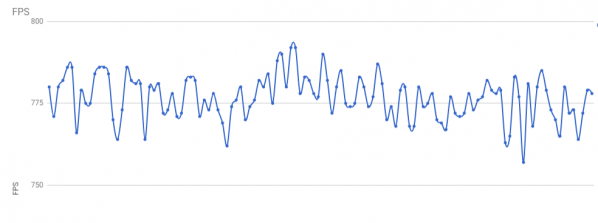

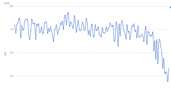

And here is the line graph of the full 156 shots:
And when I omit the last two mags and "only" include 11 mags it looks a bit better:
Conventional wisdom is that the regulator consistency will improve as the rifle is shot more. :)

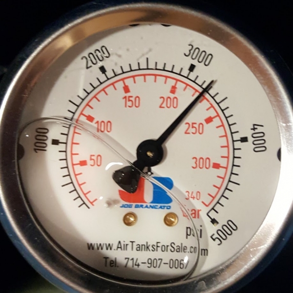

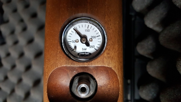

Oh, here are pix from the starting pressure at the gun and JoeB tank.
By the time I got my stuff setup outside (cold temps) the rifle pressure registered about 212 BAR.

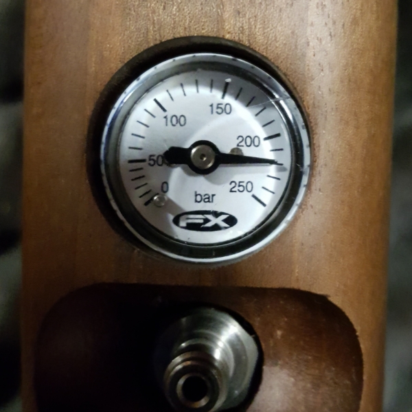

And ending pressure at the gun:

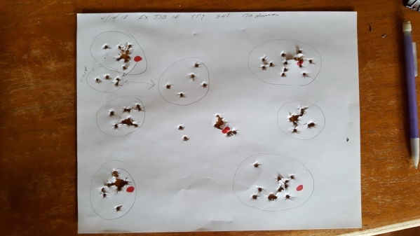

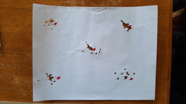

Targets and chrony data. Targets were at 50 yards on a relatively blustery day:

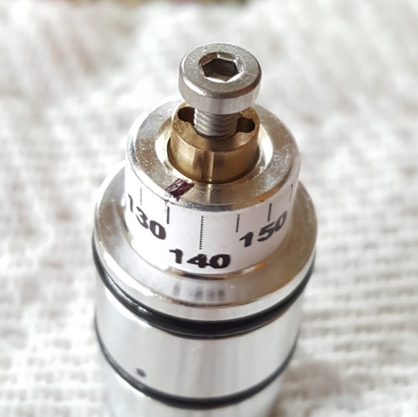

OK, I see what was going on!

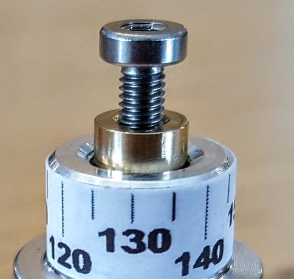

1) The regulator adjustment screw was WAY easier to turn than I expected. I (thought...) that I was super-careful NOT to move it. Well I did accidentally move it to a much lower setting. This likely happened when I screwed in the set screw on top of the regulator.
2) The instructions say there would be "a very fine set mark" on the side of the screw. I thought that I identified it and it corresponded with 140 bar.
Actually the mark is a vertical line milled into the side of the brass. How I missed this the 1st time around I will never know! So there's a small dot on the brass above the 140 mark which I incorrectly thought marked the pressure:
Here's the real mark which is now set right at 140 bar. I drew a line on the top of the body to mark the location of the hole lower down on the body. The instructions said to line this hole up with the barrel.
With this set correctly and with 3 turns out on the hammer screw, I got this one-mag string (sorry ran out of time to shoot long strings):

The lesson learned here for me is that the adjustment screw is NOT like the FX at all - it is WAY easier to turn than the FX. This HUMA adjuster can be turned with just your fingers... I'm sure when I screwed that little set screw I dropped the setting down. Right down to 110 BAR!
:-O
I can't wait to get filled-up and shoot a full string now that it's right about where I want it!
"jking"Just to confirm, the silver screw stays in place and is loctited to the brass piece? If my Wildcat or Royale ever have any issues I'll probably try one myself.
Jimmy
Hi Jimmy,
Nope, no loctite. It's just screwed in for the sole purpose of giving you something to latch on to with needle nose pliers when you want to pull it out.
