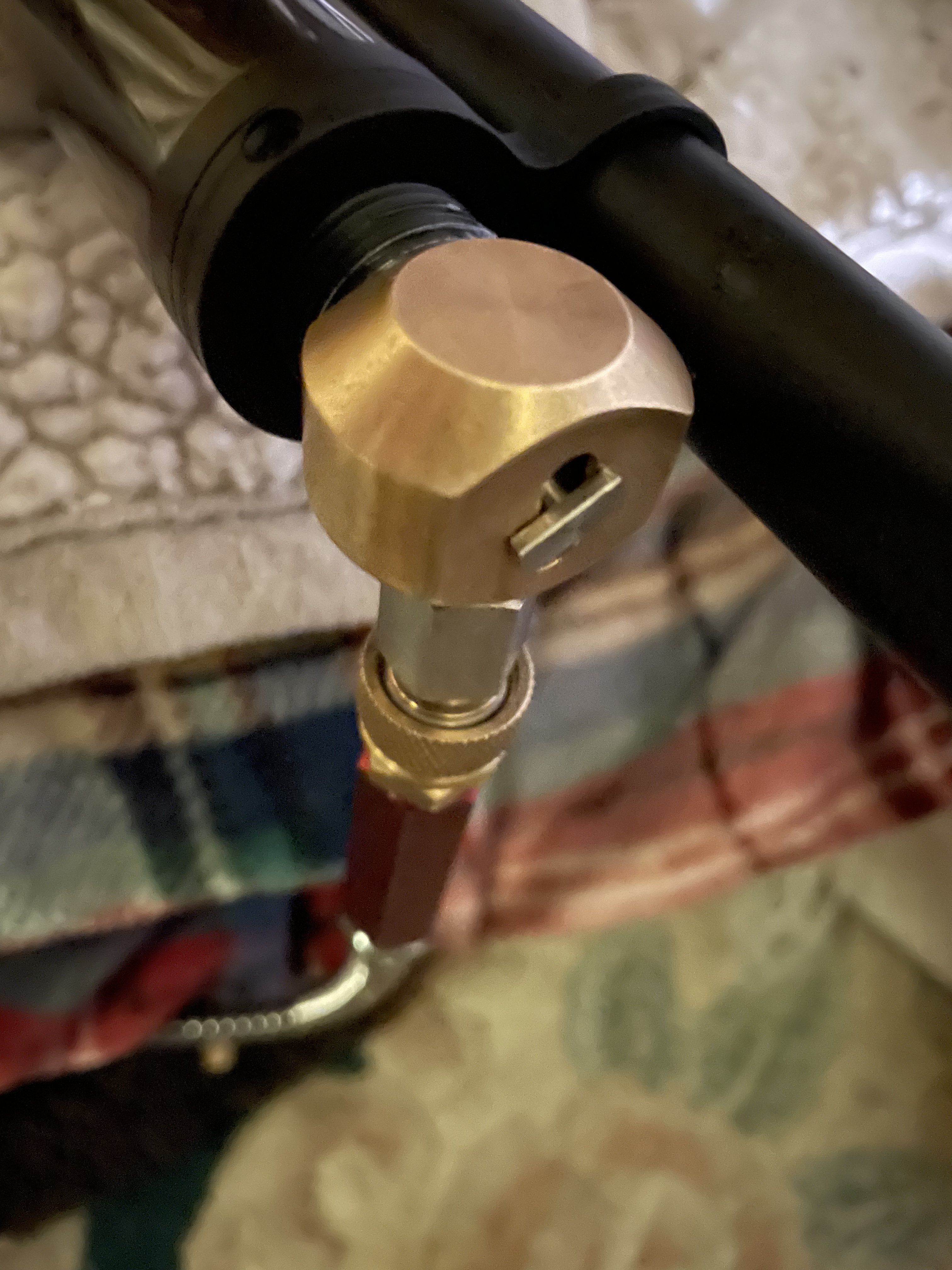

Got my s510 xs about a month ago - saturday while I was pumping it, as soon as it got to around max fill, I started hearing a tiny leak out of the fill probe (coming out of the back hole)
hoped it was a faulty connection on my part, but figured it was the o-ring is getting bad
Last night, I went to refill the tank, but this time it would start aggressively seeping air with each down stroke through the back of the probe adapter at 200 bar (50 bar less than it was 2 days prior)
I work with pumps and water connections for my day job, so I’m pretty familiar with how o-rings function, I would say this is a typical case of an o-ring progressively getting worse (plus this is a lot of pressure)

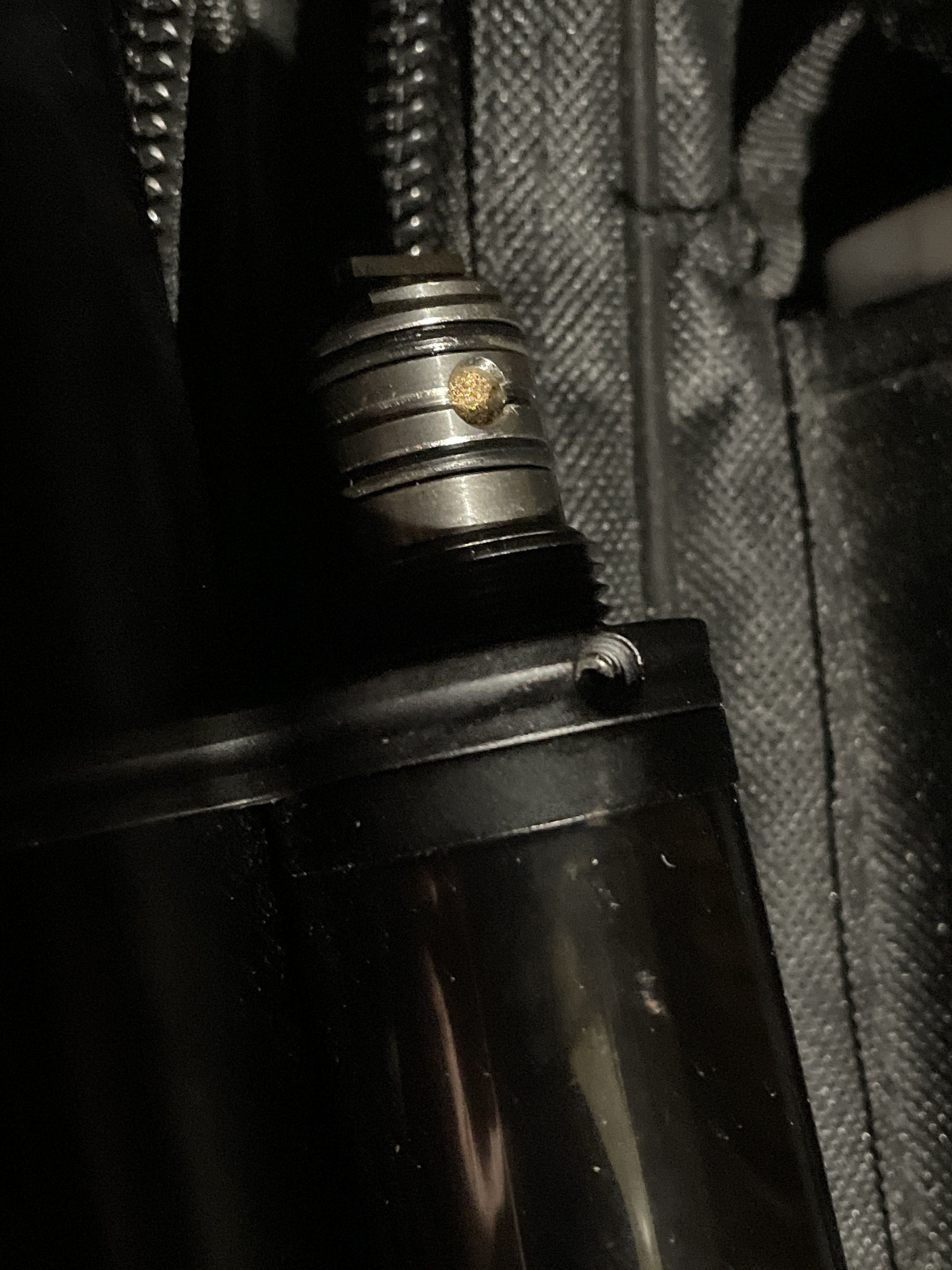

The two o rings on the fill adapter are NOT the breach o rings. The are part # S474 or size 12x2 NBR 70.
I'd be surprised if it was those. The fill adapter o rings on my S400 have been going strong for about 5 years. But, its possible.
I would check the BSPP adapter that's on the brass fill adapter. Unscrew it, Teflon tape the threads, crank it back down and see if that fixes it. Thats usually the issue when you have leaks while filling (in my case at least).
There are other o rings that could be leaking, but if it holds air after you've disconnected it from the fill source its likely the ones you've pinpointed or the connection.

Gonna test in a few - it was an issue when I first started pumping, getting the o ring on the Bspp adapter to seal (so nope, no tape and that definitely could be an issue.) The only question with it, is I don’t feel any air around the air Venturi bspp adapter, only air shooting through the back hole of the AA fill adapter
It holds air very well after a fill, which makes me think it’s not the actually probe screwed into the tank. I think if it’s not the bspp adapter, it may actually be my fault 100% the brass AA adapter has sharp edges that I may or may not have been cautious of when sliding it off the o rings *_*
