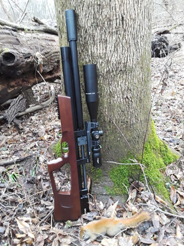

Initial impression: 5*
This gun is off the charts.
Accurate👍
Trigger👍
Powerful👍
Compact👍
Light weight👍
Balance👍
Aesthetics👍
Air Efficient👍
Backyard Friendly👍

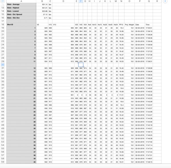

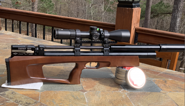

Looks good whats the barrel length, Is it tuned or OTB? Tell us more...fps, groups, etc.
LOB-18.7 inches
Straight out box:
1549416668_12410947105c5a38dc748f07.24836798_Taipan Veteran Shot String 1.png
Note: Shot number 20 is an outlier. Pellets straight from the tin.
FPE--->34-35
Shot string of 40.
250 bar fill. 155 bar after 40 shots.
