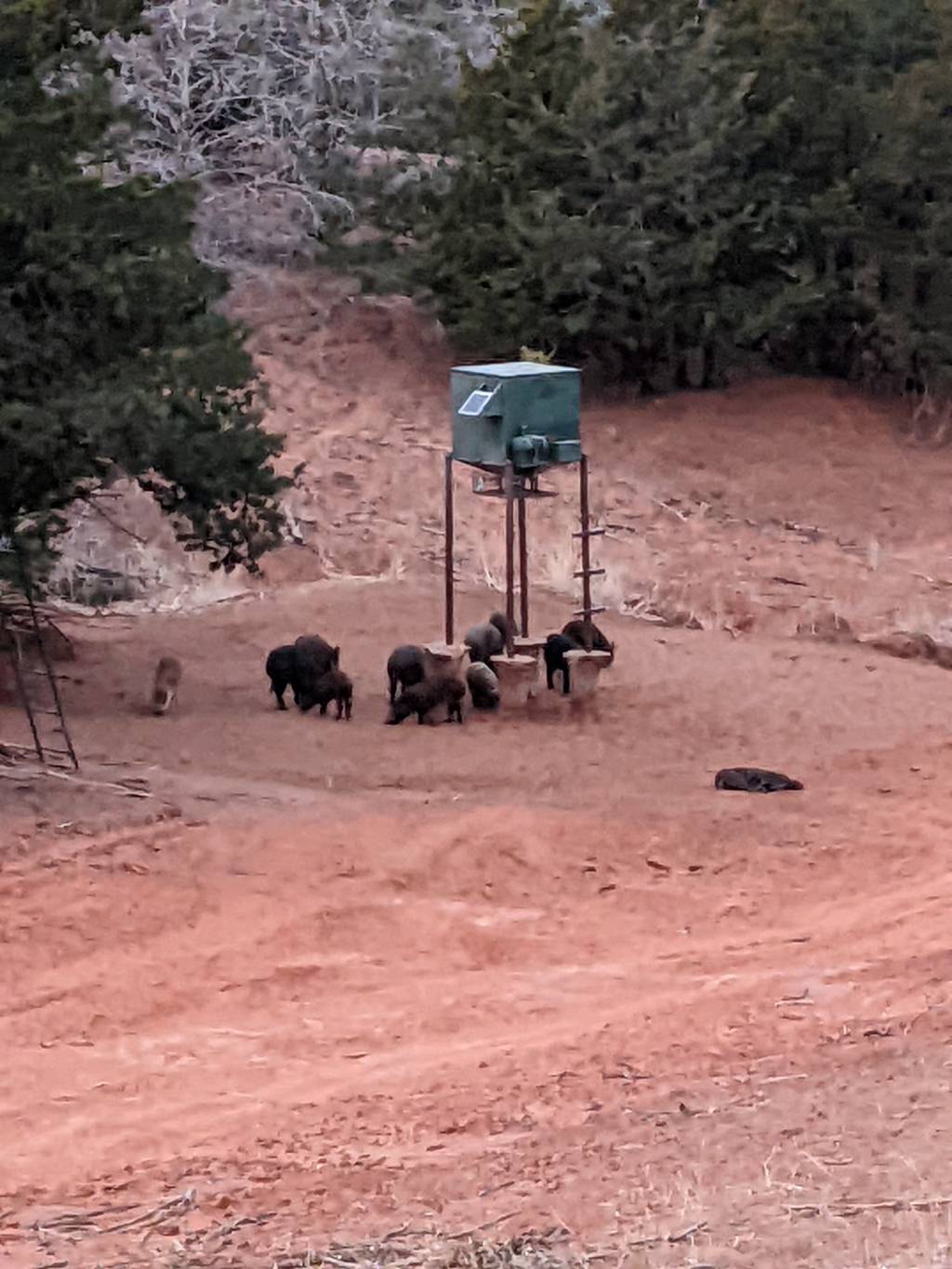

First Hog Hunt AEA Challenger 457
Didn't get any footage... Got 8 hours from home to figure out that my GoPro was on my desk in my office. It was really well charged when we got home...
But 457 shoots awesome with Hornady Round ball. Ear holed at 67 yards.
