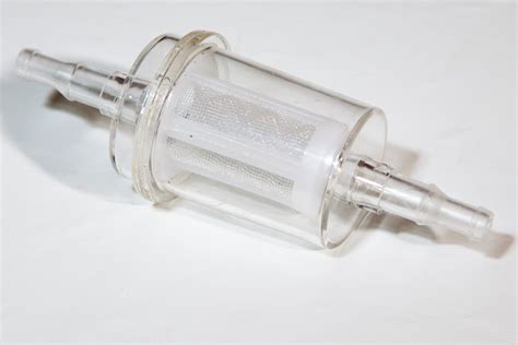

That's a pretty cool idea, do you know if the fittings are the correct size for the water lines?
Well no .. I just used it for example sake .. I was just also looking at inline aquarium water filters and seen one look handy but it was a uk item lol ..
Like this
( Looks like a mower fuel filter 🤔)
Anyway you got to match up you sizes needed ..
Here's something
I'm thinking another good flush should do the trick. There was probably still some debris in the system after the first flush that finally was dislodged. It's a closed system, so once all the crap is removed, it's not likely to have new crap introduced to the system like a fuel system that has fuel added on a regular basis.

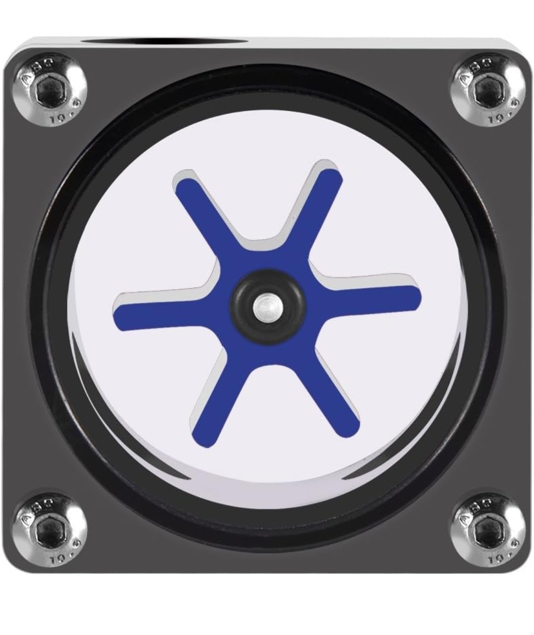

Nice. I like to go overboard on things like that. Even though I sit at my compressor as it fills, watching a pressure gauge for the moment to stop (no auto shutoff on my compressor) it would be cool if that flow indicator had a way of visually, like an LED or audibly indicated a stoppage. Either way, I like it. Somebody probably makes one.
When I had an Omega Aircharger I always looked into the reservoir tank two or three times per session to see the water return line flowing coolant back into the reservoir. I don’t recall if it had a thermal cut off in the event of over heating.
I have some fiberoptic sensors that could be rigged on something like that to beep like a heartbeat that could let you know it’s rotating.
