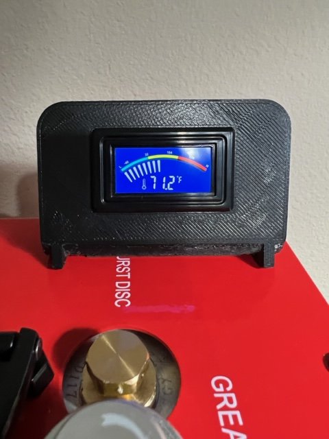

Temperature gauge? On a GX-CS4? I don't see one on mine - please send me a photo!
I added it myself. The holder is 3D printed, I got the .STL off Thingiverse.
I attached the probe to the top of the compressor, opposite the temperature sensor that feeds the Controller Board.

Thus the reason I like to add a temperature gauge to these compressors that don't come with one. Sure, it has a sensor attached to it, but I have no idea what temp that's set at and if it will prevent damage. Maybe it's a control thing, but I know the normal operating range of this compressor, so when it started approaching it way before it should, I shut it down and starting looking for the reason why!
