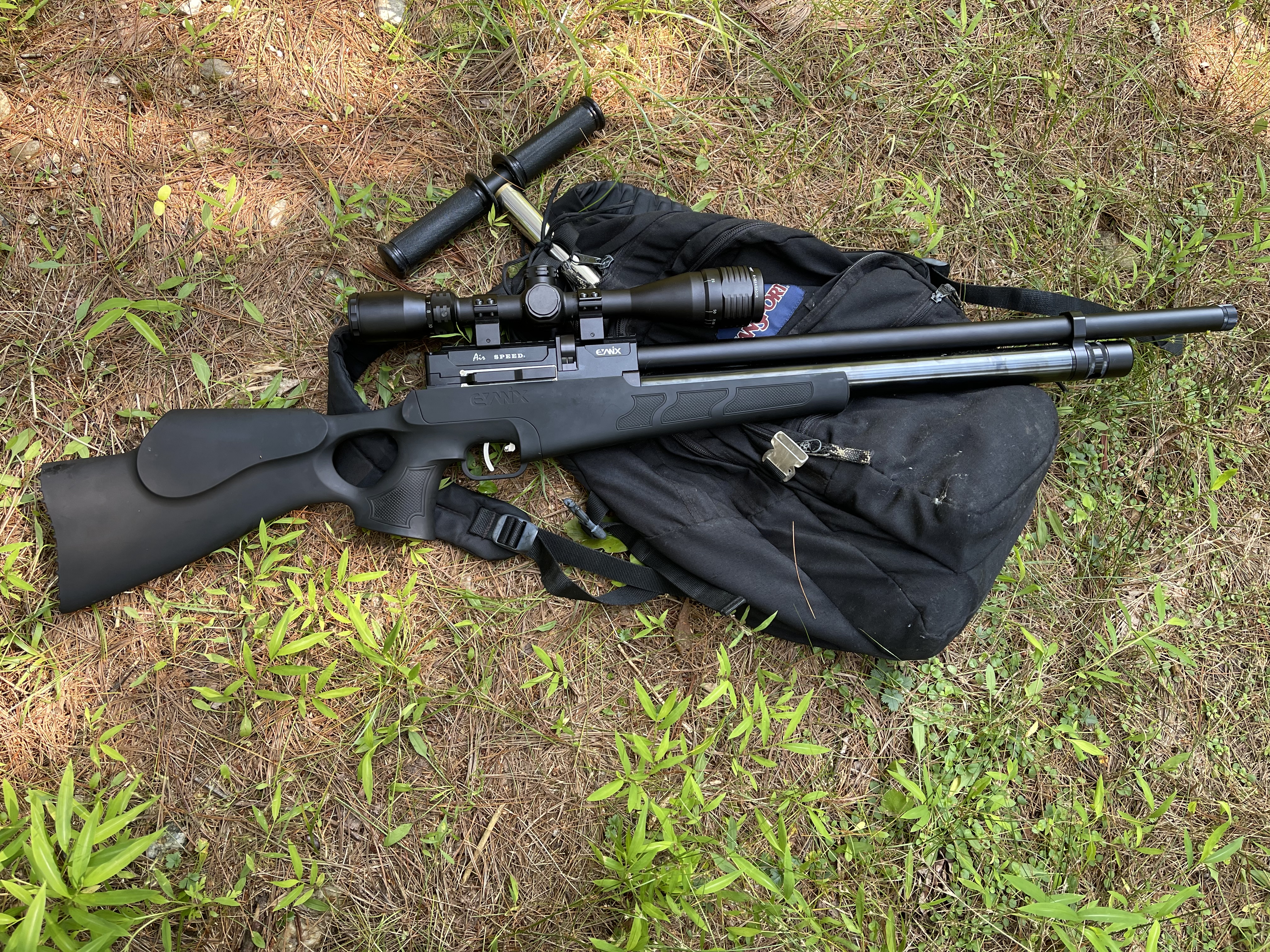

First hand pumping
I felt that pain brother!!! When I bought my first pcp from a now good friend I didn’t have a way to fill it. He suggested a cheap hand pump off eBay which I quickly purchased before the arrival of the riffle. I thought hmm looks like a bike pump, shouldn’t be too bad. Yup it sucked! Really got hard to pump as I approached 200bar. But it got me going. Then I sprung for a yong heng compressor, again on eBay. Best investment ever… definitely suggest a water trap if you get one. Stay sharp man!
