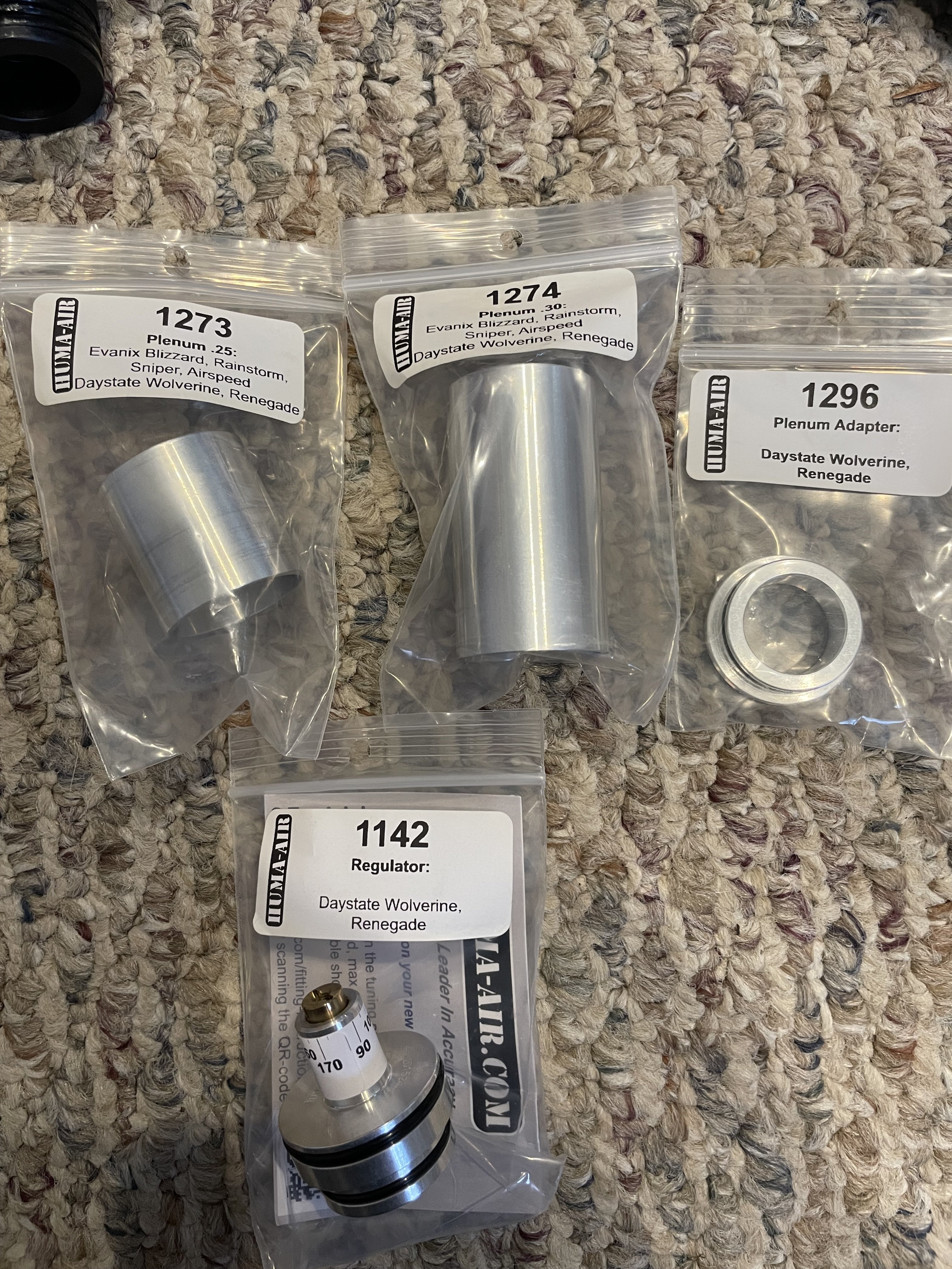

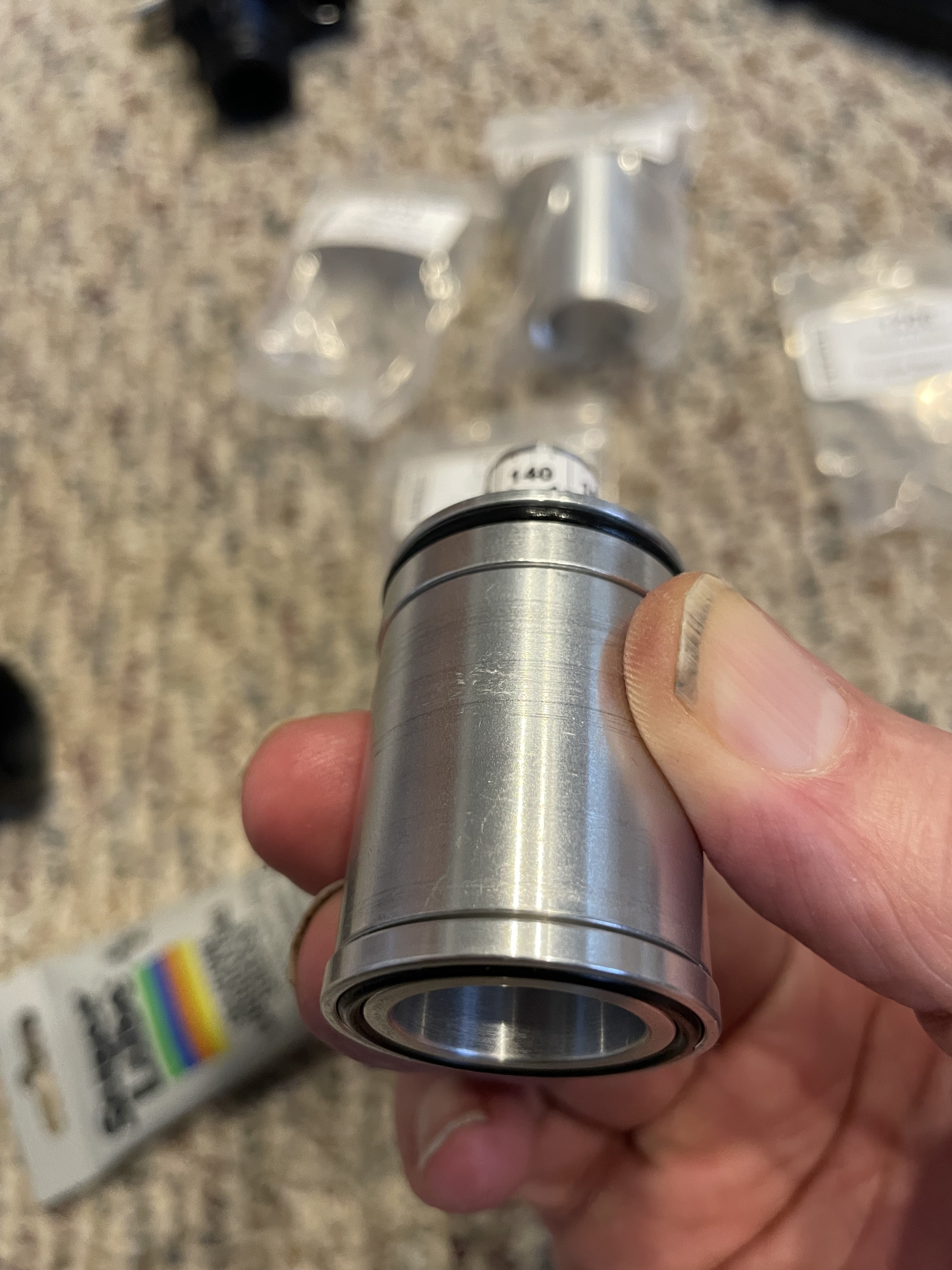

You have definitely convinced me not to swap calibers between Wolverine and Renegade because the Renegade is set up with a big plenum because its a tube gun - bottle Wolverines don’t have the ability to use this Huma reg & plenum.
I’m going to stick with the stock hammer in .25 Renegade HP for now - and do any further velocity tuning via hammer spring.

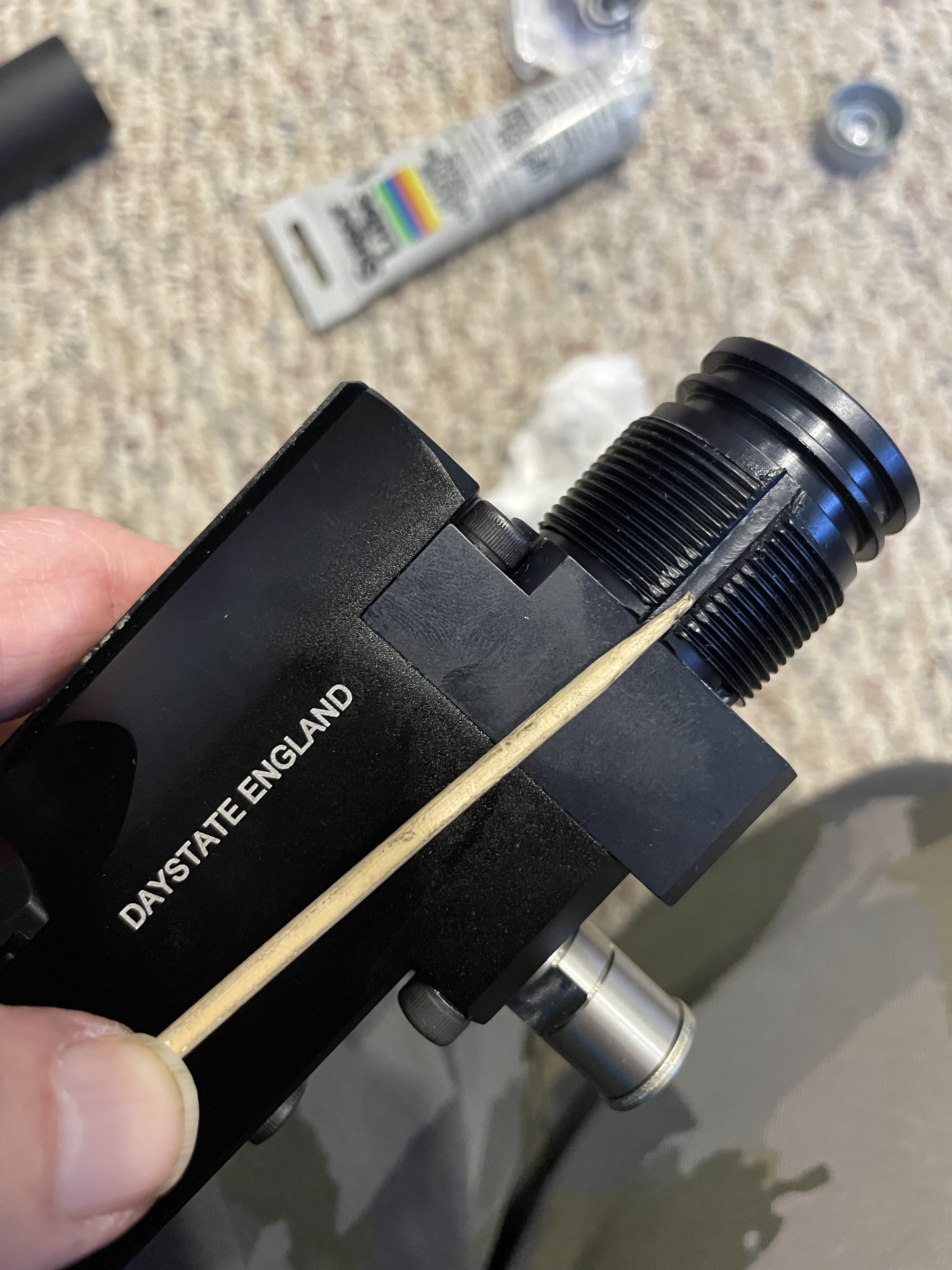

One cool thing about adding the reg to the Renegade is that that Renegade air tube is stamped with 250 bar SWP and the action is stamped 220 bar. Since I regulated with the Huma, the action will only see 165 bar - so I can utilize air tubes full 250 bar capacity if desired - that alone will expand the shot count.
You can see from the picture that Daystate “pre-vented” the air tube to provide for regulator installation via the thread cutout.
