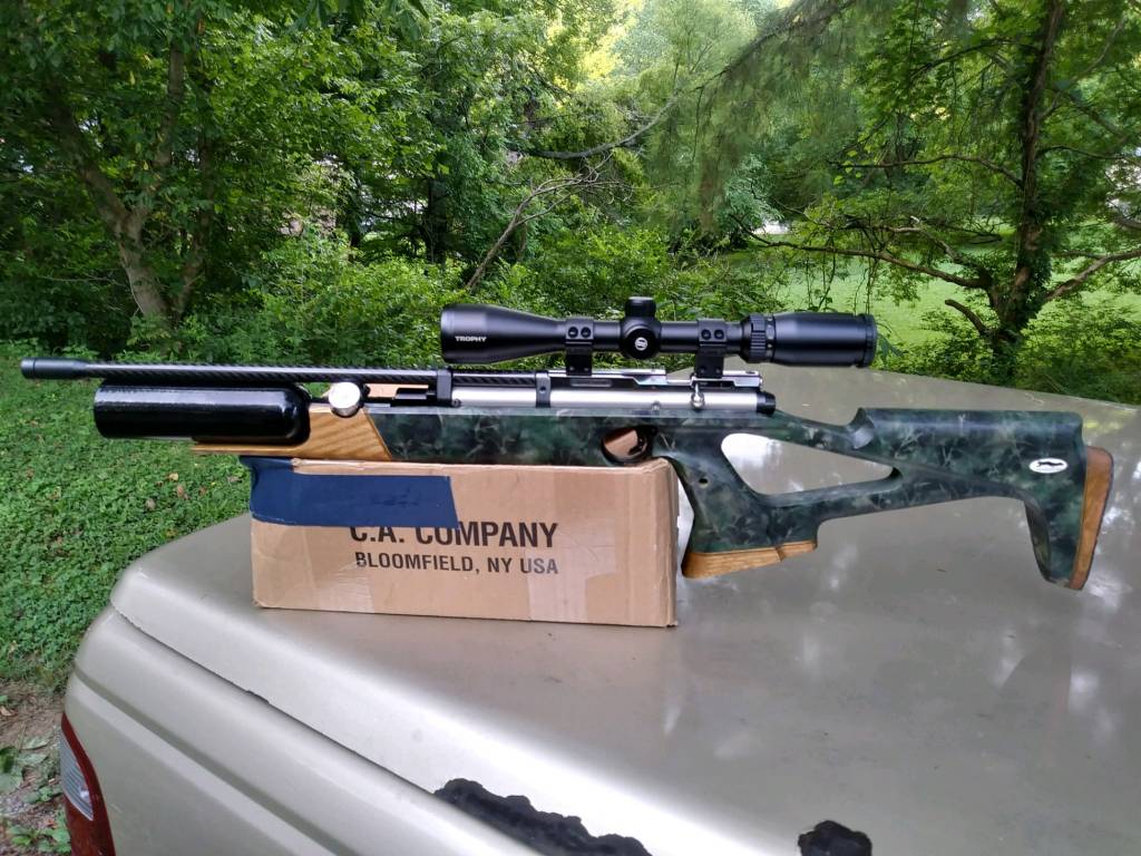

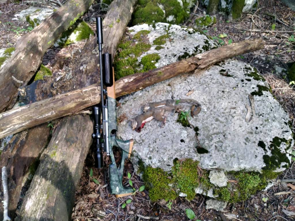

I think some folks may be tired of reading about it, but my ag budget doesn't allow for Impacts and high dollat bullpups, so I decided to "roll my own"
It's based on the Crosman 2250 format, but the tube is one of Don Cochran's 2250 PCP tubes and his balanced Powerhouse valve, coupled with a JDS Airman bottle/dropblock& 1800 psi regulator.
The Cothran valve is really almost too hot for just a 22 pellet gun, it's pushing the 14.6 gr FTT at 950 or so for 30 shots. Me Like!
