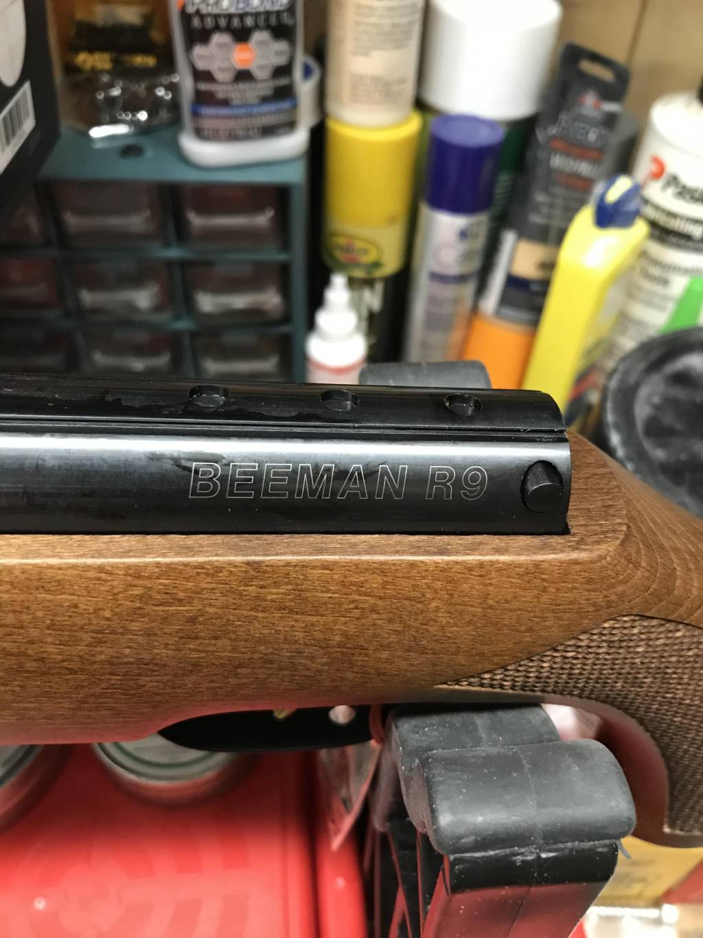

I 2nd what JohnL57 said, that’s a good deal on a very Nice Rifle. I just got the Beeman R9 ( same gun essentially) in .177. For your 1st quality Springer - this would be one of your best choices.

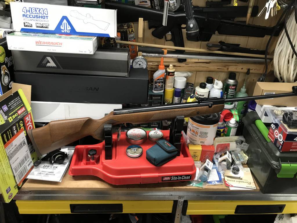

I just got my R9 - I haven’t put it through it’s paces yet, others can comment on it better than me. Most of my Springer shooting outside is around 25-40 yards & I mostly hunt & pest myself. I don’t think the R9 / HW95 would have any trouble with those ranges. So far I only shot my R9 open sights in my basement range just under 10 yards & I was happy with its accuracy & know once scoped I can do better. I got a RWS 54 in .22 earlier this winter off a member of AGN - & will say it’s accurate out to 50 yards easily.
The 54 is heavier than the R9 for sure, so if you were going through woods hunting the R9 might be better choice. I personally don’t think either gun is hard to cock, but the 54 takes a little more effort. Another well known downside to the 54 is it can kills scopes, so far mine hasn’t yet though. I can tell you either gun you choose, it won’t be your last, you’ll start buying more like rest of us lol.
