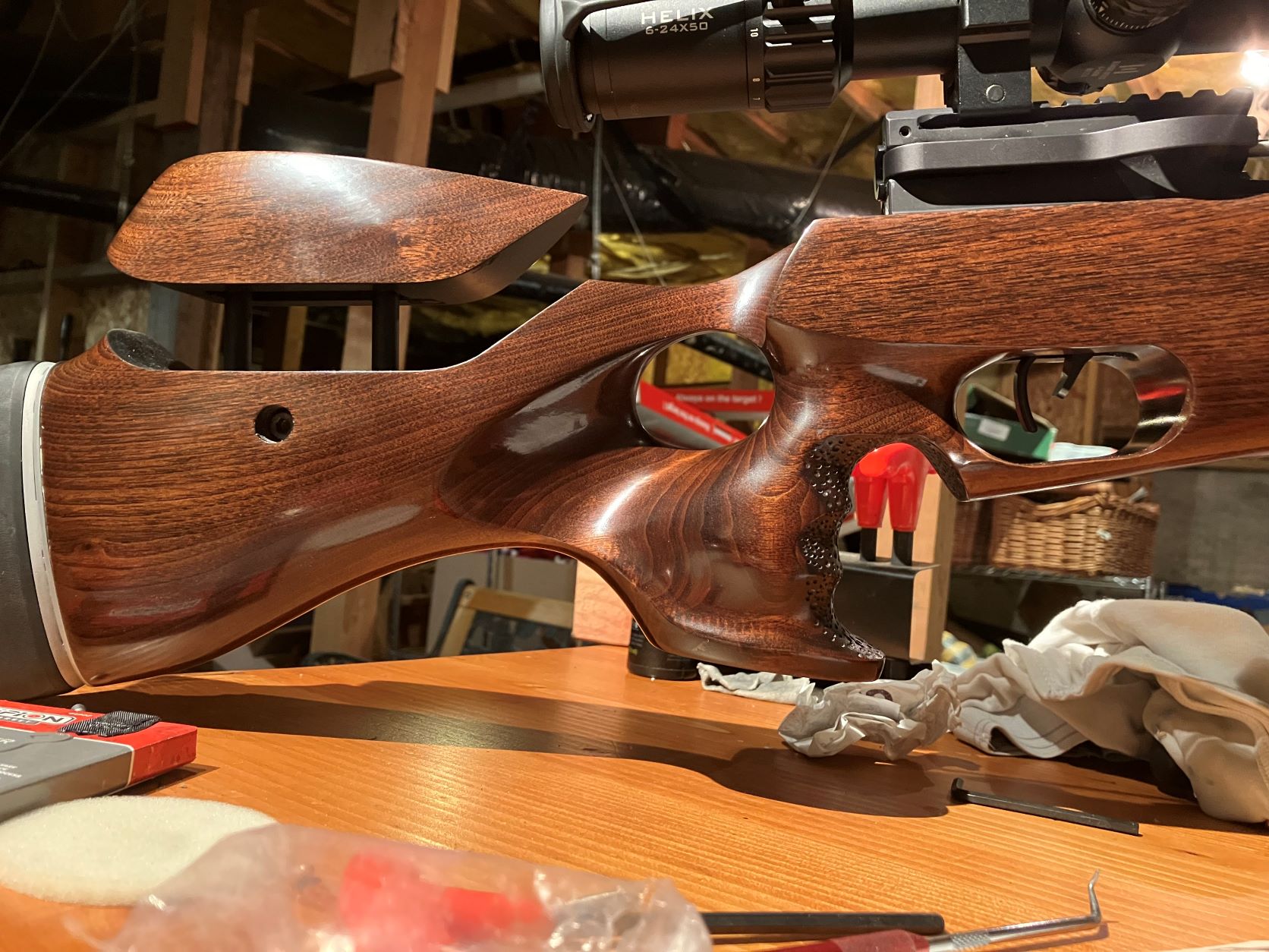

Years ago I had two powder burners that I wanted to refinish the stocks on them. One was just a beech stock and the other was walnut. I did a good job of removing the original finish. Sanded to a uniform finish with “FINE” sandpaper. Then, following instructions from a Tru-Oil article in a gun magazine I applied the Tru-Oil. You put the Tru-Oil on with an old cotton tee shirt, and then when dry go over it with 0000 steel wool. Before applying next coat wipe with tack cloth or shop vac. I did that about 15 times. Once done it was pretty similar to the old Remington lacquer finish on 870’s and 700’s.
One stock was done similarly but instead of tee shirt, the Tru-Oil is applied directly with a finger tip. Takes a bit longer and you have to watch for runs but the claim is that the warmth from the finger tip helps the bond. Not sure how true that is but I did it and looked as good as the tee shirt method.
Reactions: ThomasT
That is one beautiful air rifle. If it were mine I would be afraid to take it out of the basement. You’re like the guys that own and cherish classic wooden boats. It’s just satisfying to constantly tinker with them.
Yeah, I went with the poly finish on top of the tung oil as it would be more resistant to dings or scratches.
