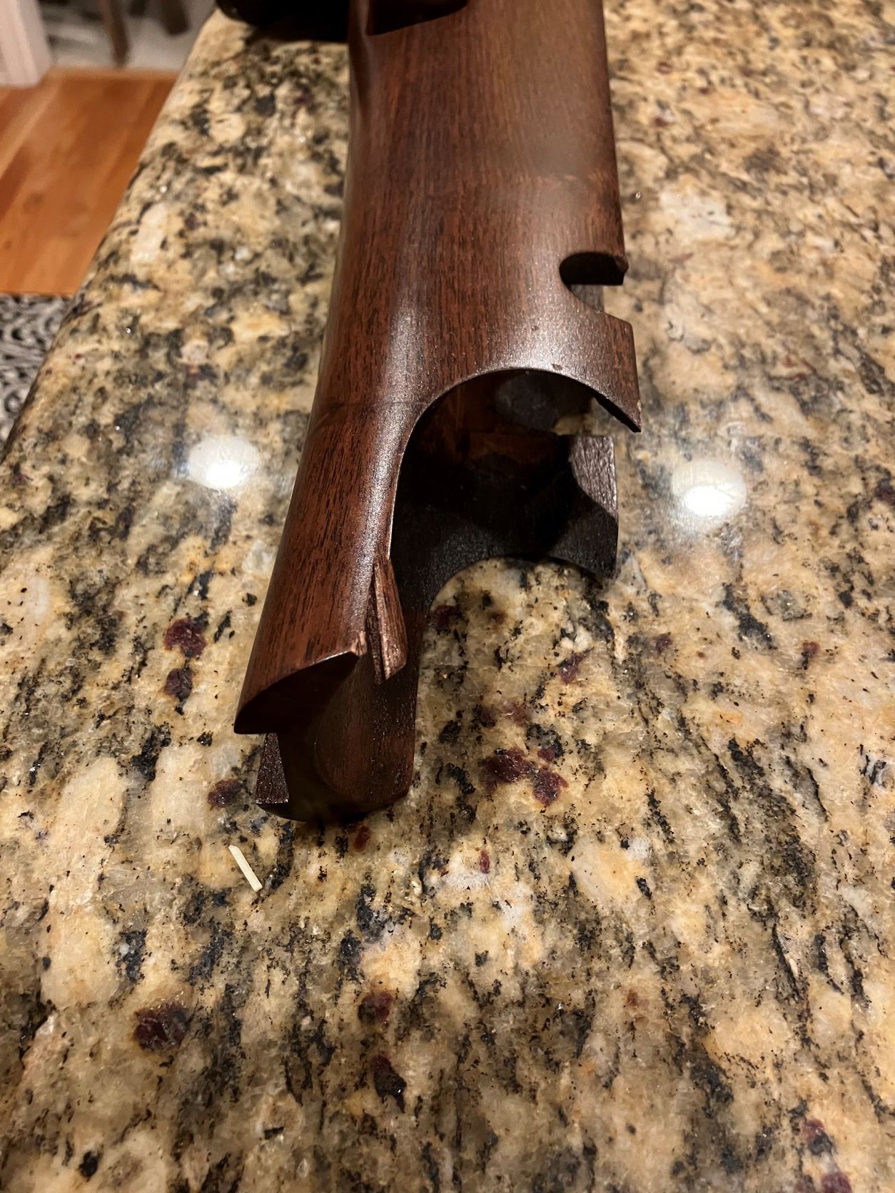

Oh NO! I'm so sorry about that.....😢....that's a HUGE BUMMER! Wouldn't think an amazon driver would do that as they could lose their job if you caught it on video....but, I also could be wrong. I know you'll fix it so no one could tell it was chipped before! It's a gorgeous stock. Maybe a good sized bird perched on it....
Yeah, I shouldn't blame it on someone else - my bad, no matter ......

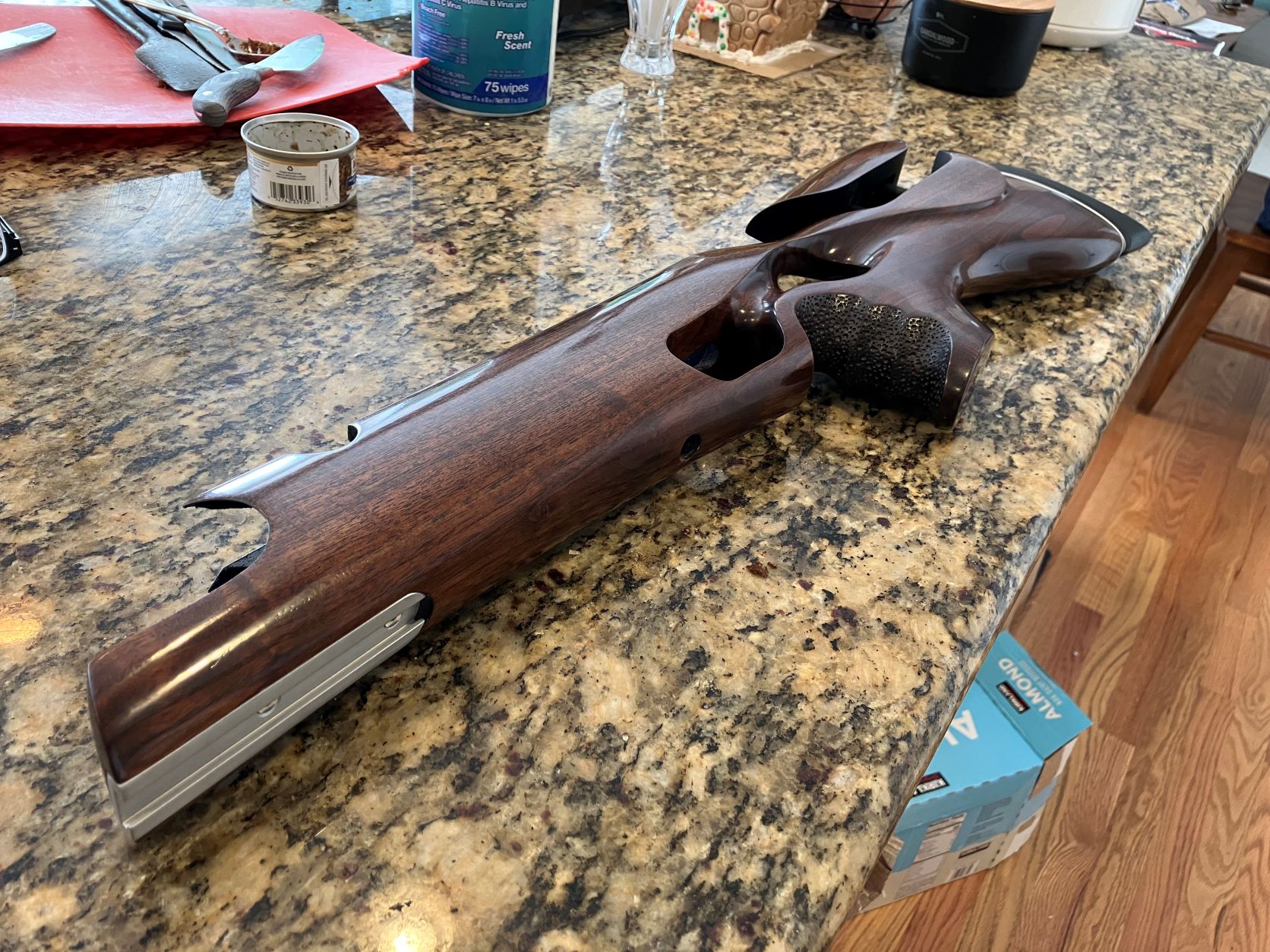

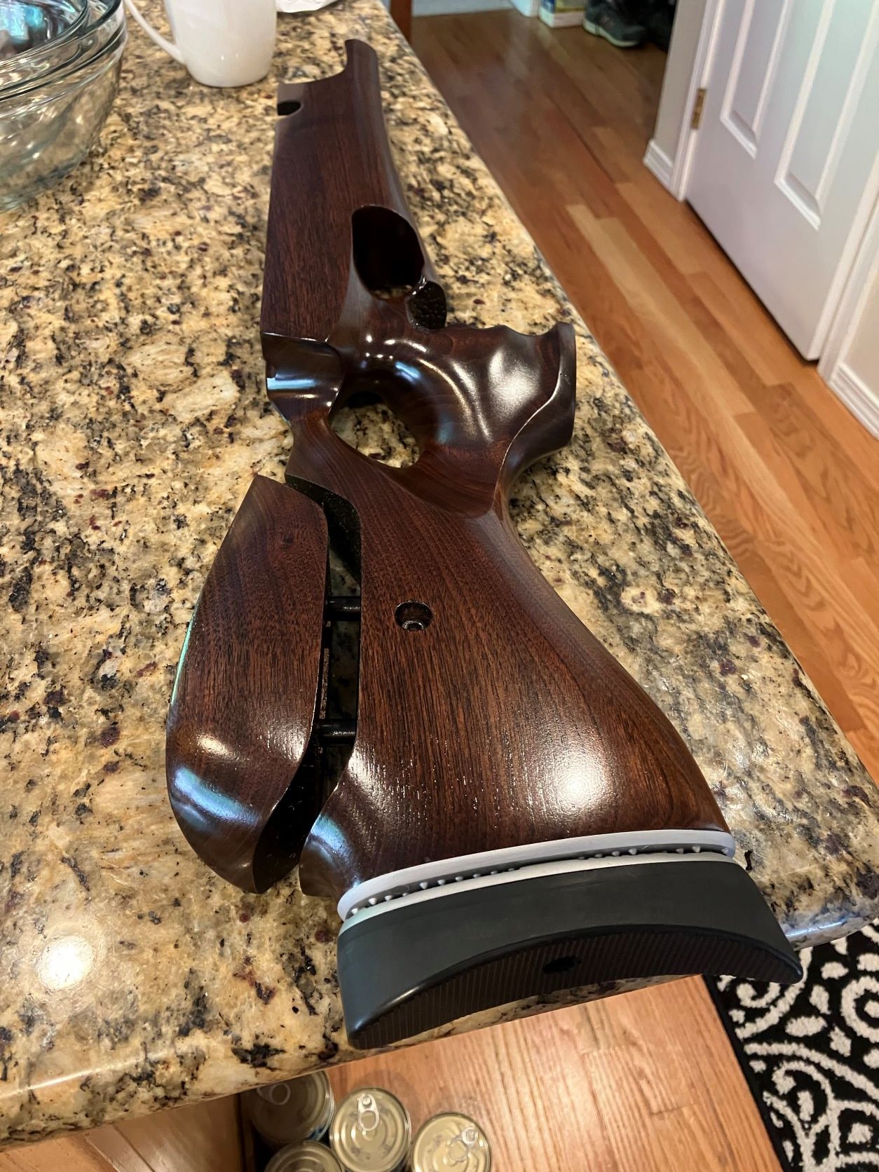

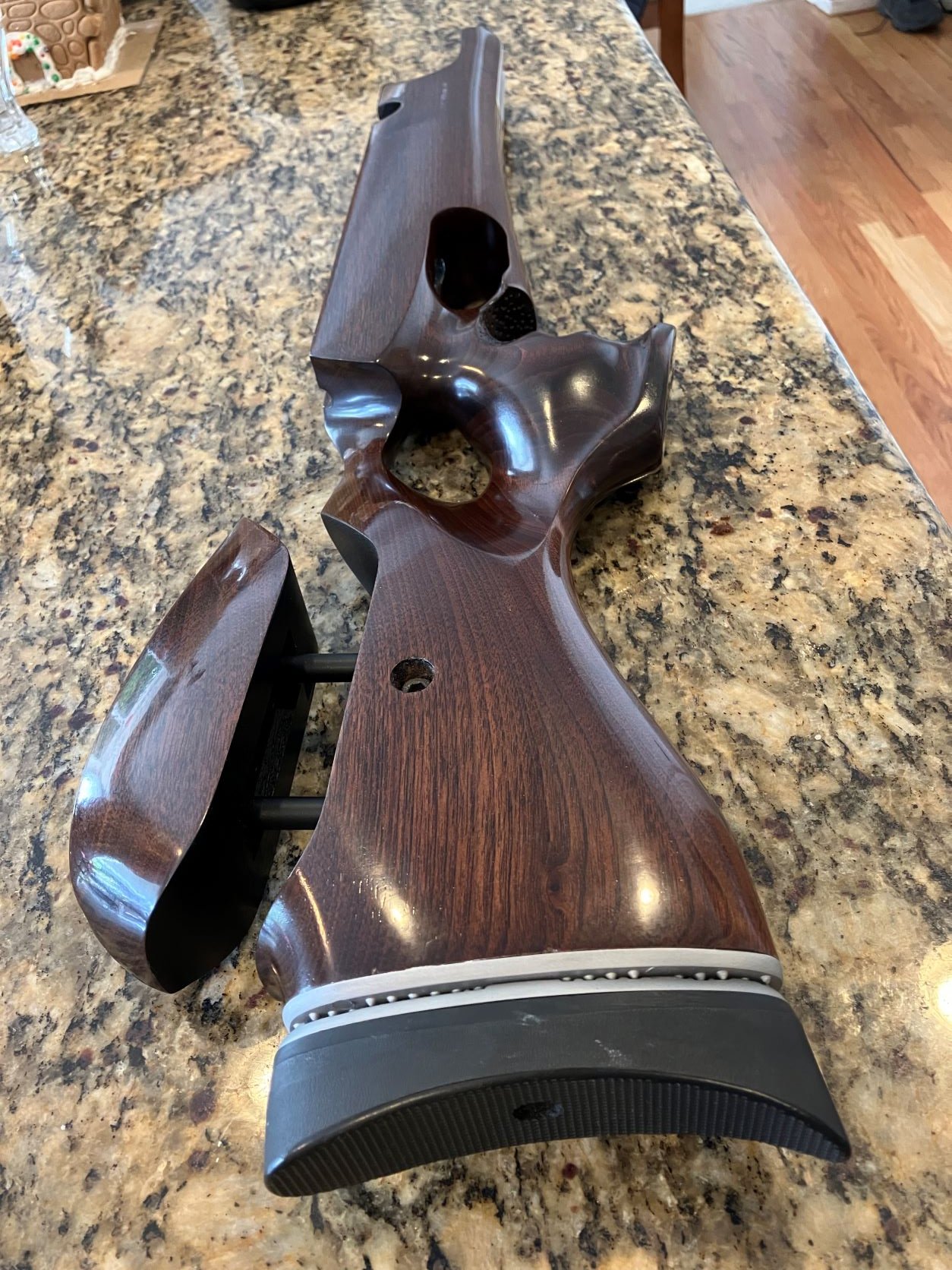

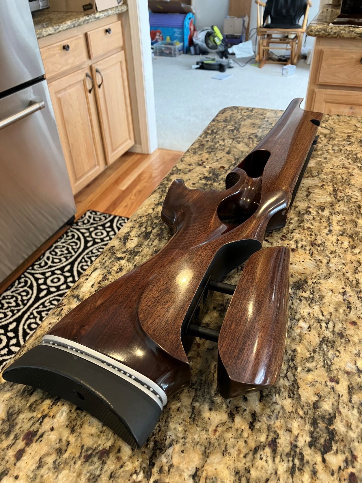

Hey Guys,
One last update before I buff out with Mother's Mag Polish to remove the "slick" look.
Even though the stock arguably looked better with just tung oil, I decided to spray it with a clear poly to add strength to the finish.
I found my finger nails were repeatably scratching the stock when finish sanding ........ as the Walnut was so soft.
I just didn't want to deal with constant, minor denting; I've found the Varathane Poly is a tuff finish (5 sanded coats).

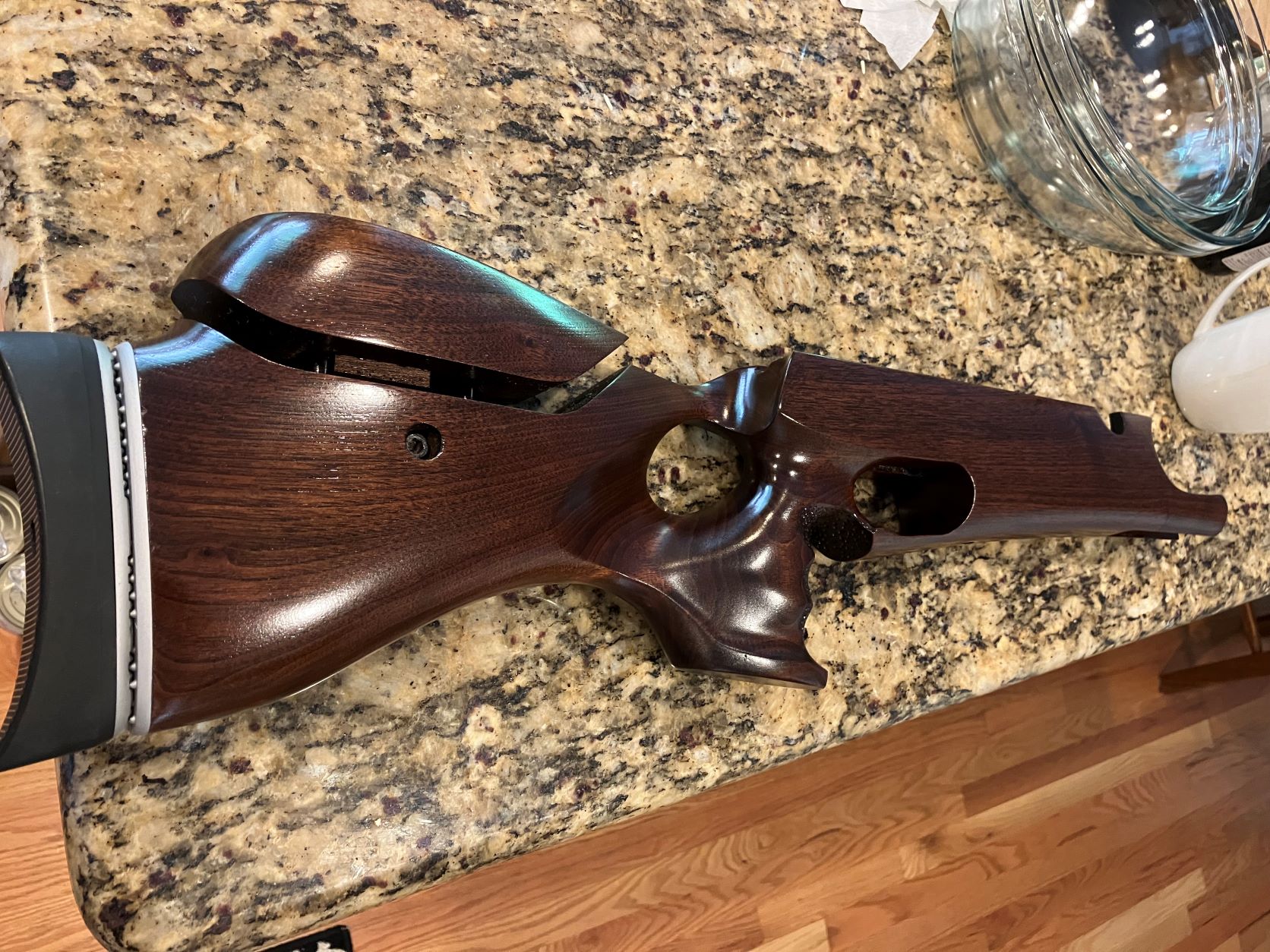

That came out looking great SG!
Thanks ....
Yeah, I decided to go with the thicker (buffed) poly finish over the tung oil, because the wood was so soft - I must have accidentally dented the stock 3 or 4 times during the entire process, plus the chip. The poly finish is very durable relative to THIS wood finished by tung oil.

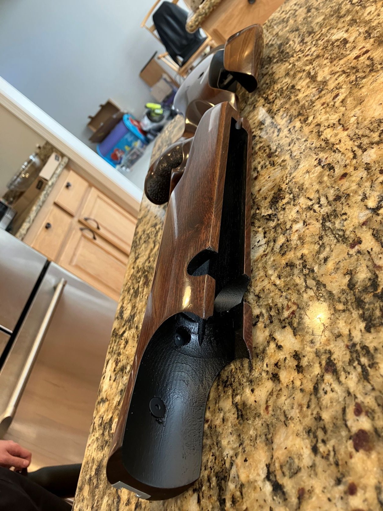

Sprayed the stock in-letting with flat black paint.
