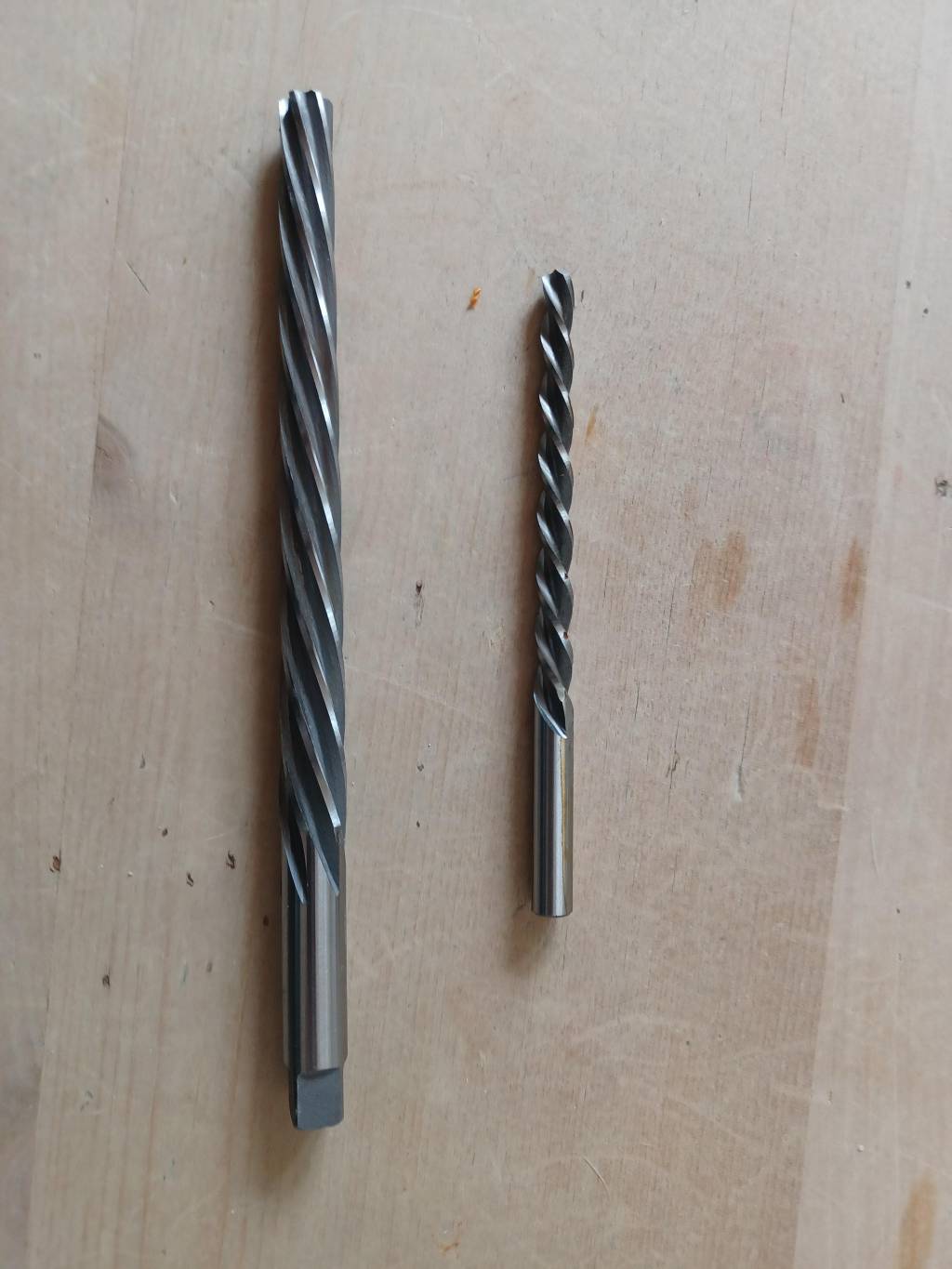

Here are my tapered reamers. They are helical flute to use in the lathe. Size 4 and 7. 4 can be used for both 22 and 25 and 7 for 357.

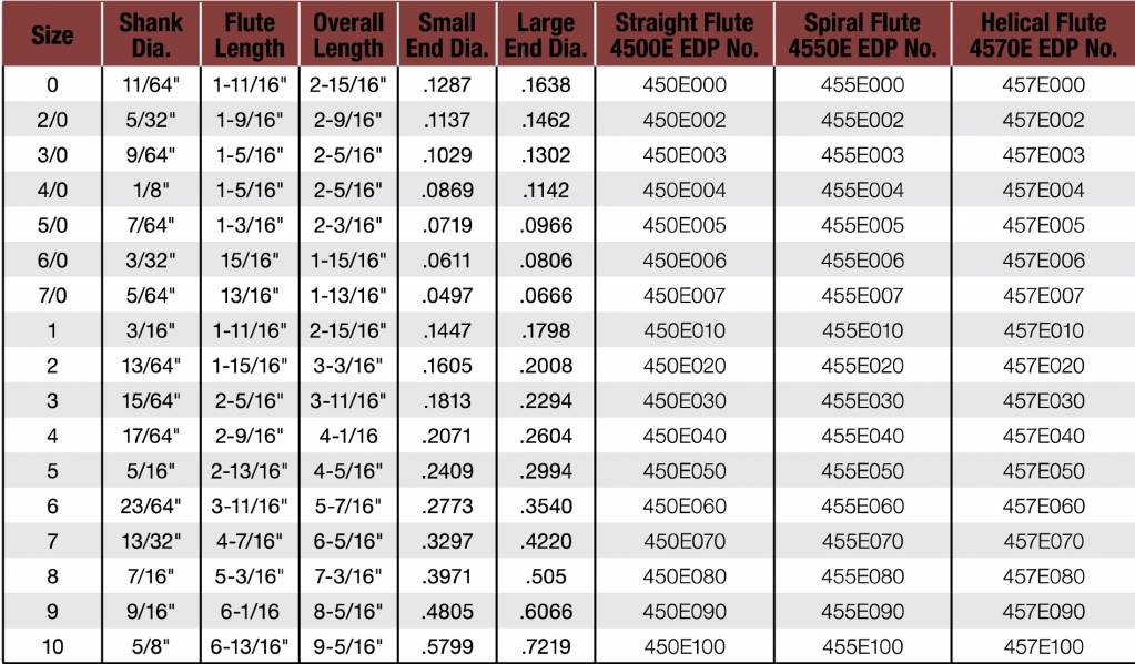

Here's the chart as well.

I have my methods, but it would be interesting to know how you are holding these reamers in your lathe, and insuring that the reamers are centered with the bore and square to the bore.
