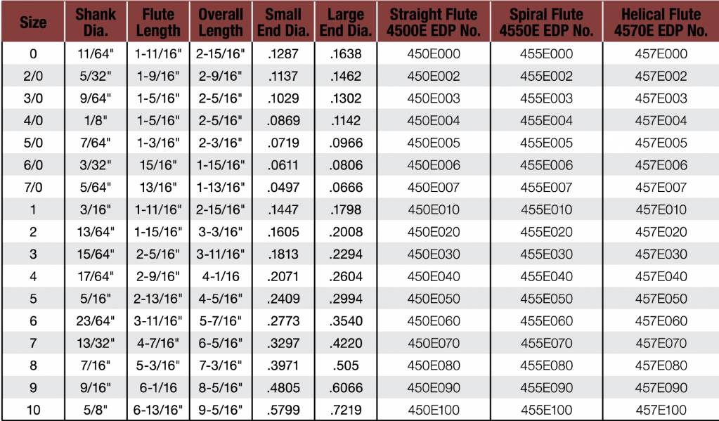

Here are my tapered reamers. They are helical flute to use in the lathe. Size 4 and 7. 4 can be used for both 22 and 25 and 7 for 357.
Here's the chart as well.

Here are my tapered readers. They are helical flute to use in the lathe. Size 4 and 7. 4 can be used for both 22 and 25 and 7 for 357.
I ordered a 3 and a 6 since .22 and .30 are the only airgun calibers I use. Thanks
That should be fine. Just measure and wrap it with tape at the max diameter you want so you don't take it too deep. Shouldn't give you any issues. I like the helical flute it is made for lathe use. I feel like it cuts smoother and removes chips better.
