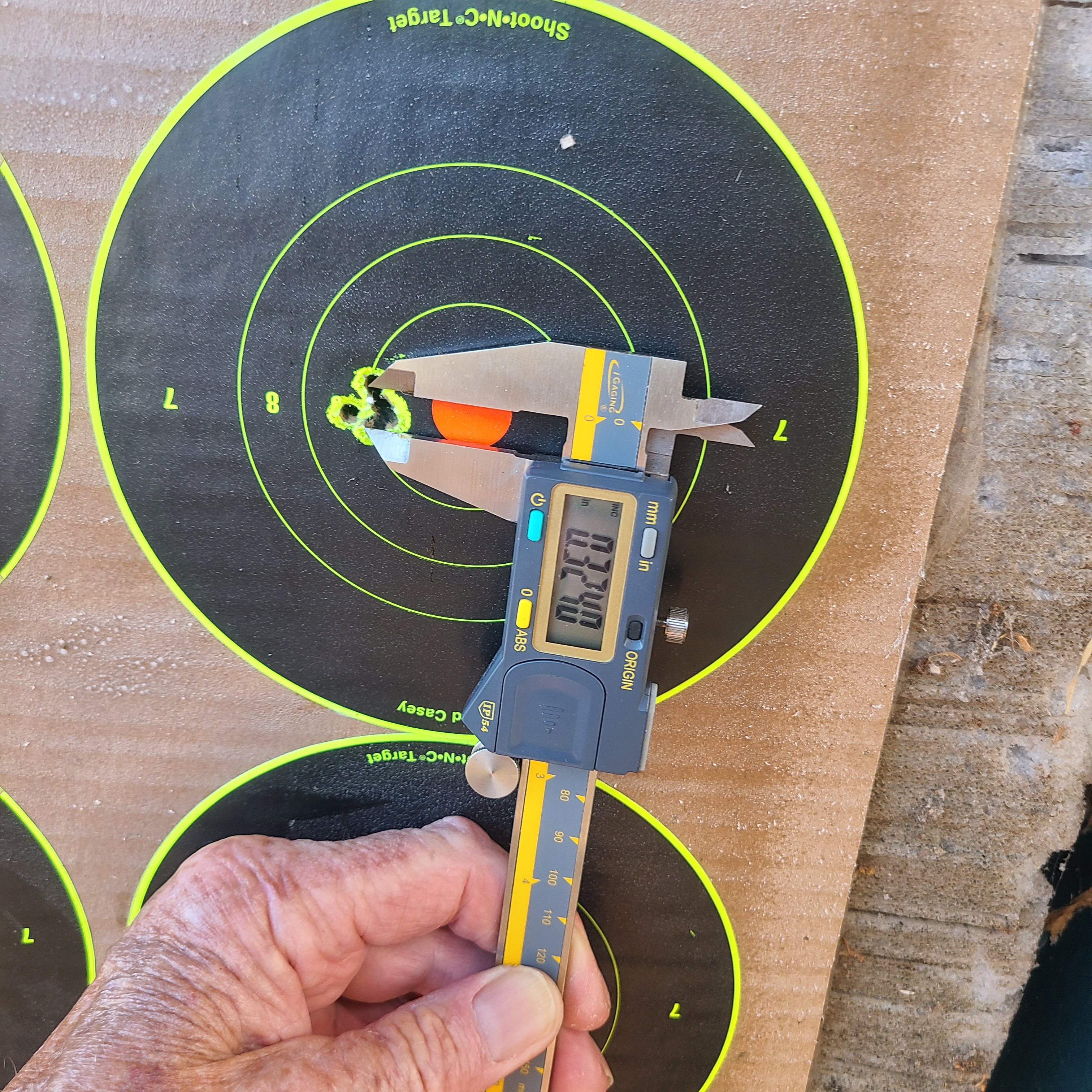

I really the performance I get out of the 29 grain Nelson slug out of my Crown mk2 600mm barrel, reg 155, H, 23 . Really good in the wind due to the high bc. Just under 60 ftlbs. Very constant and accurate. 6 shots at 57 yards , mag empty at that point.
