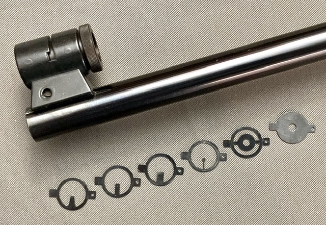

Older Anschutz sights, like this one, are made for 9mm rails (and have 18mm sleeve). Again I don't know much about newer models. As you can see, Anschutz made a great variety of inserts and again, there's a good range of accessories.

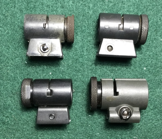

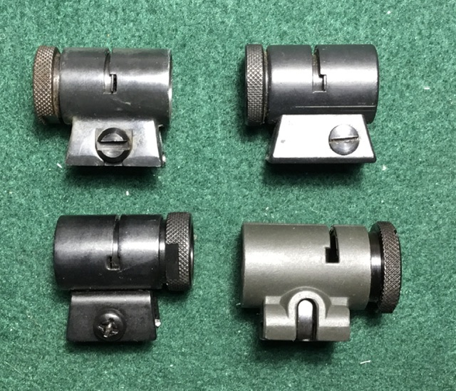

Here are four common vintage sights that use a more or less 9mm dovetail. Clockwise from top left:
+ Walther. Cast tunnel and base, wide-slot mounting screw head on the right, centered in the base. 17mm sleeve thread.
+ Weihrauch. Cast tunnel and base, narrow-slot mounting screw head on the right, in the front of the base. 17mm sleeve thread.
+ Anschutz. Cast metal tunnel and base, wide-slot mounting screw head on the right, centered in the base. NOTE, unlike the others it does not "squeeze" the base legs, but has a separate small steel "foot" on the left side. Makes it easy to mount and remove, and tolerant of small variations in the rail spacing. 18mm sleeve thread.
+ Diana. Thin steel tube tunnel, and stamped steel base. Phillips head mounting screw head on the left, centered in the base. 17mm sleeve thread.

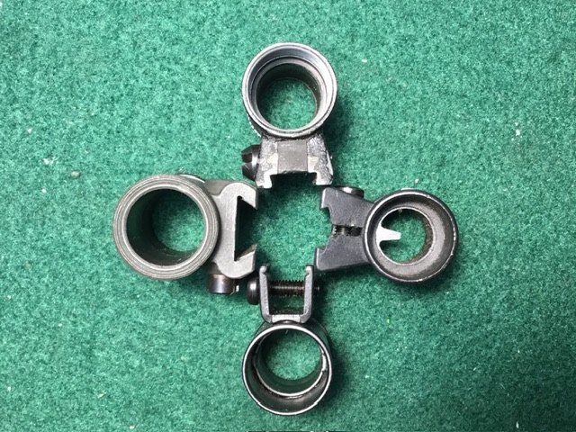

Viewed from the front. Clockwist from top Walther, Weihrauch, Diana, Anschutz. Note the little rubber block on the front of the Walther.

There are more elaborate versions of the Anschutz sight, some with a sleeve on both ends, others with a more elaborate base. But I think I'm correct in saying all the older models with 9mm rails have the 18mm sleeve. Sorry I don't know model numbers.
