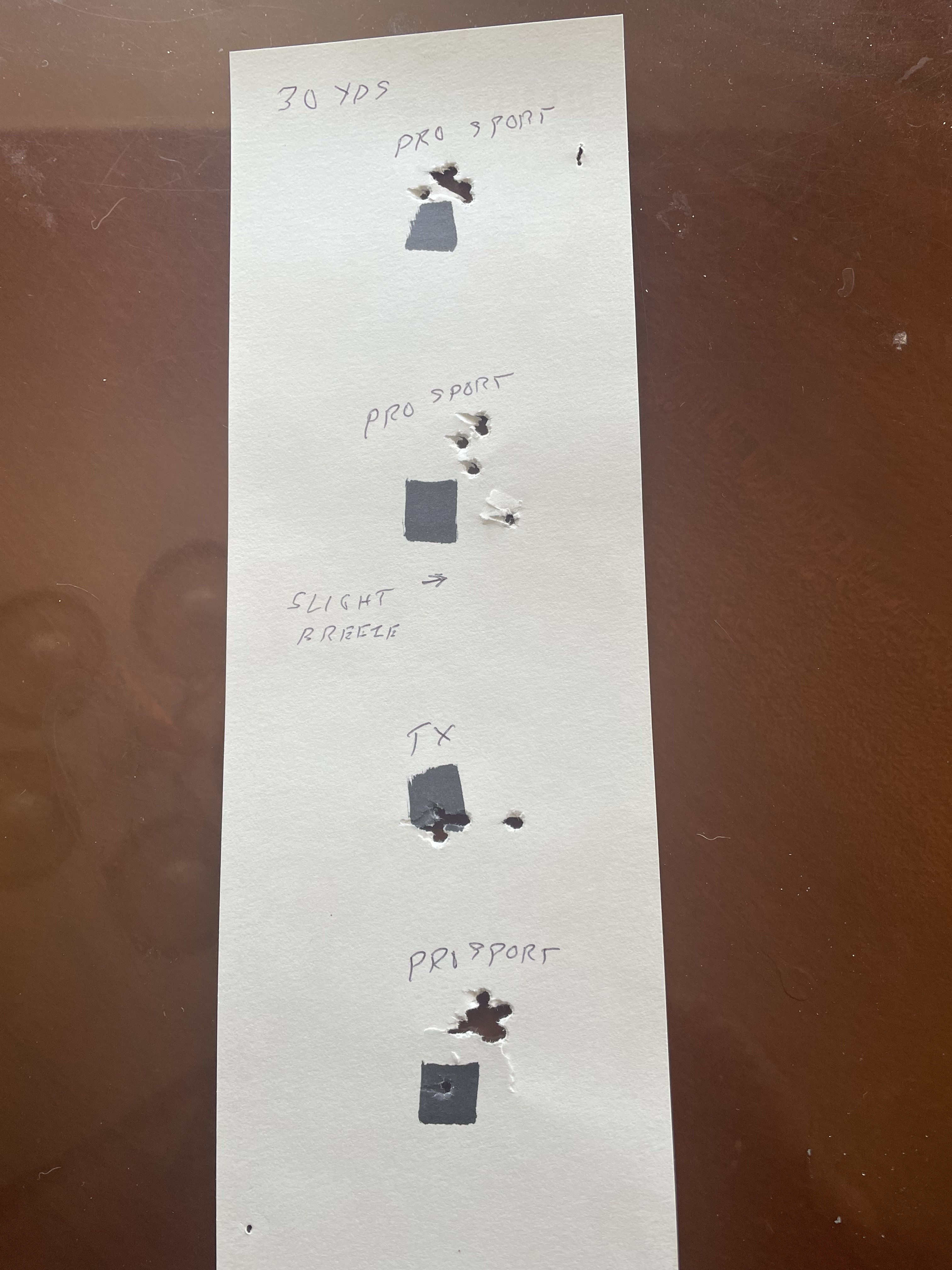

I also had a diana48 177 barrel from awhile ago and machined it to fit my pro sport so my pro sport is now 177cal instead of .22 cal.The barrel is 12" long compared to the 9" pro sport barrel and it shoots Wonderfull but a bit twangy work on that latter maybe another vortek pg4ho kit I do like the way they shoot. Steve!
