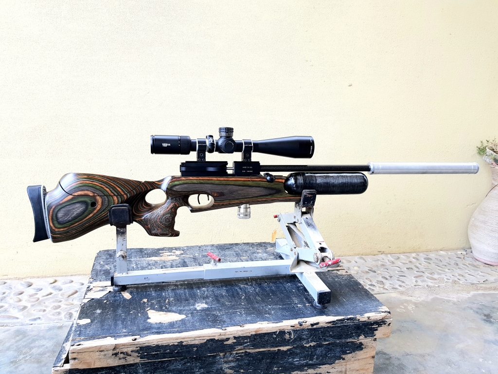

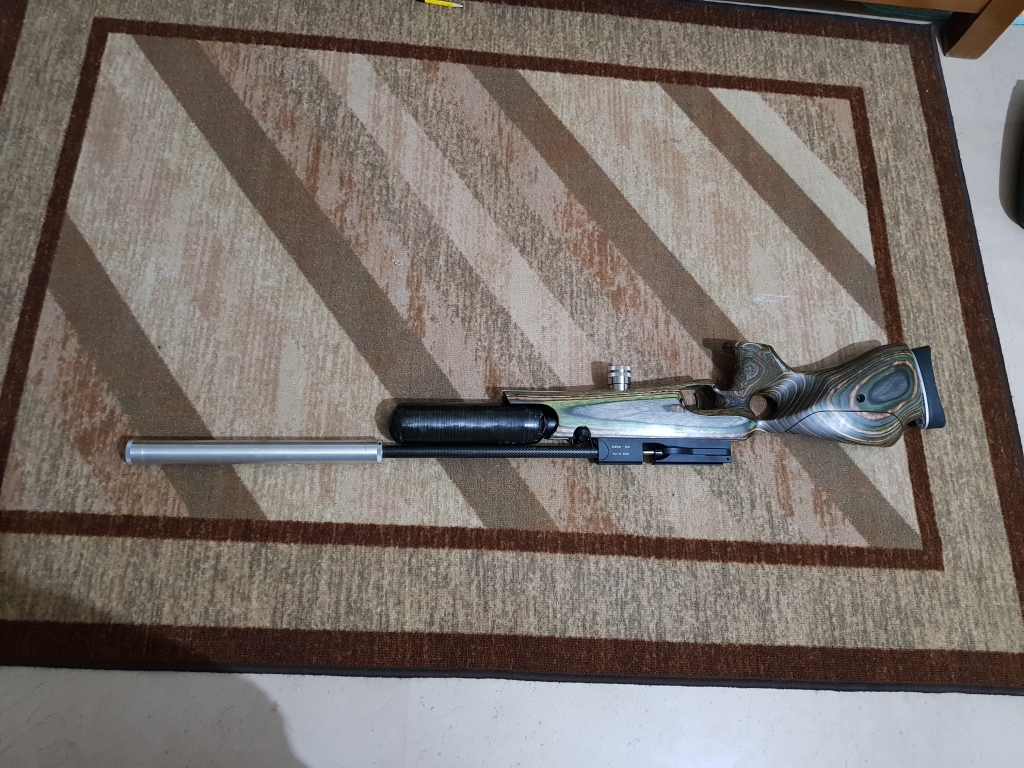

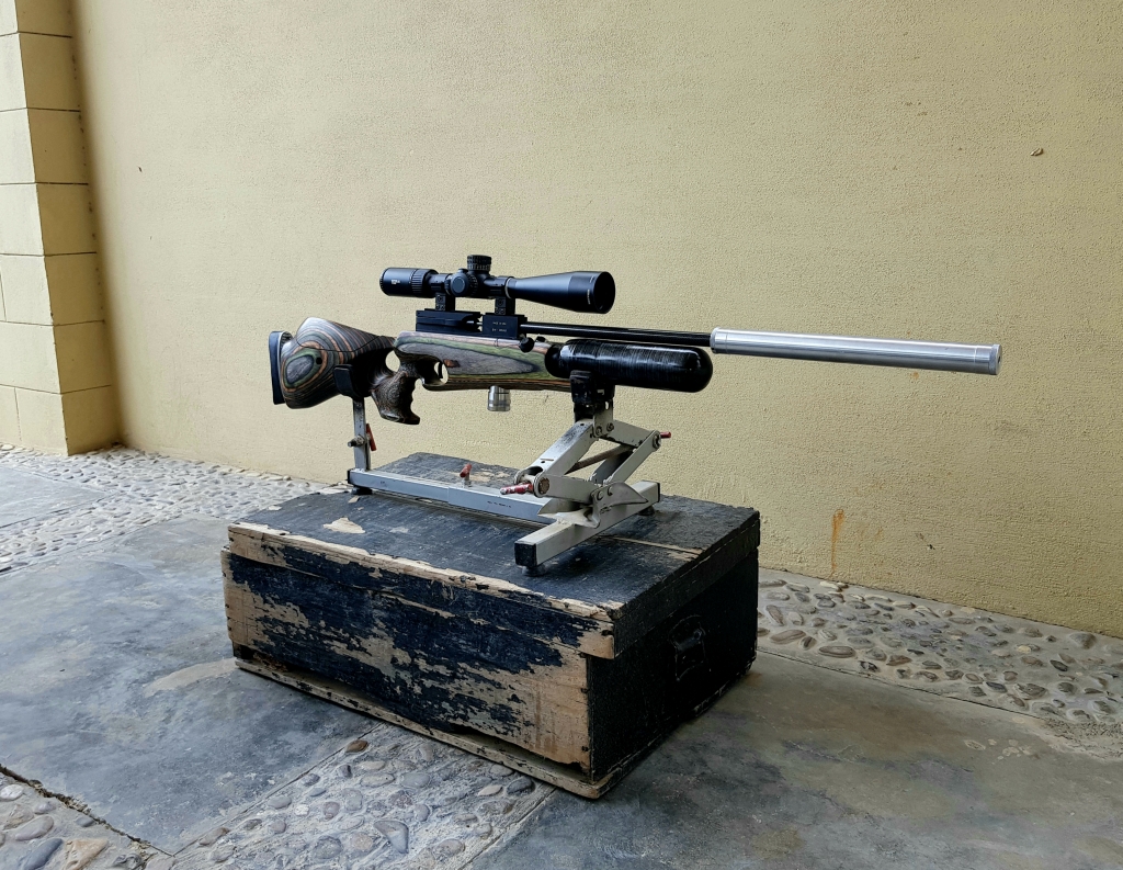

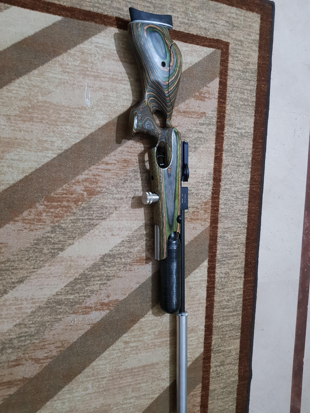

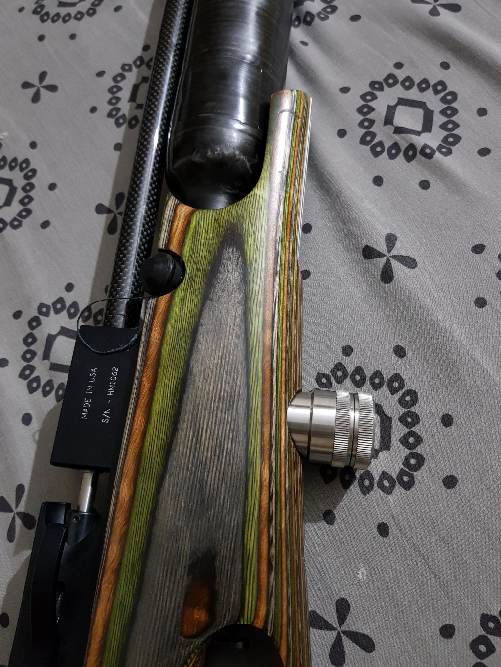

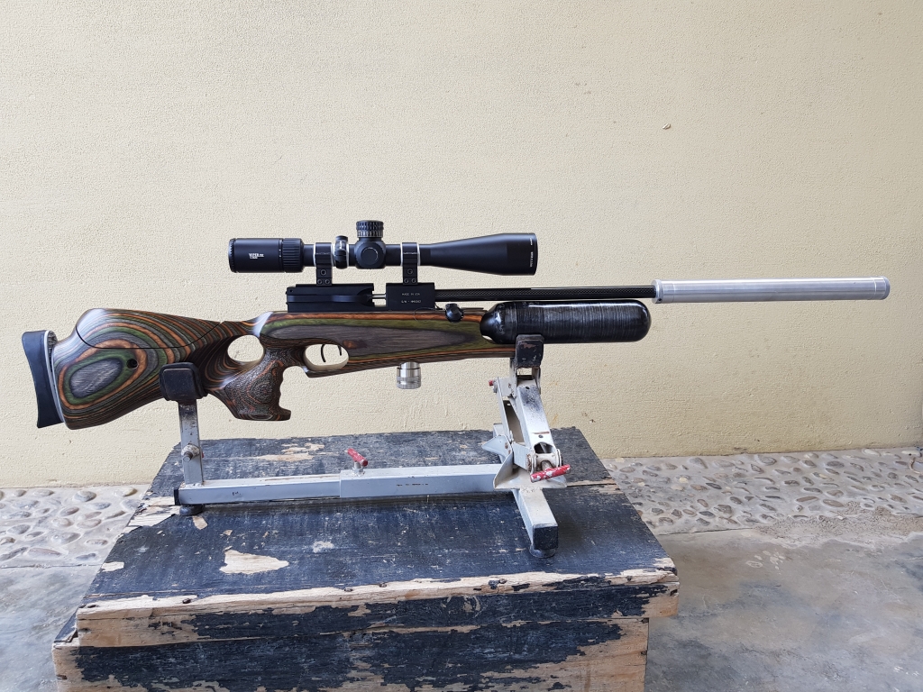

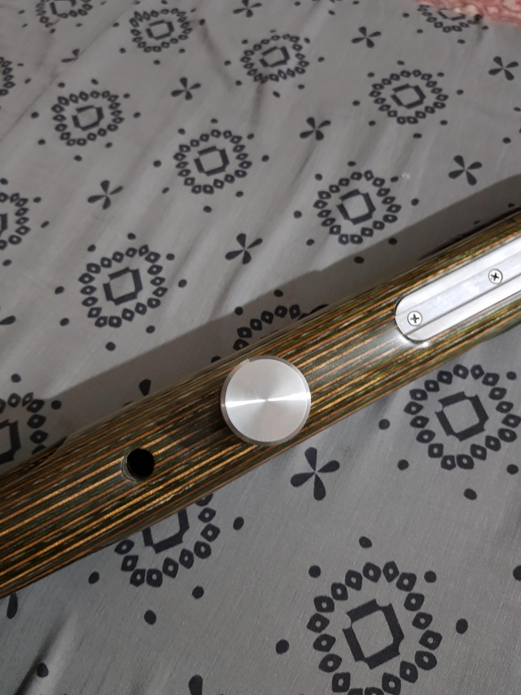

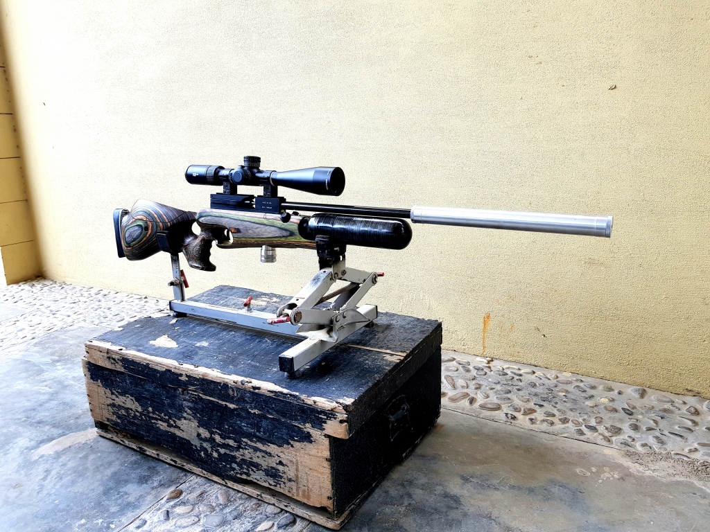

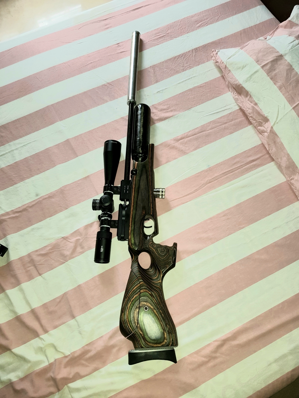

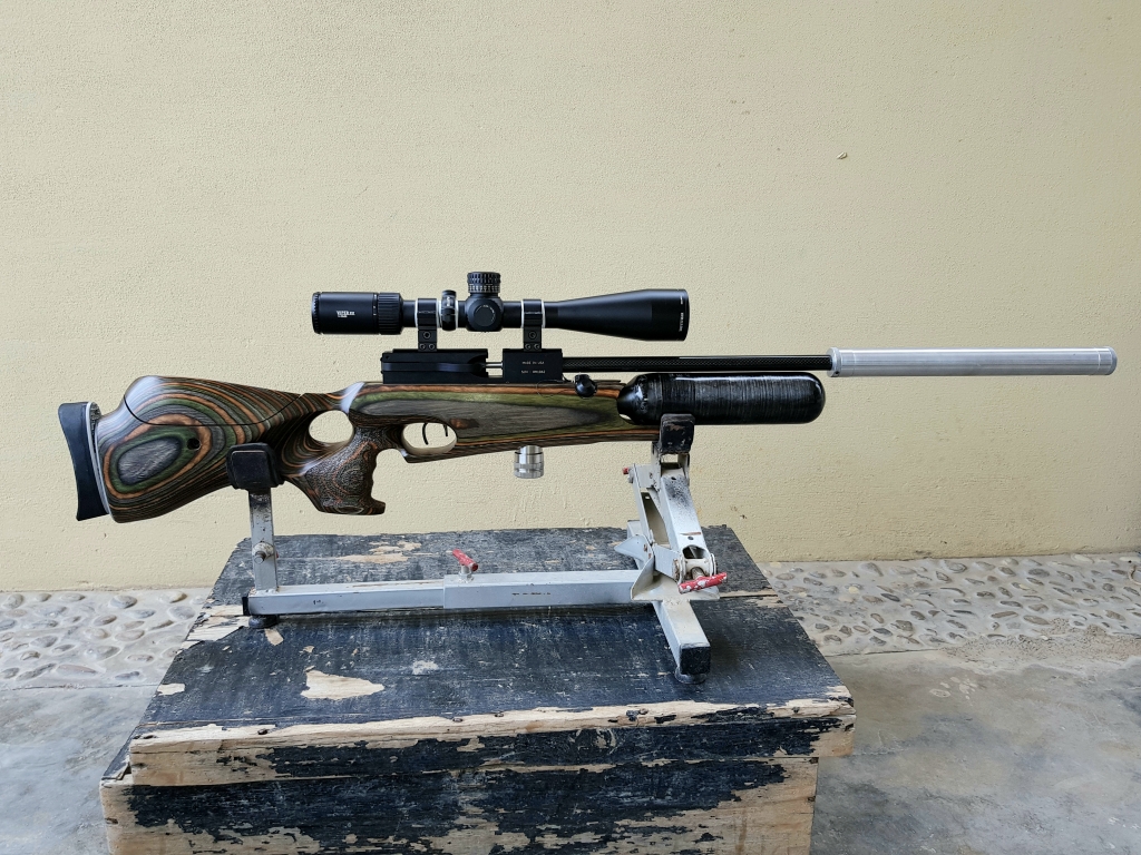

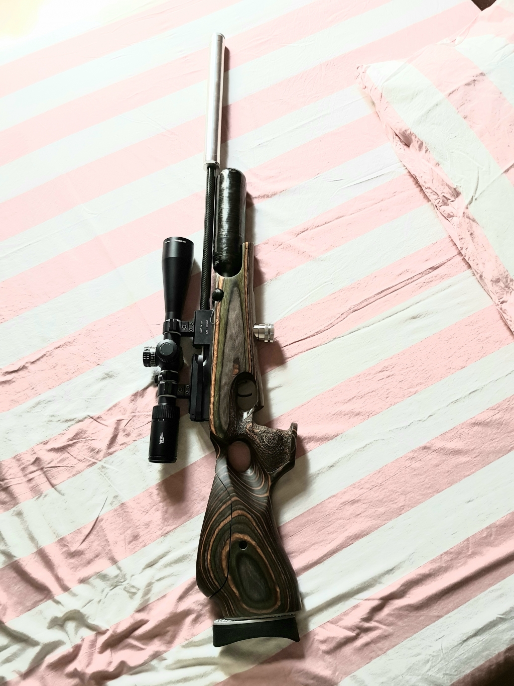

Finally the RAW HM1000X external plenum project completed
Today I got dine the remaining woodwork to install the plenum through the stock.
Here are some pics for your interest.

I don't think it's ugly at all. It's the only place it could go where it wouldn't interfere with functionality. You definitely improved the overall functionality/efficiency of the gun by increasing the plenum size. I think you were limited to location, and hiding 1/2 of the plenum inside of the stock was a great idea. I'm really interest to hear about your results pre and post plenum upgrade.
Thanks.

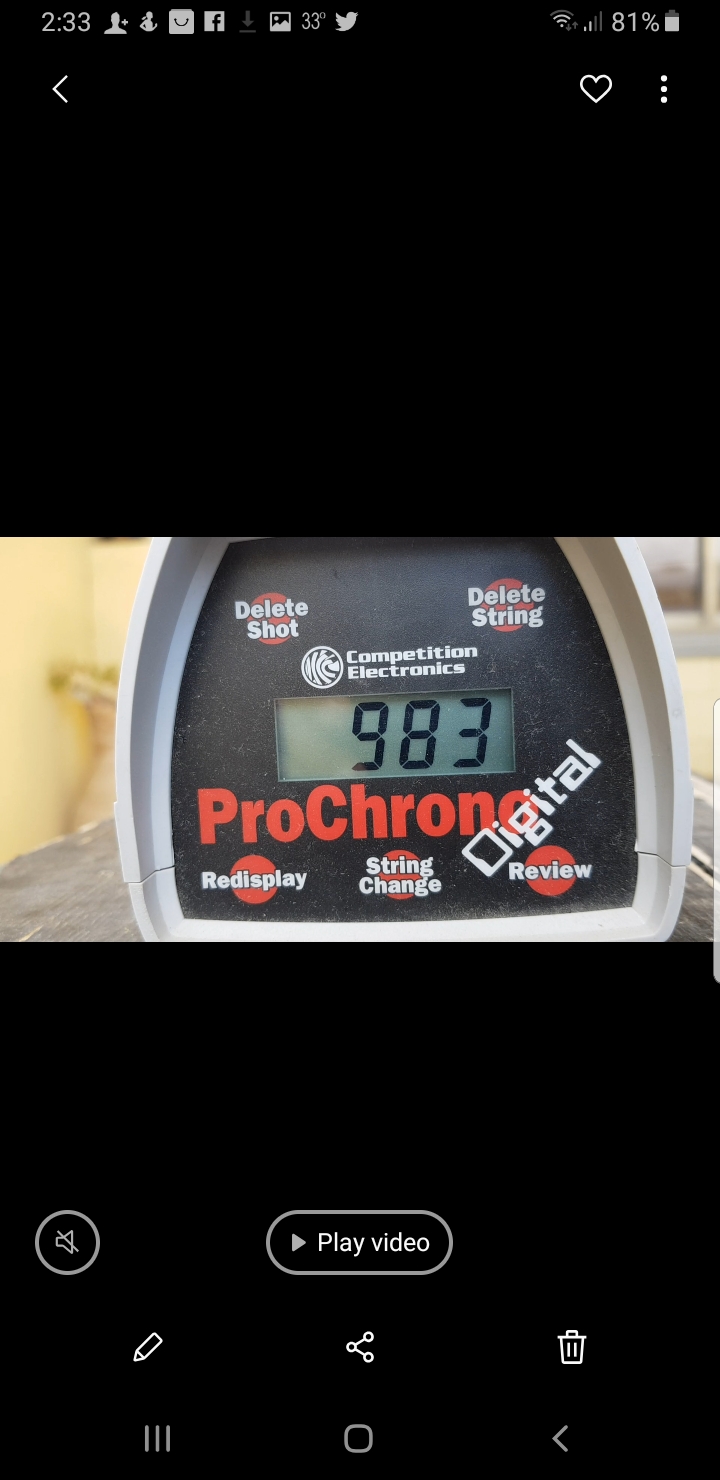

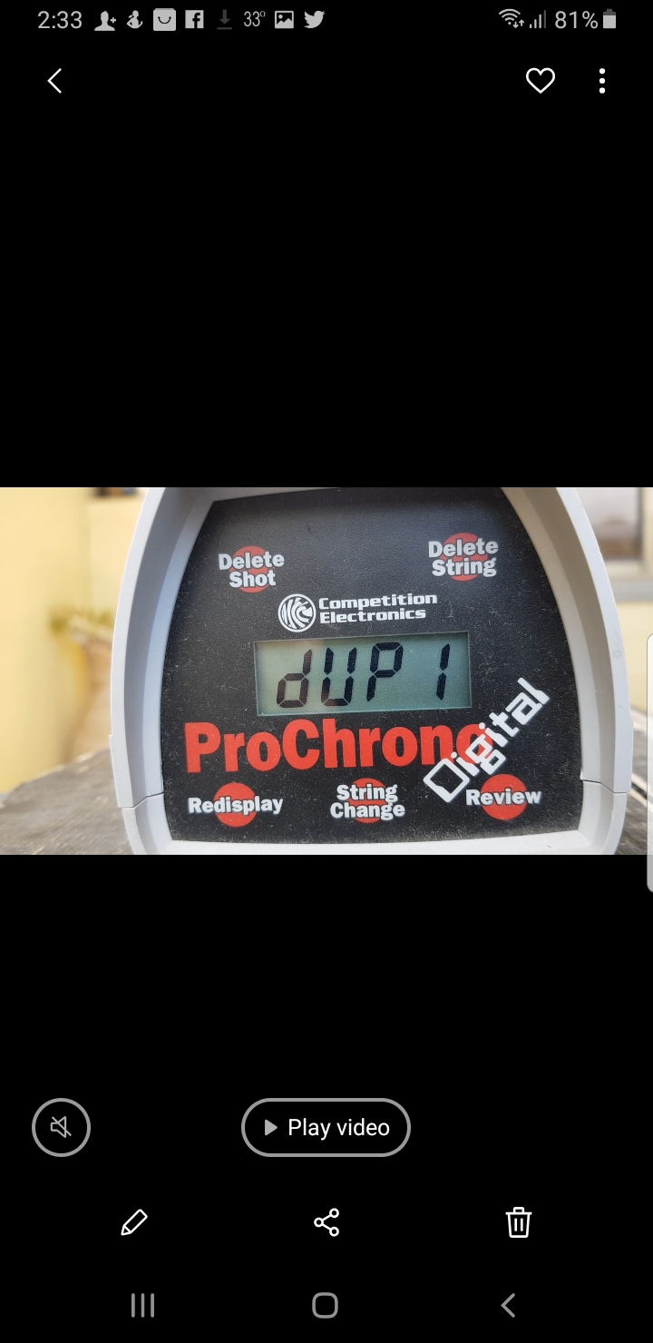

Before plenum it was doing 900 fps in .25 35 grain jsb and with plenum and without changing any adjustments, it jumped to 950 fps.
If I adjust HST the maximum I get 975 fps with same 34 grain jsb pellets at same reg pressure of 150 bars.
