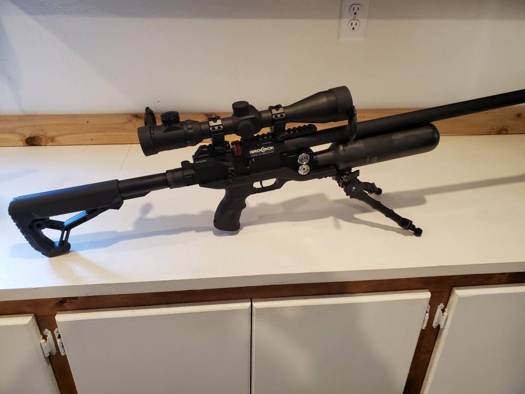

Now I'm curious. A pic would be appreciated.

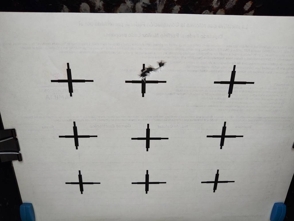

Here it is the guilty:
Friends of the forum, I anounce the birth of a monster:
The recrown process was an astonish success:

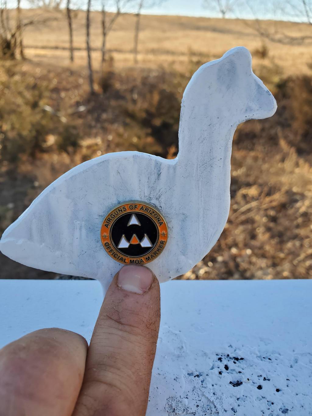

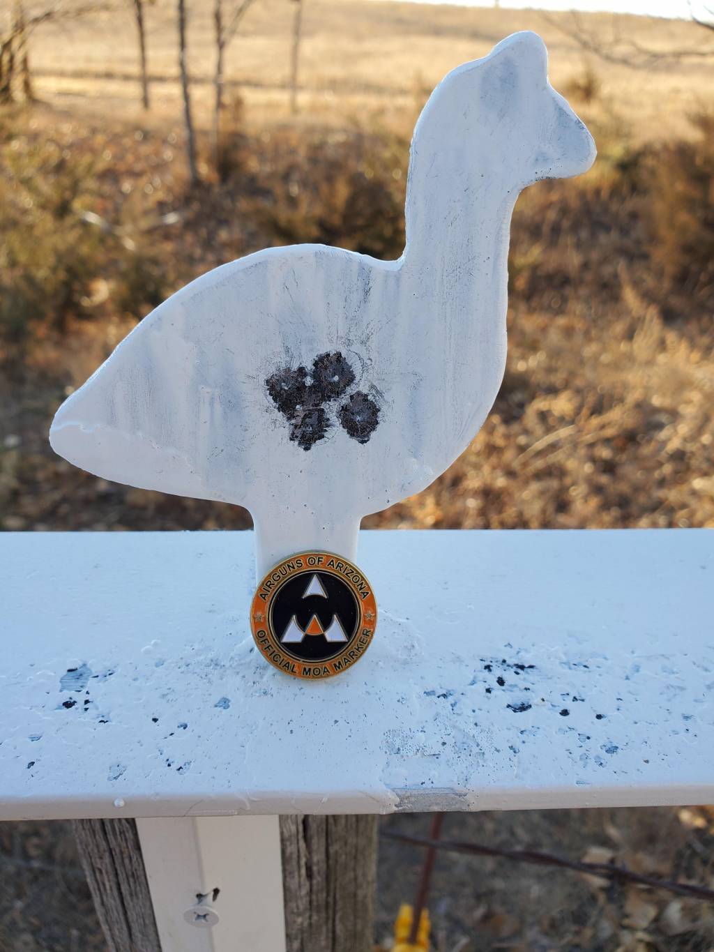

Now the Bantam can compete with and perhaps win at 100 yards to my must trustable rifle at that distance (Woverine HR HP ART Barrell).
Now the flight of the pellet is perfectly straight.

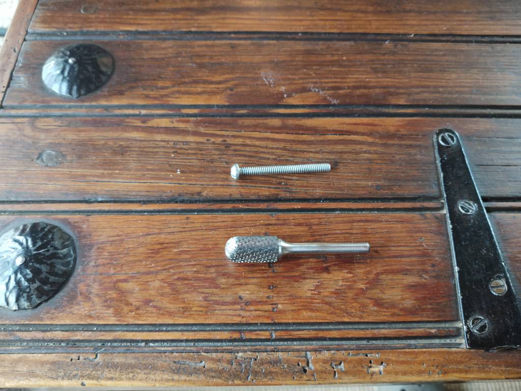

I used my drill first with a round head screw (did not like the result) and later on with an extrange tip that once I bought. See the pictures of both.
In order to avoid small pieces of metal going to the internals of the rifle I rested the rifle horizontal and when finished with the drill, I pointed to the floor and then shot two pellets to the grass in order that the pellet and the air could expulse any piece of metal that could had enter into the barrell.
Here the two partners of the drill fort the recrowning:
