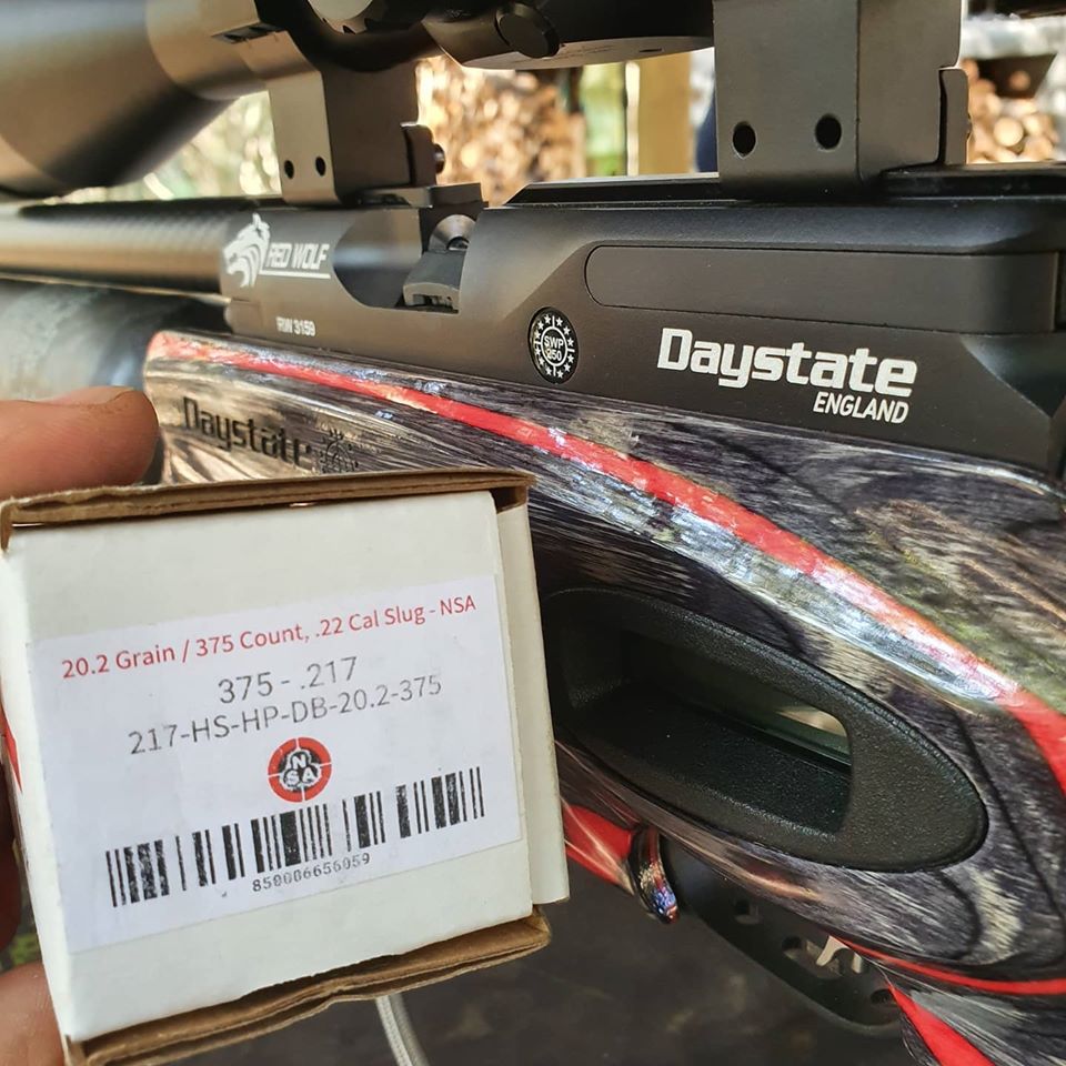

Start testing several NSA slugs (is what I have now) and it was totally true, the RW HP barrel I have does not like slugs much, until I start shooting the NSA 20.2 grains dish base
https://nielsenspecialtyammo.com/collections/22-caliber/products/20-2-grain-375-count-22-cal-slug-nsa
and to my surprise I manage to make several sub moa groups shooting in mid (my RW shoots the redesigned monster HIGH 1000fps MID 930fps LOW 870fps) shooting @ 980 fps:
I am new shooting the RW HP, and maybe this is not new at all for RW users, but for me I was kind of surprised! Anyone else with great experiences shooting slugs from the RW?
