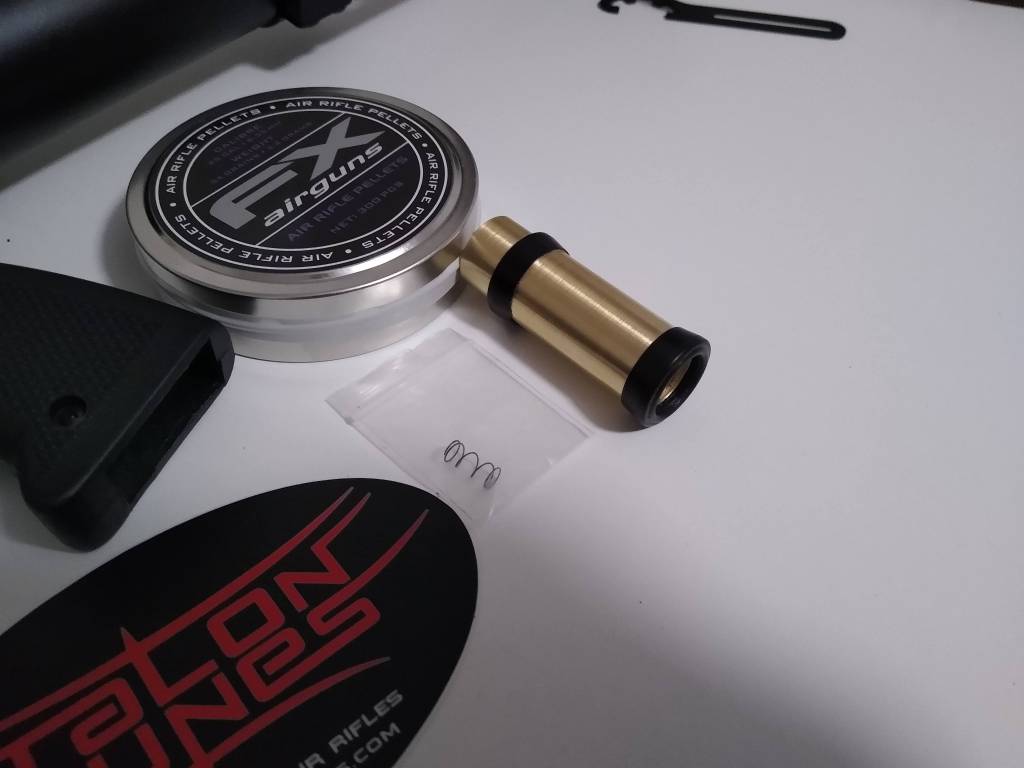

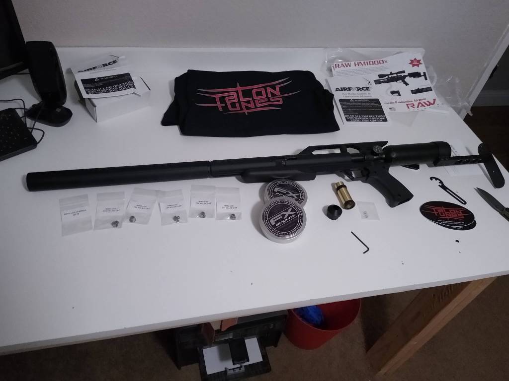

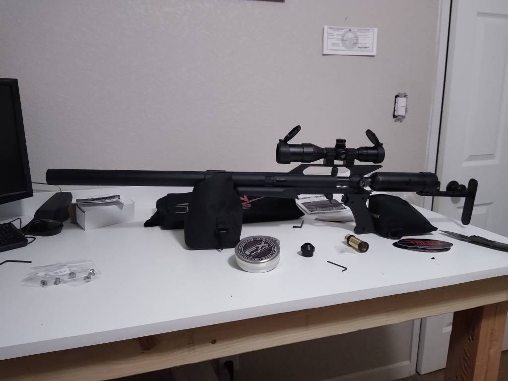

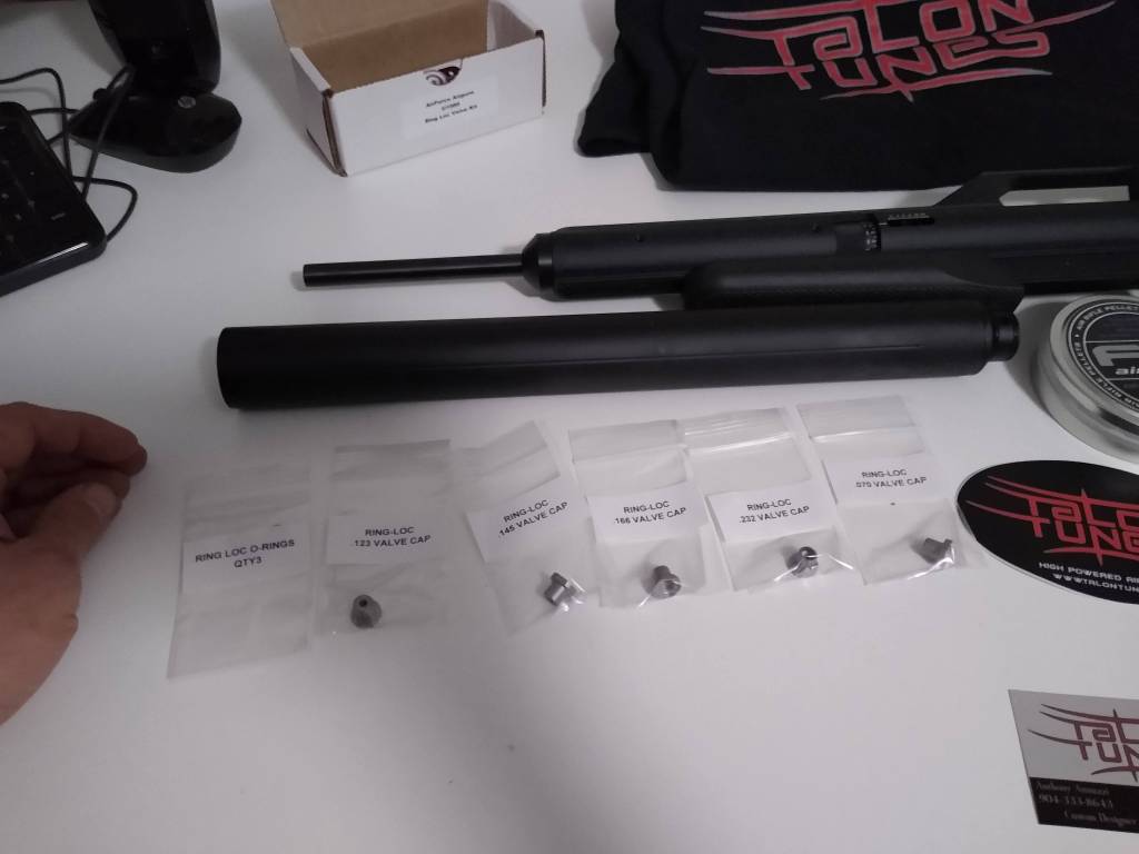

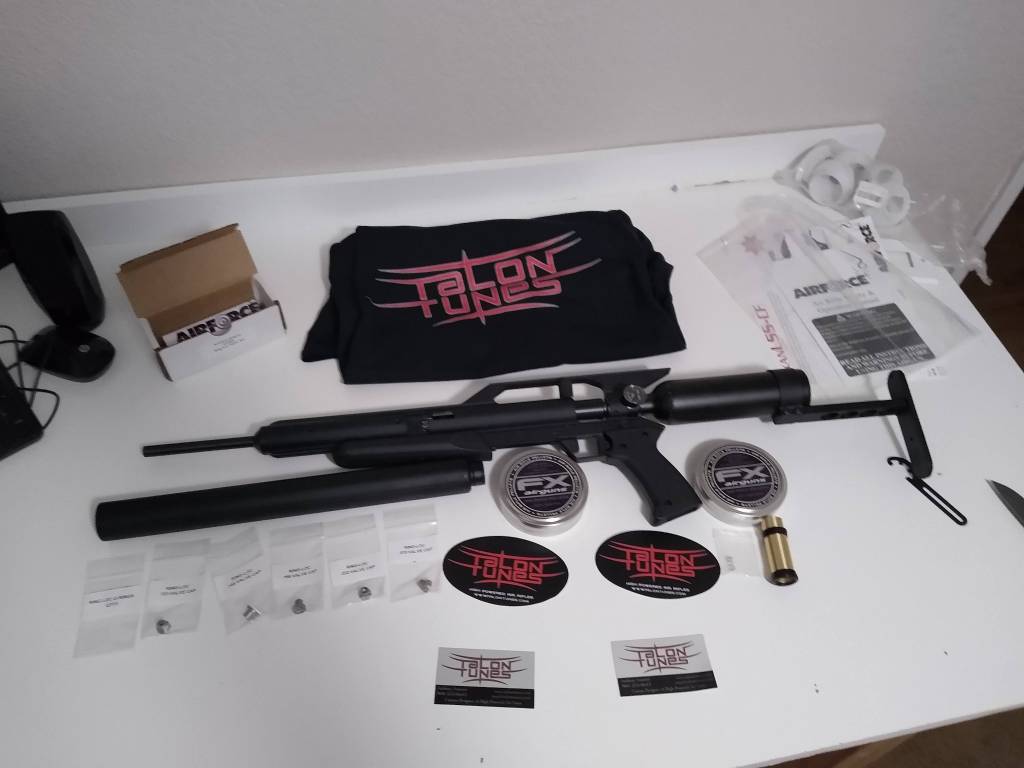

It always seems to take for ever from the time you hit that submit order button to the day it arrives. This is y first Semi High end rifle. I wanted something that was lite weight and lots of power. This rifle should fit the bill. Ive read that you can really get some power out of these with good accuracy. Hoping today to get a chance to air up and zero it in. This is the Airforce Escape UL with the spinloc valve. I also got the heavier hammer with slap mod, a TT trigger spring and a TT Condor 14" moderator. I wanted to keep with the lite weight so I got a UTG Bugbuster for it.
How are you liking it so far, and how do you like the TT moderator and hammer slap mod? I've been debating getting the same set up for a long time.
I love this rifle. The moderator seemed a bit big to me at first but it's pretty lite and makes the rifle stupid quite. All you hear is the sound of the action.
The hammer gives definitely more power but the slap mod doesn't make a giant difference but does make it a bit more quiet. .

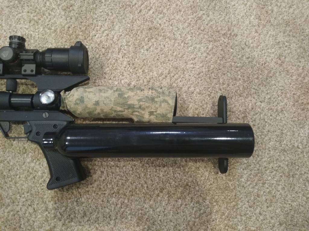

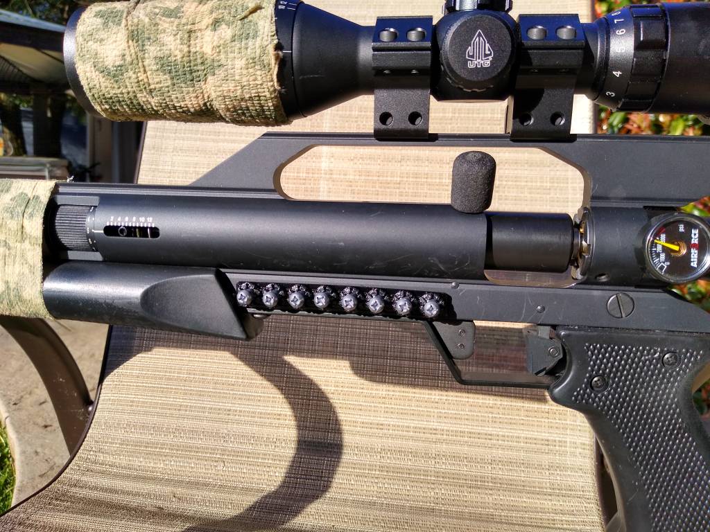

I just got a 380cc tank for it, I haven't gotten a chance to install it since I'm dialed in for turkey season I don't want to change anything yet. I also just made a ammo holder and it's so sweet.

Your ammo holder looks pretty sweet!!
I am planning on getting a 22 & 20 barrel for my escape, I like the fact its versatile and easy to swap. The moderator I have on mine adds 9" to my over all length but I it can fit a 20" long barrel under it so I might get the 22 & 20 in a 24" and have them cut down. The length seemed like a bit much at first but its not bad and the thing is so freaking silent now.

If you want one of those ammo holders send me a message with youre address and Ill send you a couple. Im working on a 22 size holder also so Ill send them after I get that one done since you have a 22.
