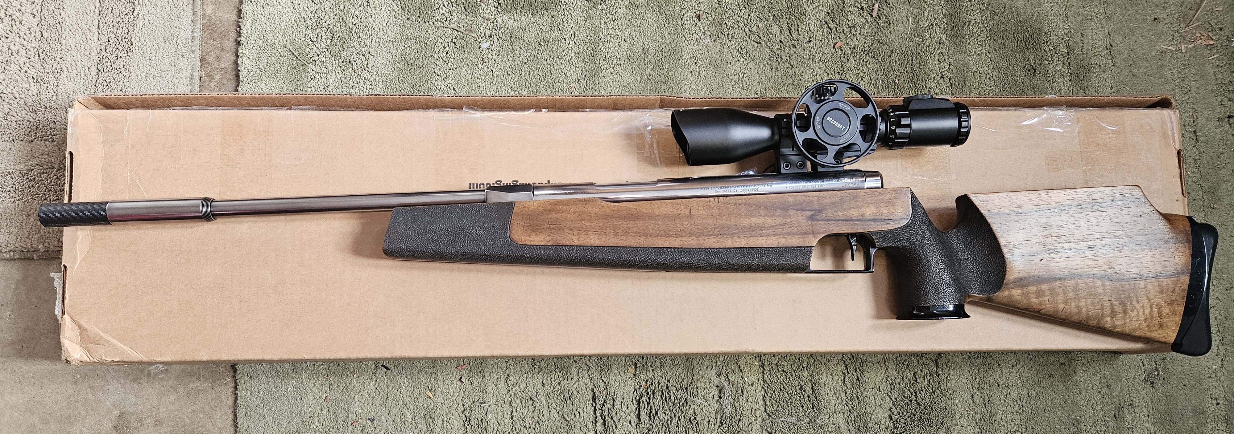

FWB Finally got around to scoping my FWB 150
My lefty 300S match. I paid David Slade to reseal & reblue. I did the stock.
I would like a super fine reticle short scope because it’s a great shooter.

Scoped leftys it is.
Remove the front sight and craft a removable barrel sleeve if you get ghosting from the front sight.

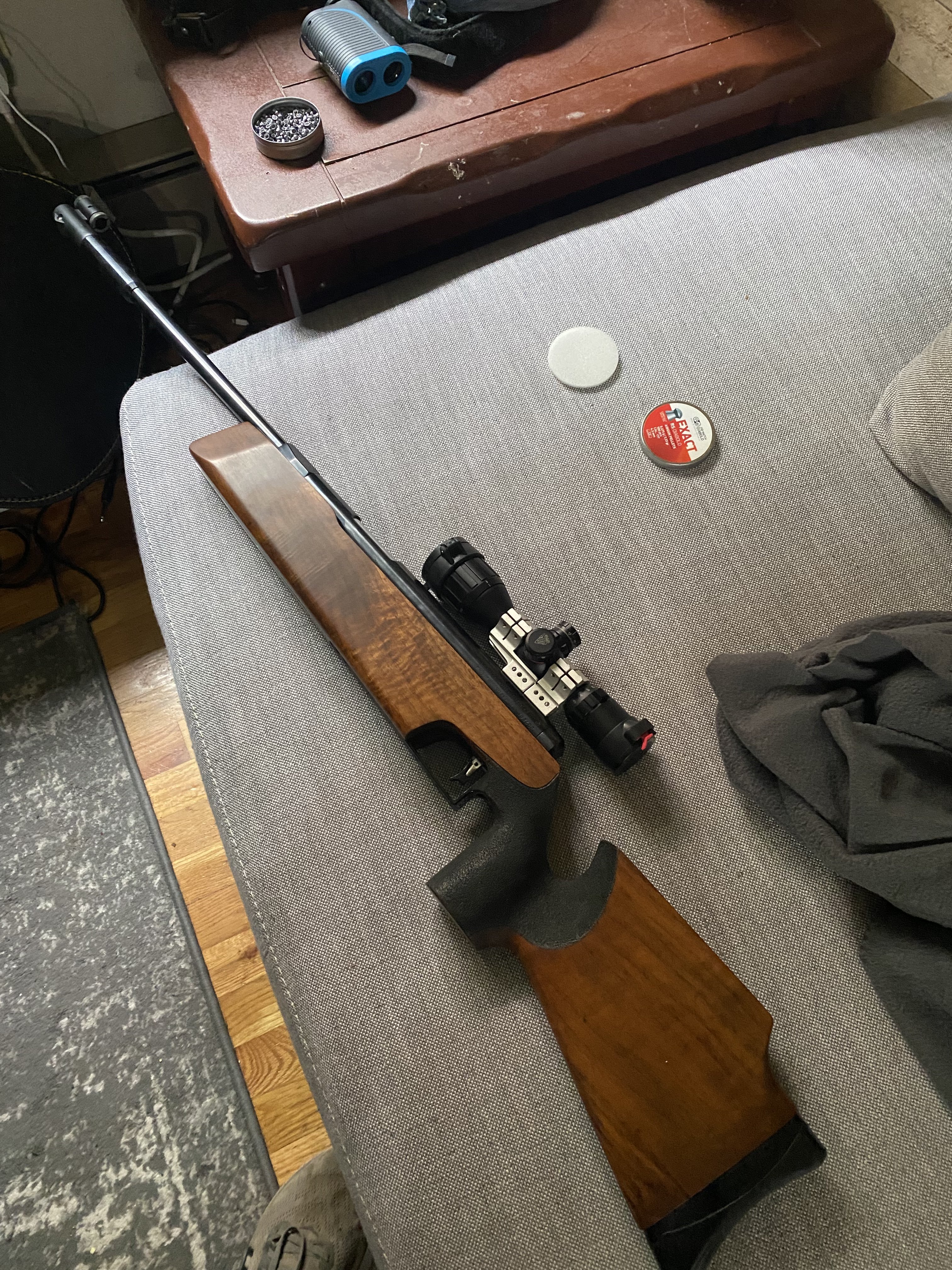

Bought this rifle from Pilkingtons when they liquidated a large lot of club rifles.
The metal work was worn and patinated, and not really wanting to send it off to be blued, I stripped it all bare and polished the entire thing. The stock got a good cleaning and poly treatment.
New seals, bearing ring, and Maccari Arctic spring, breathed new life into it. The rifle loves 10.3 JSBs.
All in, maybe $225 and several man hours.
Sell it? Not a chance...
