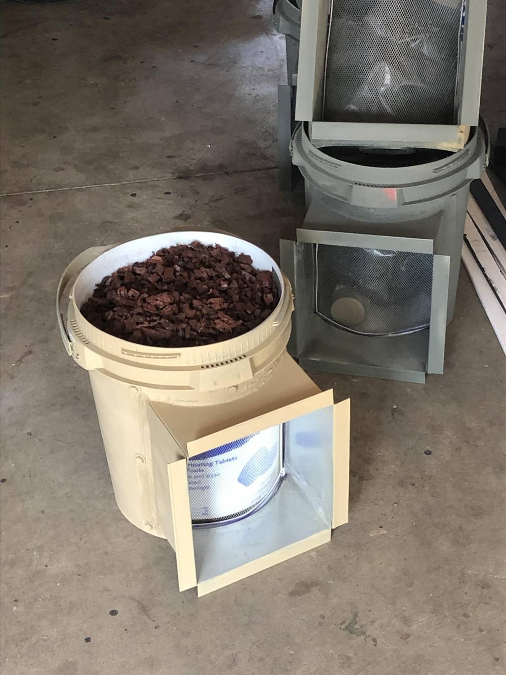

Nicely built.. Could you have not removed the side of the bucket and let the the pellets do the removal? Just asking...
If I understand your question, you’re asking if I could’ve just bolted on the sheet metal piece onto the bucket without cutting out that square opening, right? Then just shoot thru the target and into the bucket, correct?
if that is what you meant, here’s my reasoning-
ive seen what a pellet does to a plastic container. Not “soft plastic” like a protein powder container, but brittle plastic like what these buckets are made of. Yeah, these target bucket set ups will take a beating but the way I designed them with the wire mesh they’ll last longer. A pellet straight through the plastic will puncture and also crack the bucket. Before long, after probably 10 shots, then the bucket would have large enough hunks fall off as the cracks met up and I’d have mulch falling out of the sheet metal saddle then onto the ground. Bucket will need to be replaced.
The more you shot, the must the small pieces of plastic will exit through the wire mesh.
I can tell you that my traps have catch thousands of pellets without any kind of damage:
Emu, I don’t know if you read my thread from the beginning, but I made mention that the steel mesh is meant to be replaced. It’ll take a lot of shots before the time comes, especially at the distances I’ll be using these at from 60 to 100 yards.
Where I live, I do have the room to formally set up target structures like one would see in a professional range, but wifey would put the skids to that. So, in my initial think tank moment, number one it had to be easily portable, which it is, #2 quiet, which it is, #3 great for outdoors, which it is, and lastly at #4 is be able to withstand the energy of 30 cal slugs or pellets at those distances and be able to contain the lead, which it will.
I do want to give kudos to INTENSEATY22, as it was him who gave me the rubber mulch media idea. I just had to come up with a method of containing it, and making target attachment a piece of cake.

since putting this prototype together I’ve already come up with a method of containing the mulch better by using a backer behind the screen, and a quicker way to attach the sheet metal fitting faster than drilling and bolting up.
the screen and the backer are considered replacement items, and I’m sure after a thousand shots and a couple of years left out in the sun, the entire assembly will need replacing. I’ve got to hit up some buddies of mine who supervise my local area sheet metal shops to have more taps made. I’m thinking at least 18ga with welded seams for the tap to last longer

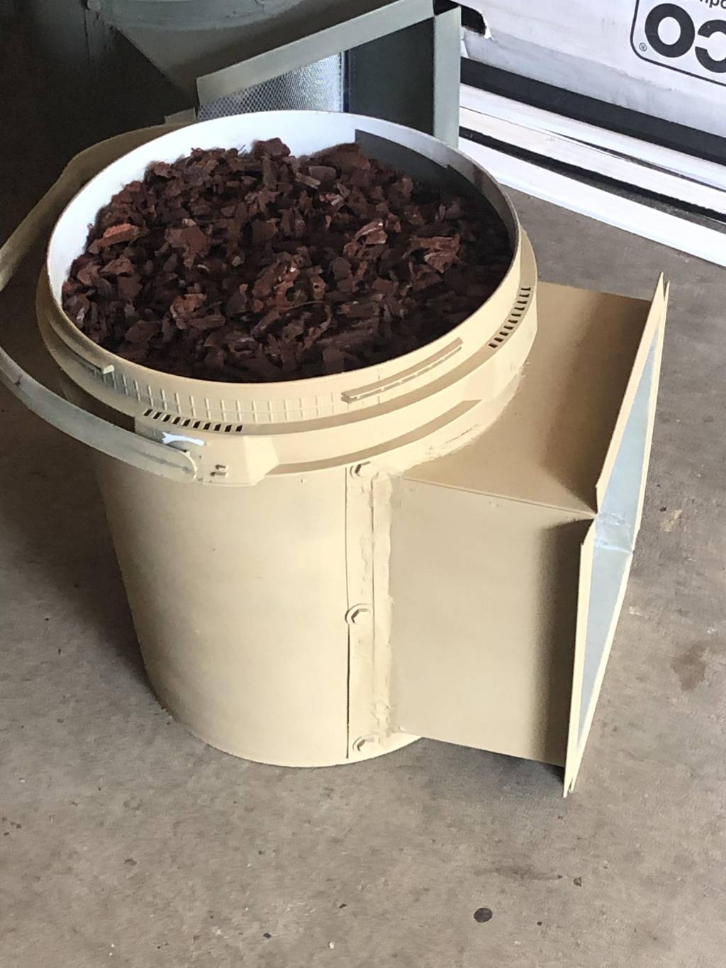

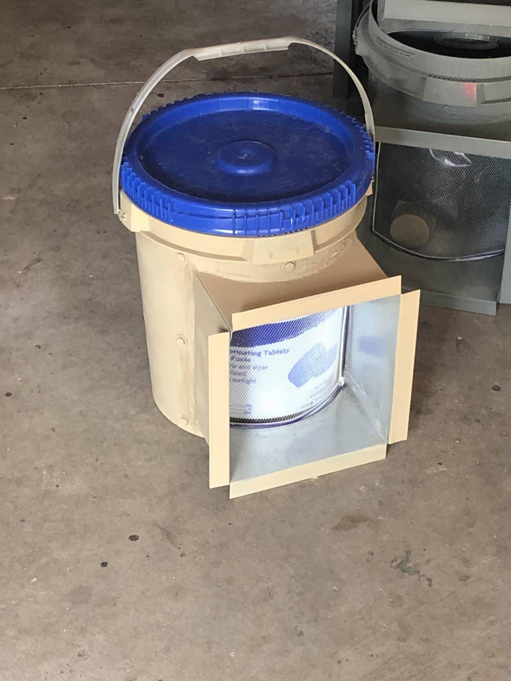

Finally got the sheet metal taps soldered, all buckets primered, and had one can of marsh grass colored spray paint to finish one off. I have four more cans coming to finish the rest, and if I have extra, I’ll paint the lids, also.
one bag of mulch compressed fits perfectly in a bucket. I threw in the square part of the bucket I cut out and slipped it behind the screen just because, ha ha.
some pics of completion-
